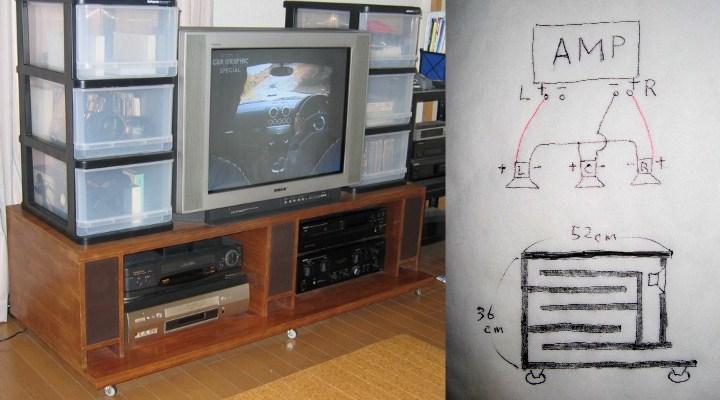

I made low board with speakers with FOSTEX FE87.
The cabinet is 3-meters zigzag tube.
The way of conection is 3-channels front matrix.
Flat range is 50Hz-18kHz with the long tube.
Of course there are many peaks and dips, and the sound isn't high speed one. But it's enough for TV.

Do the speaker magnets have any effect on the TV?
Did you test it first?

Thank you ,everyone.
Dhaensan, FOSTEX FE87 has a repulsion magnet.
So it doesn't effect at all for TV set.
Now FE87 is updated to FE87E.
The material and shape of cone are improved.
I have to say one thing important.
If you try 3-channels front matrix ,
please use normal unbalance output AMP.
Do not use balance output type like SANSUI's one.
