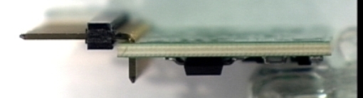

Heres a solution of mine for PPI amps. Lots of work but worth it in the end run...I will have these in quantity shortly. PM me if you have questions or needs
justonemoreamp:
Where did you find connectors to fit the tiny holes in the main board? I started to do this but not being able to find a connector put an end to it.
I also found that someone else was selling repalcement boards so that made it less interesting.
Do you have a price on them yet?
Perry Babin said:justonemoreamp:
Morning Perry,
This is a beta unit, its built on some very exotic 20 gig rated board material. I am currently getting bulk pricing for the boards from several different suppliers both here and offshore, so a per unit price has not been set.
But its in the works, and PPI owners will now have a source to keep their beloved Art, PC, and PCX series amps running forever now.
Currently we have standard spaced gold pins that will right angle mount front or back to the card so as to permit offsetting the card to accommodate the many main board layouts PPI used over the years. Please see attachment, pins are reversible for mounting differences.
I also have pin arrays that slip on and can be soldered with thru hole connections from front to back < these pins are exact matches for the original PPI pins.
I found a batch of 30,000 pieces at a shop local to me here in Silicon Valley.
As soon as board pricing has been setup I can talk cost numbers,,,,,
