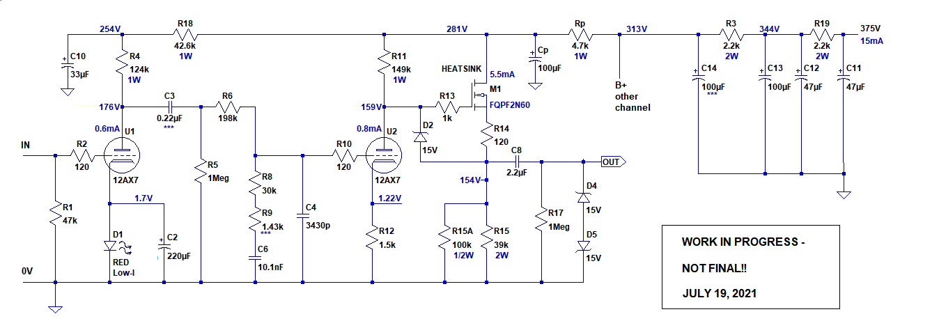

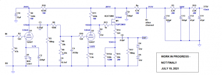

Here is the schematic of the preamp in its current state (attached image).
I'm contemplating changing...
1) C2 from 220uF to 1000uF
2) R2 from 120R to larger value? Or don't change it?
3) R10 from 120R to 1k
4) twisted pair wiring to input; replace with shielded coax
5) add ferrite beads to input wiring
6) add push-on tube shields (if I can find them...)
Anything else I should do?
Thanks again for your inputs!

Thanks Salas, but my question is about the value of capacitance to use bypassing the LED.
I have the red LED bypassed with 220uF.
Will increasing that bypass cap to 1000uF make a substantial improvement? Or only a technical improvement that is not discernible by ear?
It will clean up the lower bass further. 220uF has 36Ω at 20Hz when 1000uF has 8Ω. I don't know if you will discern it, depends on speakers size and arm resonances too.

C2 is also able to offer you a high pass filter removing subsonic , so bettrer keep it lower in value to get rid of frequencies below 10 hz!
One of the last things the late DF96 did on this forum was trying to explain that a small inductance doesn't matter for a grid stopper. I didn't understand that at first, but I guess it's because a large enough grid stopper will get rid of any negative resistance and make the circuit stable for any passive source impedance. If he was right, then you can just as well use any other type of resistor as a grid stopper.
I think DF69 had some RF knowledge on this too (reading his posts for a different reason). Simply put, given the signal and the purpose I got the impression that people were over concerned with the small inductance of metal film axial etched resistors (ie making a small inductor) vs the benefit of having the resistance in the grid to utilise the miller capacitance as a LPF. The AF valves having enough internal capacitances to really make any resistor inductance irrelevant for the frequency range (actually adding capacitance may help). Getting the stopper as close to the pin as possible (even using a SMD part) is probably more of a concern.
If Luxman cl34 is using 3k3(phono input) and 22k + the series resistors made from 100k + 200k potentiometers as grid stoppers for line input , so can you...Removing RF noise today is more useful than trying to have -140db noise on a phono preamp...
I believe I'm coming around to thinking that.
The combination of 3.3k ohms in series with 200pF (the approximate Miller C of a fully bypassed 12AX7) gives F3 = 240kHz. That's probably high enough not to make any discernible difference in audio response at 20kHz.
Since 1k ohms series with 200pF gives F3 = 800kHz, I suppose that would have zero effect on the audio frequency range, and wouldn't filter out high frequency noise from switching power supplies either.
Once again, it's a compromise between this and that. Perhaps 3.3k is a good choice for R2.

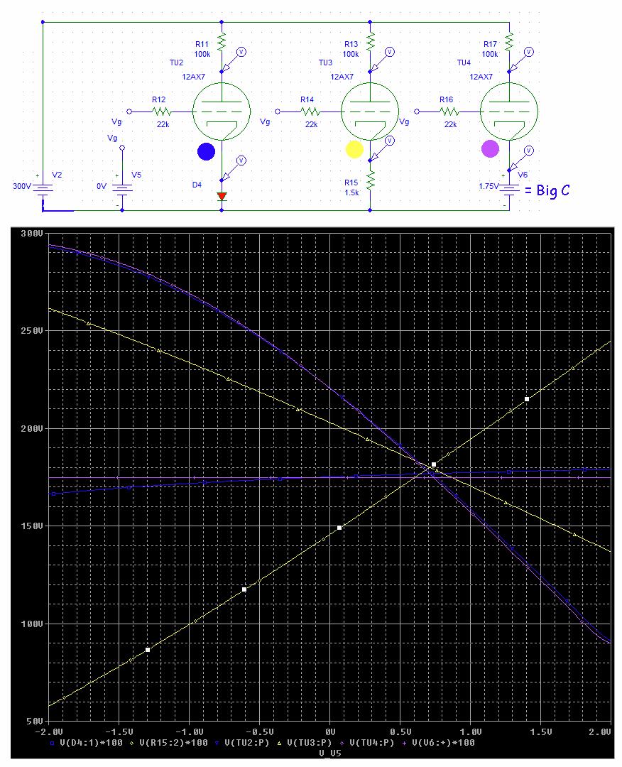

Well... There is the question of impedance and PSRR. With a small value C across the cathode bias LED, impedance at the cathode would spike up at the extreme low end, leaving PSRR diminished at those subsonic frequencies. While the audio response would be attenuated down there, a power supply or tonearm/cartridge resonance down there could get excited (which I think was Salas' point).
Another case of a compromise between this and that?
This one?
This one?
This one? (which is about unbypassed cathode resistor for bias)
Sorry, I'm not following you. Please clarify. Much appreciated.
EDIT TO ADD:
I prefer unbypassed cathode resistor too. But that's not a good plan for the input stage of a phono preamp where linearity is not the issue, but gain with low noise is. Therefore, the 'contest' is between a cathode resistor fully capacitor bypassed, or an LED (with capacitor bypass to filter residual noise).
LED's will get you better S/N ratio, higher gain and higher distortion figures as the valves biased that way will saturate easily, no resistor-no feedback...I usually go with a combination of resistor//capacitor+resistor or resistor + led to get some feedback.
This one?
Led's are totally favoured in low noise preamps, but they are pretty useless in power amplifiers as you need to controll the distortion figures locally , more than you could do with a global feedback using the higher amplification given by the LED low dynamic resistance .The schamatic run in a symulator could tell us more about the LED +global NFB vs Resistor .+ local NFB
You're right PRR! I used all the bias combinations in the past and always found the resistor better than anything else , allthough you have to deal with the lower gain .The resistor is adding some noise, but the distortion reducing mechanism it allows will give lower thd+N when working.
EDIT TO ADD:
There's no contradiction unless taken out of context.You can use LED's if you apply global feedback which you clearly don't in a pasive riaa configuration.That picture is not mine... Difference is that you can clearly hear the distortions in a phono preamp when using led biaing with D3a at a gain of 77.ECC83 has an even higher gain of 100.never tried biasing ecc83 with LED but there should be the same effect.I doubt you need LED bias witha properly deigned passive riaa with ecc83.i built one once and i remember using imple R or RC elf bias.If you're uing RC cathode bypass witha very big capacitor there's a very big chance you get the same respone as a simple LED.When I told you to make the C smaller i didn't see it's paralleleled to an LED.LED's might need just 100nf for bypass to lower the noise , they have a very low dynamic resistance at all audio frequencies anyway so they don't need any electrolitic capacitors around.
