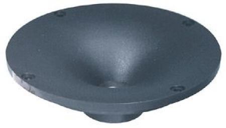

I went ahead and ordered a pair of the 2408H-2- as it so happens, I have a number of screw on waveguides, including the JBL progressives referenced here, and 12" psuedo OSWG (a little more flare towards the mouth) and the big 15" OSWG I did. If a narrow pattern is acceptable, the selenium HM17-25 would likely be a great match- not great below 2khz but very nice CD performance above.

I haven't done measures sorry. The 17-25 is 60x40 and doesn't load low but it's a good 60x40
I still think the combo of JBL 2408H-1 plus a PT waveguide or one of it's clones is pretty darn special. This performance is very good; note how the shape of the response doesn't change as you move around, it just gets quieter as you get off-axis. Very nice if you're setting up a system like Geddes recommends, with the loudspeakers cross-fired.

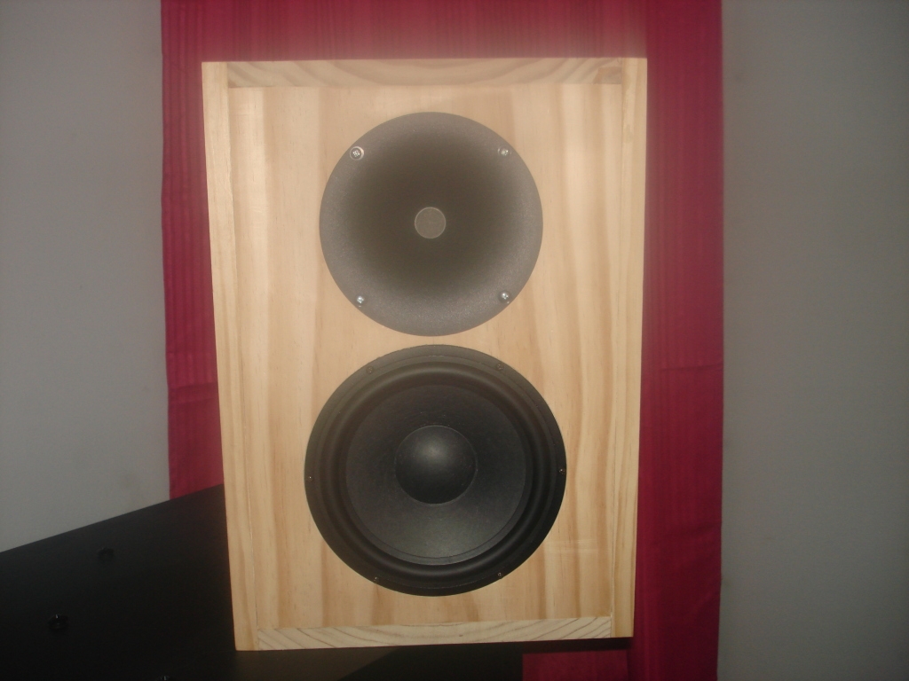

I had a 2408 and 2407 (same horn, same box, same 2khz 24db slope, same woofer).
To my ears, the 2407 (I wouldn't pay over $100) was better.
Never measured them.
2408 seemed to irritate me, couldn't seem to nail down why though.
Still have a single 2407 sitting in a closet with the gorgeous round horn (the mcm 54-580 or the wave core one I think people use with dome tweeters nowadays). Still have 2 of those I think.

@norman bates, what woofer did you use in your two way. Designing a 2 way with ring radiator soft dome (xt25) with a similar 6" waveguide wg148
