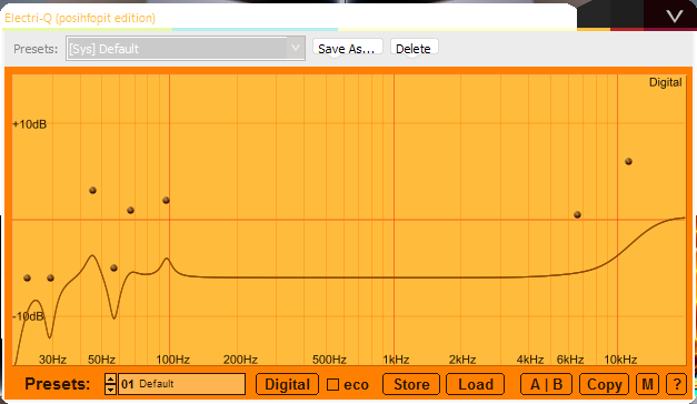

I should add, that this EQ has two working modes - "digital" that doesn't add nonlinear distortion and "analog" that emulates real analog equipment and adds some amounts of harmonic distortion (2. harmonic IIRC). This is nice for studio works but as a room/speakers correction digital mode would be preferred for maximum fidelity.
I also suggest not to go over 0 dB line, because if you do and play some 0 dBFS signal, you get distortion (digital clipping). Use allpass, or better yet, butterworth highpass as a rumble filter, and reduce it in level appropriately to bring the highest peak in the curve down to 0 dB.
And yes, the presets system IS strange and can be even frustrating at times.
Here's my room correction (below 100 Hz) and horn (above 7 kHz) correction EQ curve, just for show-off:

Please continue to show off.

@technofreack: i'm curios at what your window controls looks like, is it a particular VST host or just a replacer for the windows theme?
Just a windows theme. I don't like this XP default "plastic" GUI and classic theme bored me out too.
