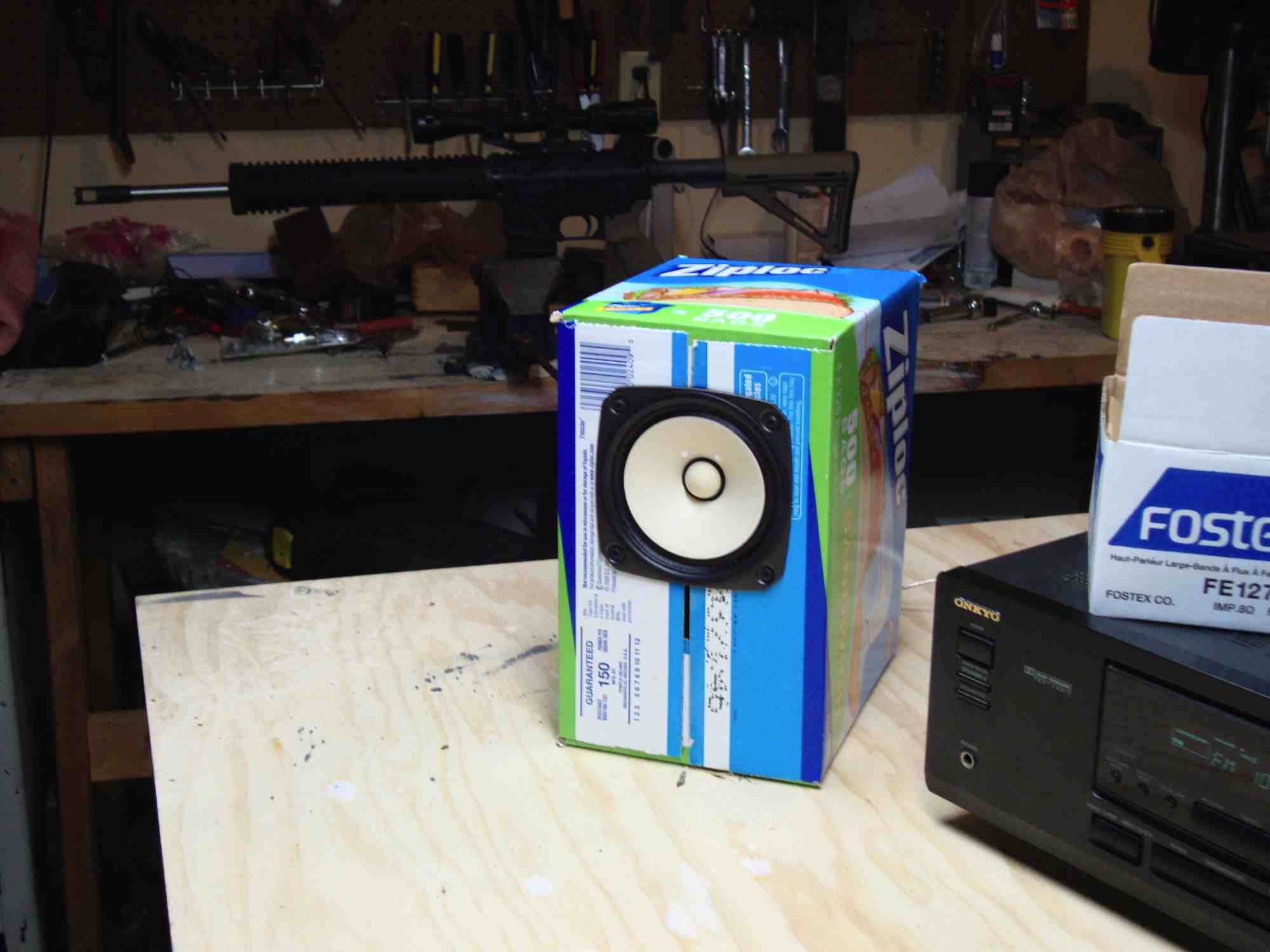

Anyways, here are the Fostex FE127e's breaking in..

Nice enclosure 🙂

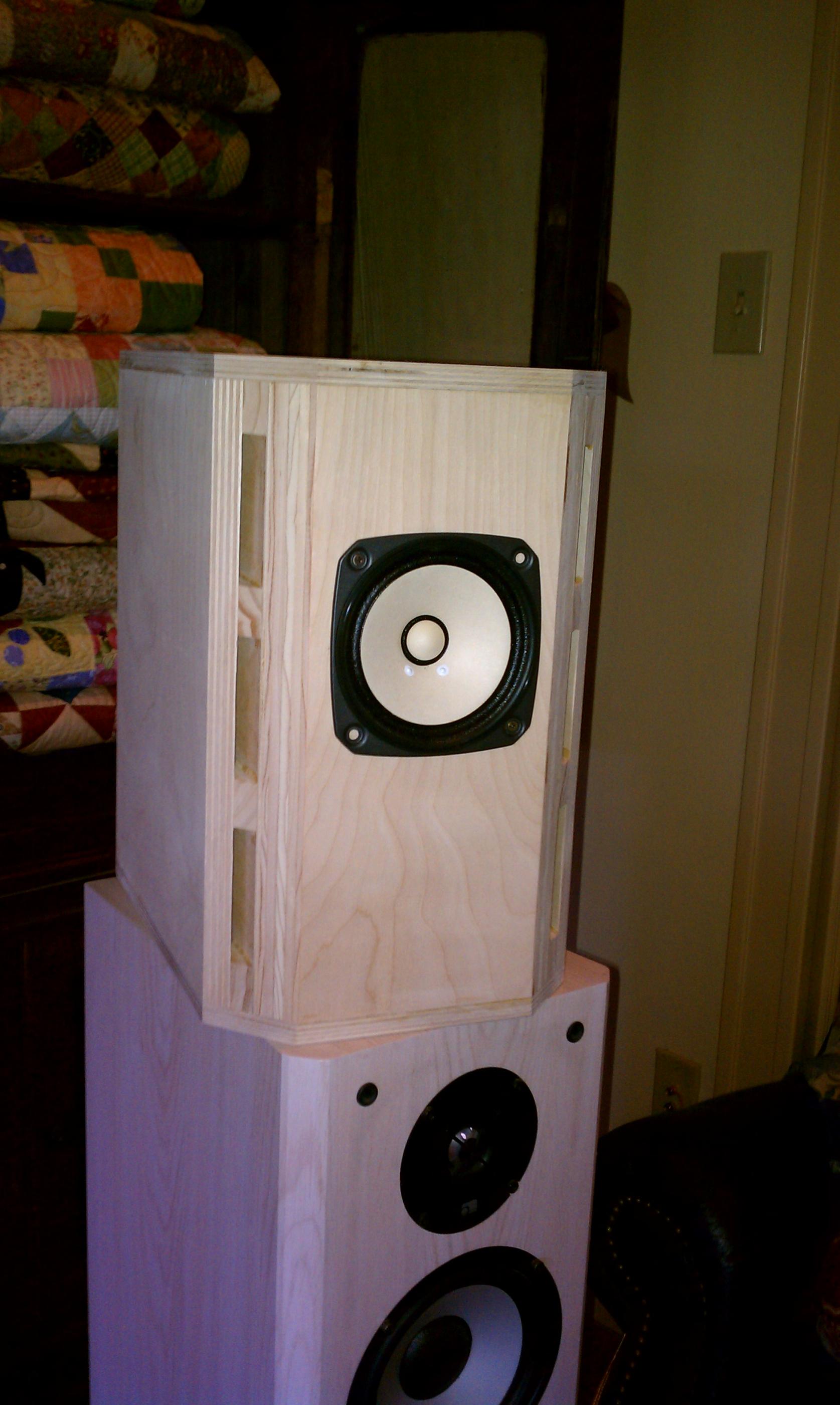

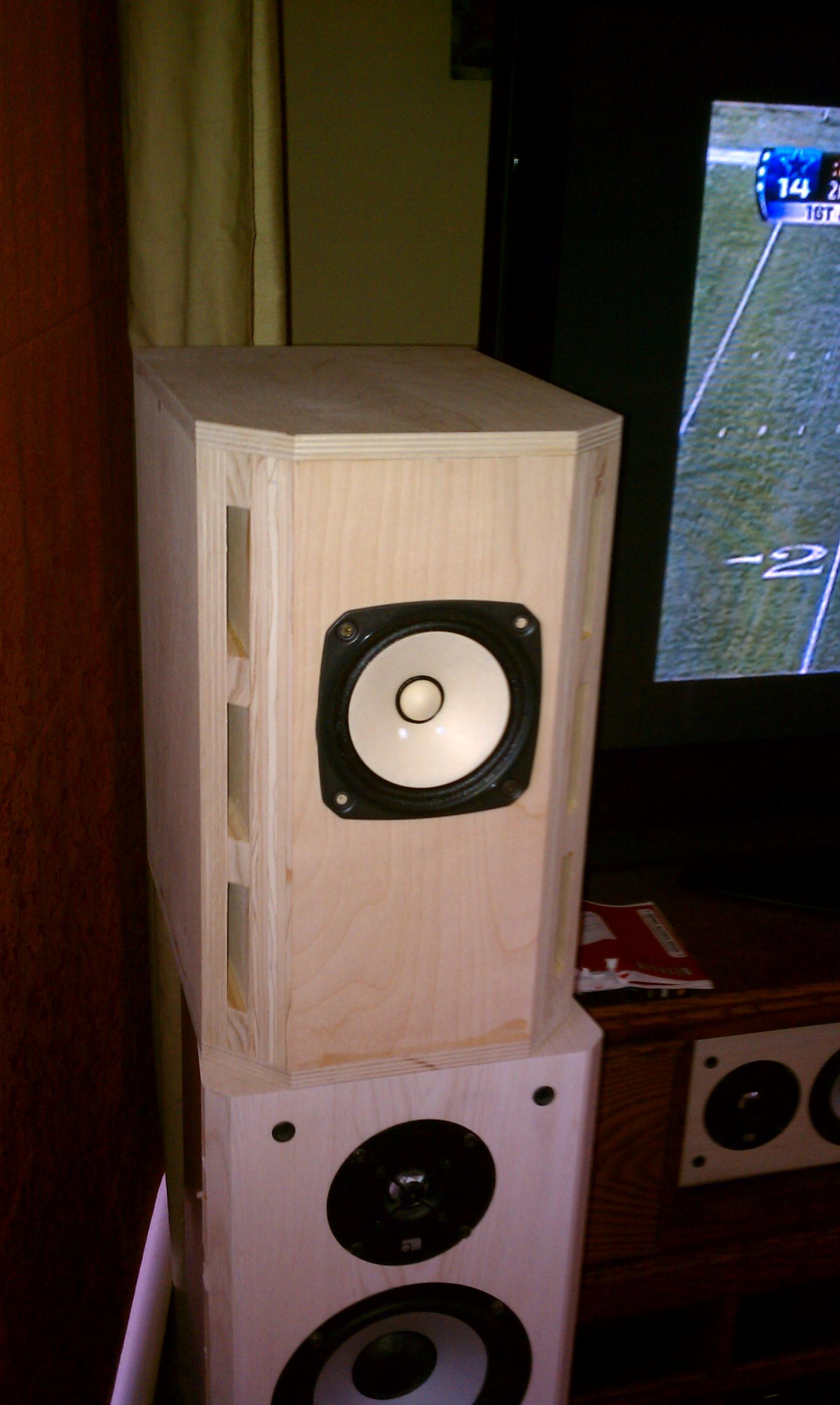

decided several months back to build the primes but didn't get started to a couple of weeks ago.
I took my time on these with the fitting of brace to driver and was definitely apprehensive about cutting the baffle angle. I spent extra time on fit of panels before gluing and learned the value of a flush trim router bit. These are 1/2" BB, with 3/4" oak plywood for baffle and 3/4" polystuff batting on interior.
I still have to decide what finish and what I'll do for stands....too high sitting on Axioms. 😀
So far they sound good hooked up to an Onkyo and my Sony Cd player.
What screws do you guys like for attaching driver to baffle?
