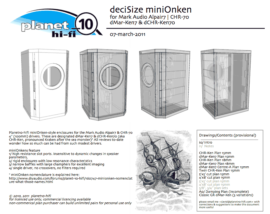

I would really love to build a Fonken style cabinet with the CHR 70 as driver.
But I can't find any plans on that matter...
Could you kindly provide some instructions on how to implement ther CHR 70 into the Fonken?
Thanks so much guys

Fonken is a code word for Fostex + Onken, as far as I know, or rather for some Feastrex + Onken.
Onken is the Japanese designer who used this concept a lot. His concept was popularized in the French magazine L'Audiophile, by the famous mr Jean Hiraga.
You can find how to calculate the vented box for ant LS, in this ONKEN CALCULATOR, by Cyr-Marc Debien.
It will give the vent length and width plus depth.
You enter the LS data.
Fine tuning is done with inserting some material in the vent (like felt).
easy isn't it?
The Fonkens only borrow the configuration of the side slots from the Onken. The tuning is quite different.
lenconian, the box you want is the CHR-Ken (pronounced the same as the sea monster). The plans are not free (althou they come as part of a purchase of P10 drivers), you have mail with the details.
Attached is a snap-shot the title page of the current plan-set to give an idea of how comprehensive the document is.

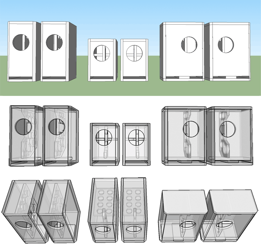

Hi Dave,
Can I use Classic GR Fonken cabinet for Fostex FF125wk driver?

The cabinet for the FE127 is too big for the FF125wk.
A free set of CGR dFonken125 drawings shortly.
dave
dave
http://p10hifi.net/tlinespeakers/FAL/downloads/CGR-dFonken125-free-0090612.pdf (updated 09-june-12)
dave
Cool, out of curiosity, what is the purpose of the piece of wood behind the driver? I was assuming when there's a lot of bass, that the driver would want to move back and forth.
it might tend to, but the only part of the driver you want to move is the drive train & cone/diaphram
as to the enclosure, there are lottsa schools of thought on construction materials & bracing schema - to put it simply, some of the tenets of our general architecture are: high quality multi-ply plywood ( i.e. Baltic Birch, Apple Ply, Finnish Birch etc); strategic bracing (including of driver to enclosure); and if you carefully analyze drawings, aspect ratio of the 3 dimensions
that piece of wood behind the driver is part of the bracing scheme
