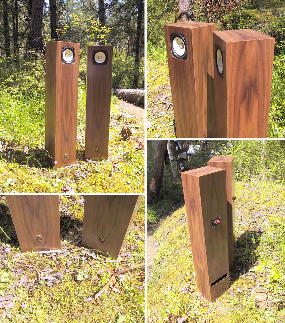

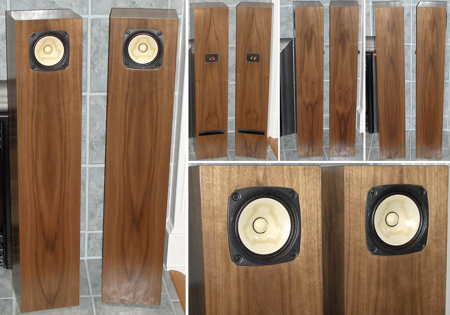

I've built enough of Dave's designs to note the following:
- try to maintain the net internal CSA and port lengths, etc. that means the width and depth will increase by a total of 6mm each -( i.e. to 195mm and 161mm respectively);
- many of the MLTL or resistively ported enclosures have proven in real world use to be quite tolerant of minor variations of dimensions (I've made more than a few cutting/assembly errors over the years, and only a few have resulted in unmitigated failures to launch);
- this particular enclosure has a lower void chamber intended for ballast that can be reduced to retain overall enclosure and driver height, even when filled this box can be tippy, so an enlarged base plate (not shown in sketch or photo) wouldn't hurt;
- the final cutting plan will depend on how you want to overlay the sides / front/ back - personally on the designs with slot ports, I find it makes for quicker assembly and easier finishing to overlay the sides, but that does mean the sides will be a different width than the internal driver brace, so careful cutting and dry fitting will be necessary to ensure tight fit;
- simple butt joints are more than adequate for this one (use biscuits if you like, but I tend to just use air nailer) - dadoes, splines, glue mitre joinery will only complicate the assembly and would of course completely change parts dimensions;
- I'd highly recommend running the driver brace longer than shown on Dave's drawing, and interlocking it with the lateral panel that forms the slot port;
- plan ahead as to type and location of input terminals/wiring/damping materials, this is a tall skinny box parts of which are virtually impossible to access after assembly;
- see my hasty dimensioned sketch attached (as noted above, some part dimensions would change depending on how you overlay panels, so a detailed cut plan could be pointless)

Absolutely awesome reply - really helpful!
Nice work on the veneers above btw
I'll post some pictures when I've started
