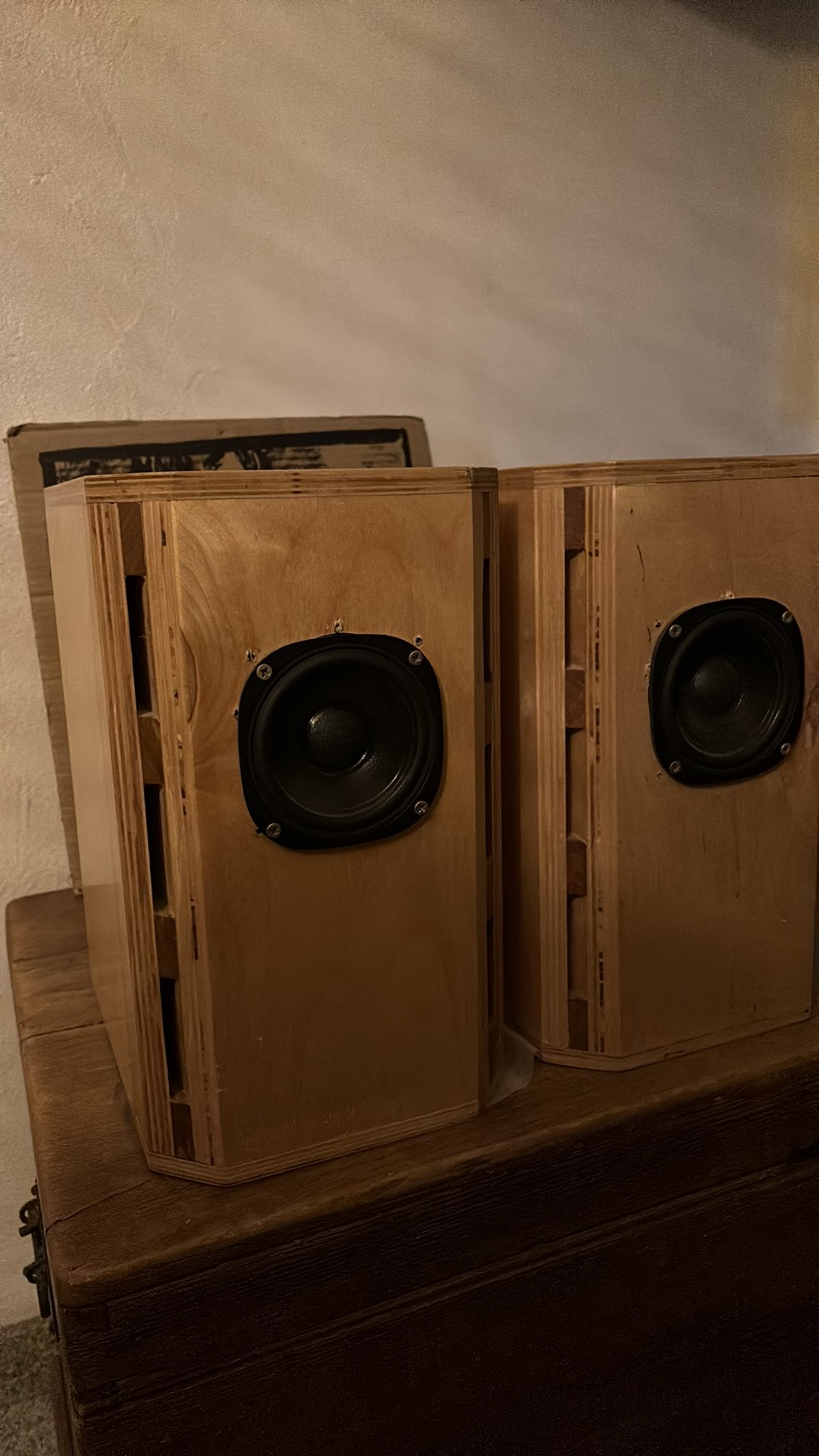

Hello FR fan,
I've some Finked enclosure made from nice ply and wondering which Mark Audio will fit the best?
Alpair, Pluvia?
I compared Fonken vs Marken enclosure dimensions, quite note the same.
Thanks for sharing your thoughts, experience and whatever you want 🙂
Chris
13 litres. The volume is appropriate for A10.3/p and they woukd be tuned lowwr (that happens by adding addition vent spacers), but those are unlikely to fit the baffle.
P7HD/A7ms would require losing volume, vents might be an issue.
CHP/CHR90 might work. I can’t check at the momnt.
