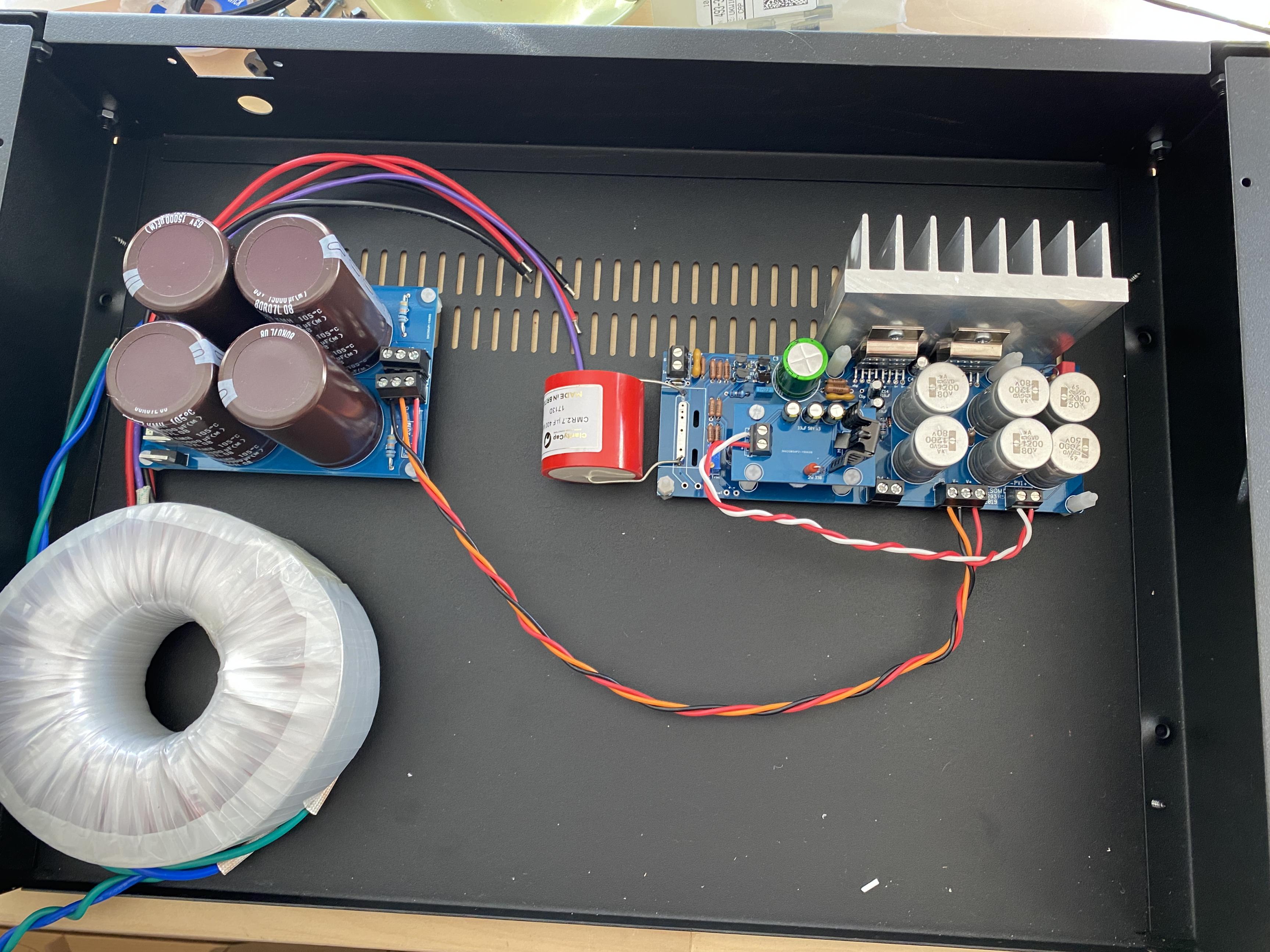

I have the Pesante 2u chassis for a dual mono setup and heat sinks on the way from heatsink USA. I’m wondering what the best setup would be between:
A: Mount heatsink to back of chassis.
B: Mount heatsink to back of chassis but cut out section of the steel chassis plate so chips could mount directly to aluminum heatsink
C: Just mount it inside with adequate ventilation.
I assume B is best but not sure it’s necessary and not sure if A is any better than just mounting inside since you have the additional interface between the steel chassis and heatsink.
A or B. C wouldn't be enough without a heatsink also attached.

Just getting around to final assembly... option C does have the heatsink (attached with clips and keratherm pads). There are vents above and below so I’m thinking it should be adequate?
I'm sorry to inform you but this cooler would only be adequate for the 7297. As per notes, recommendations where for something like 2U sized or better. You're doing an excellent job but you need to greatly increase the heatsink size and I would mount it outside for more airflow than those vents supply. I feel bad about having to "burst your bubble" but anything is better than having to resolder on new chips!

Glad I asked, definitely better to know now ha! That is one of the 2u enclosures but different line (pesante vs dispante). Shouldn’t be too bad to either arrange it so heatsink is outside (and get larger ones) or just roll with the dispante enclosures. Thanks for the help.

Do you have information on that heatsink? I could double check to see if it could work if mounted on the outside of the enclosure. It just looks inadequate - I could be wrong. The real issue is for you to mount it means permanently modifying the enclosure to be able to take a reading to see if it's going to work. I apologize for the haste early reply, I should be checking closer so you don't have to get another enclosure - but the chance of that still stands.
I need to know the height if that is a 3.500" from Heatsink USA. They're good heatsinks, but I can't tell from the pic (as per my first thought was it was way too small)
I'm assuming it's the Heatsink USA. The issue would be you could only run easy 8ohm loads on it. If you have 16ohm speakers then ****, just leave it as is! But if you ever want to use 4ohm speakers, or even 8ohm speakers that are secretly 4ohm woofers, you need to upgrade heatsink size.
It might be possible to get away with the same enclosure with internal mounting by using a very wide heatsink the height of the enclosure and a copper bar just big enough for the chips and clips that is bolted to the heatsink, with a thin amount of thermal paste between them. (the copper bar acts like a heat spreader) It's not something I can promise on though without testing.

It is indeed the 3.5” from Heatsink USA. 3” tall (which is what will fit in a 2u height enclosure). What width do you recommend for proper performance?
Seems like the cheapest and easiest way to “do it right” is getting proper width heat sinks and cutting out part of the back of the chassis, though I’m not totally opposed to getting new enclosures (have a couple other projects I’d like to try as well and nice to have them on hand.)
Well you could mount this one inside like you have in the picture; if there's room. You could put all the PSU stuff towards the front. I'm not saying the heatspreader wouldn't be necessary but it's not a bad idea depending on your skill level. The venting top and bottom should be ok. This would allow you to load the amp down. The only problem I could see is if ambient was real hot. Depending on load it may never get hot with that heatsink.
