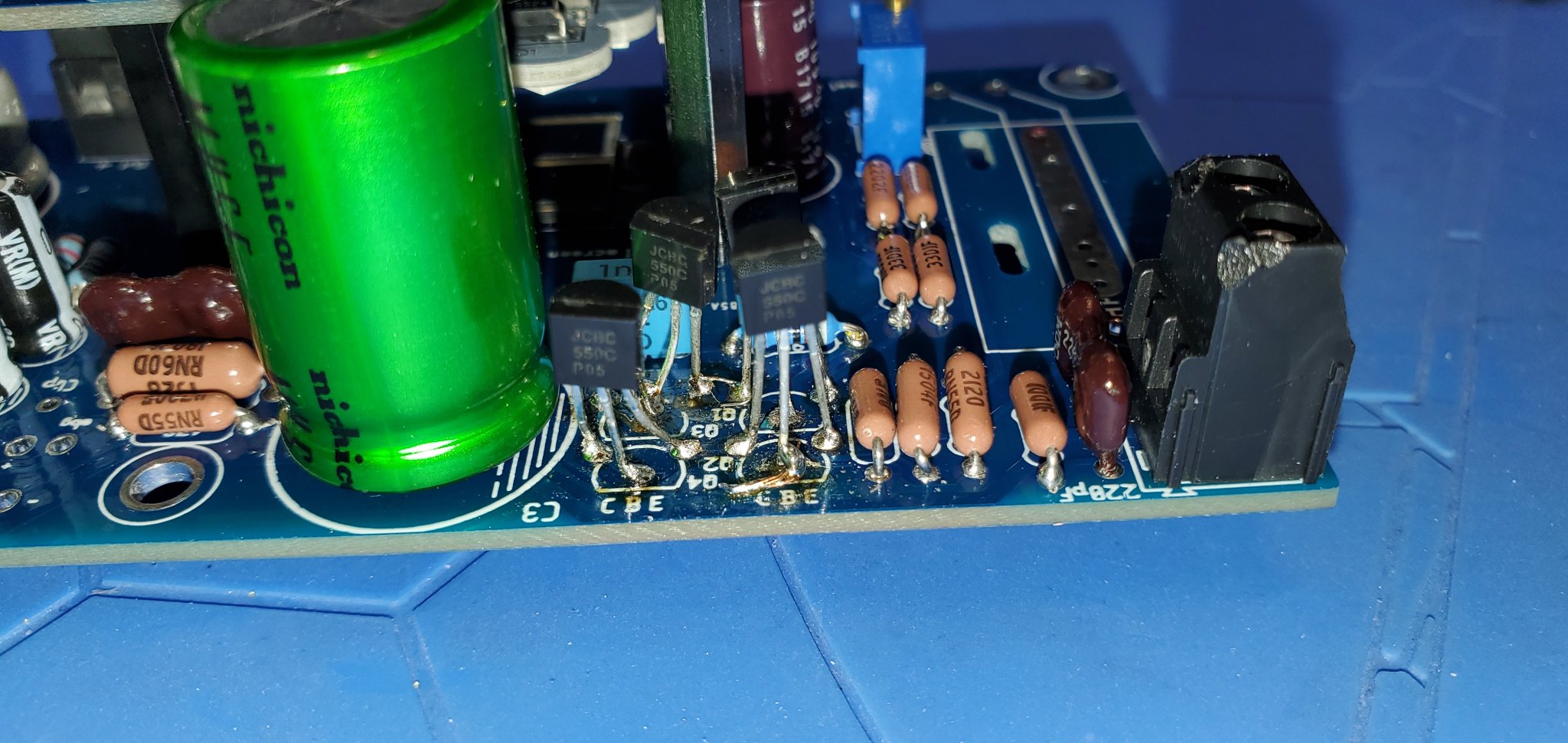

Destroyer, I have a question. I finished one board other than mounting chips, waiting for the insulating wafers. But on the other board 2 of the transistors pads have come off. Q3 base has a trace going to it's collector, I added a small wire to join back traces, also the Q3 emitter to the Q1 collector. These are connected and have added a wire to join them back up.
I am having difficulty tracing where the base of the Q3 comes in or is it just connected to it's collector? I'll ohm out the other board but it has all the resistors mounted. Have you got a partial schematic showing the transistor connections so I can trace out.

Also the pad on the base of Q2 has lifted, it seems to trace to the 18k and one side of 1.5M resistor. I tried to edit it but only allows you 30 minutes.
That's odd you had pad lifts. It is not a common occurrence. I put solder on a pad, push the leg into it, then do the others as a quick iron touching pad & leg, then solder pushed into the joint.
It's true it is slightly odd having pads but the configuration does have a lot to do with performance. Different layouts measured a good bit different.

Yes, the first board I did exactly s you mentioned, put a tad of solder on each pad, even added just a bit to the tip of each transistor leg and then solder pushed to the joint. The second board I did it same. Somehow a few pads lifted but the were the Q3 B to C. The Q3 E to Q1 C. Also the Q2 B pad, but I fixed it and I get continuity now to the 1.5M and 18k resistors. Not sure again why these lifted.

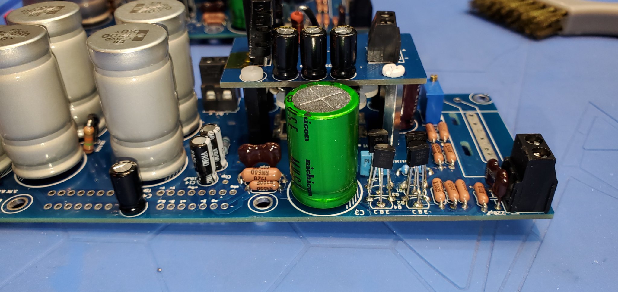

Destroyer, are there any one of the holdown screw holes on the main board that cannot be used with a metal standoff to mount to the bottom chassis?
I have plastic ones and metal ones, I tried a meter and none seem conductive to any one the holes. I did use plastic on 3 of the ones as per your info on the LED board and for the one to be metal to the lower power board . Getting ready to fire this up in a few days and don't want to fry anything. Looking at other pix of finished amps quite a few people are using metal standoffs from the amp board to chassis.

Never mind I got plastic ones to work perfectly. One amp board mounted.
Metal is fine except on the PVI shield hole under the main amp board. The one from main amp board to LED should be metal for the PVI shield, just no support under it unless it is plastic. It does not matter if the none-PVI holes are metal because they are not connected to shield.

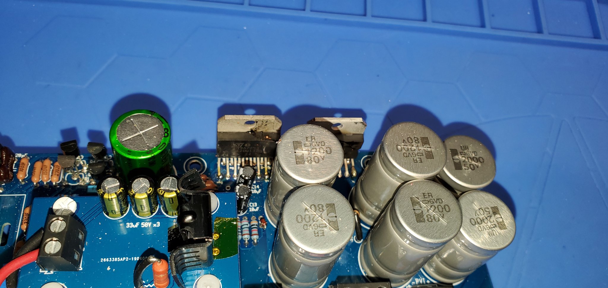

Well good luck on the left channel, amp worked well producing about 63 WRMS at 1khz.
But right channel was ok until I went Just passed 80% on variac, had about 30 volts DC hitting amp board at that spot. Moved variac to full power and poof brew fuse and smoked both power chips. Both were verified as backs not touching ground with wafers behind board.
Bad chips?
Bad chips?
He got 8 of them from Mouser. Good thing, so I have 2 more to put in. Wow it was hard using wick to remove the old ones but I think the holes are all clear now ready to install 2 more. I'm not sure to tell if the board had any issues. I think if they blow again for some strange reason, doubt that board will take another desoldering/soldering. Anything to check before soldering new ones?I only ever used this style of amp in a Yamaha or Sansui, can't remember..that was years ago and it went ok.
Pin 8 trace may be disconnected from v-. Check on that.
I haven't had bad chips from mouser, but I am sure it is not impossible. Loss of isolation is the common cause for this issue.
