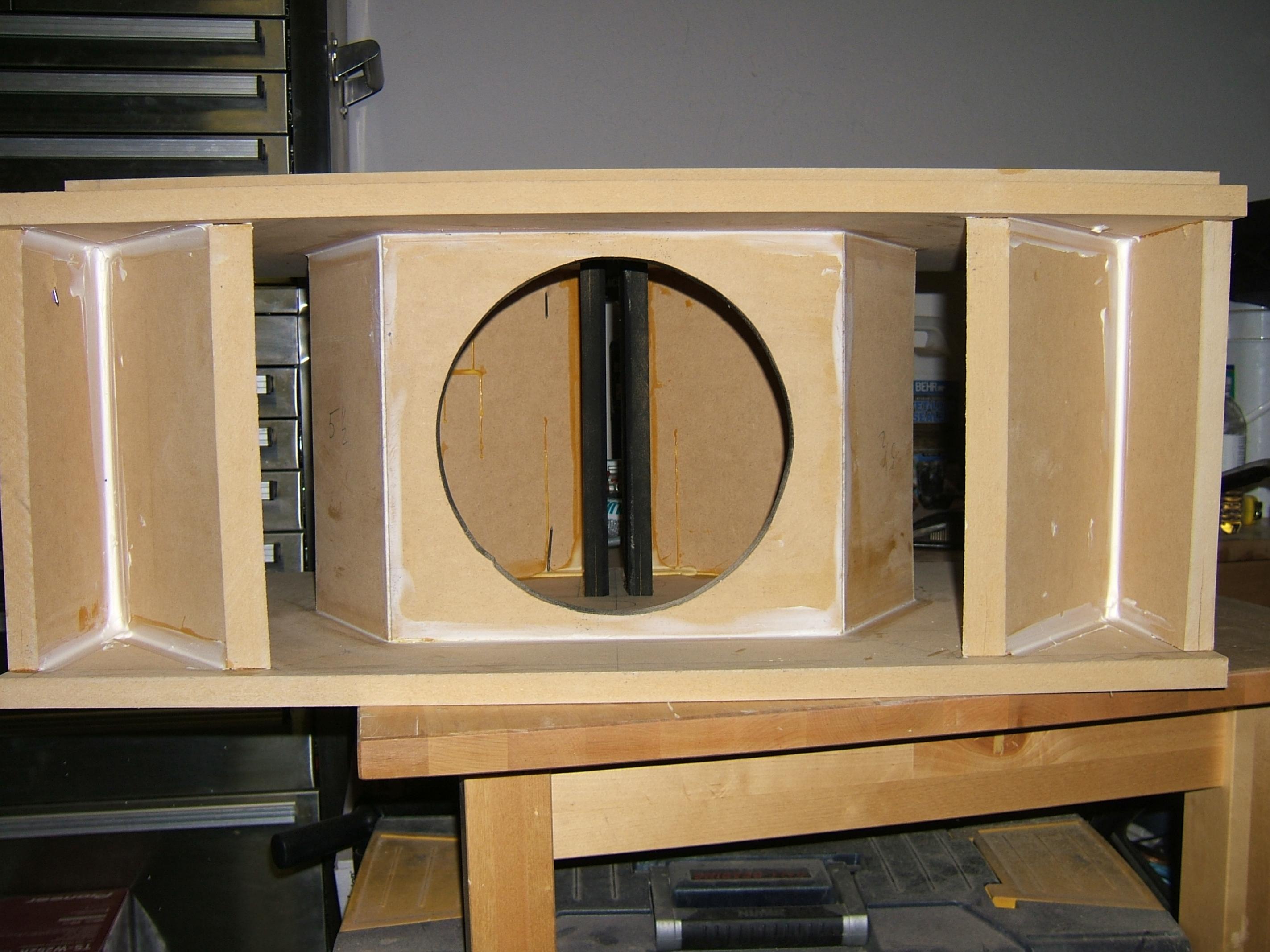

folded horn subwoofer for single 10" driver
Heres the complete photos, I'm curious if I built a base for it with a swooping mouth extension, similar to the frugalhorns if that might just give me a little more in the low low end.
Any suggestions?
http://sphotos.ak.fbcdn.net/hphotos...417527122828_1372130882_2558364_6482111_n.jpg
http://sphotos.ak.fbcdn.net/hphotos...1417527162829_1372130882_2558365_550672_n.jpg
Looks great.
Adding a little "flare" to the mouth will likely have no effect at the frequencies you're most interested in. The only way to make a horn play lower is to make it longer, but your driver had better be up to the task as well.
1/4 of the wavelength at 40 Hz = 7 feet
1/4 of the wavelength at 20 Hz = 14 feet
As you can see, adding an octave to the low frequency response doubles the horn length required.
