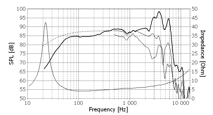

A ported Scan Speak L26Roy tuned to 30hz is flat to 31hz.

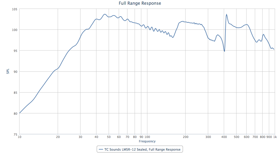

Comparing the L26Roy 10" in a 1 cubic foot box (factory spec sheet) to the TC LMSR 12" in a two cubic foot box (Josh Ricci Data Bass test) we see the TC LMSR 12 is -3 dB at 30 compared to 100 Hz, but is +3 dB at 45 Hz, while the L26Roy has no peak below 100 Hz, and is -7 dB at 30 Hz.
The two would sound quite different to anyone paying attention, the L26Roy would sound subjectively "tight" or "fast", the LMSR would sound "slow" or "boomy", it's response is similar to what people have complained about regarding other enclosure types.
Equalize them to the same response and I would bet you will find them to sound quite similar, other than the heavy cone mass of the LMSR does not behave well above 200 Hz.
Using a 24 dB per octave crossover that difference won't be very audible (if the out of band peaks are addressed), but with a 12 dB crossover with no EQ the L26Roy would "win".
