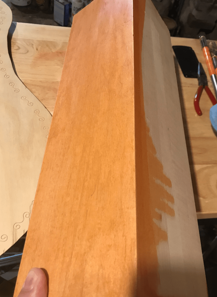

Also doing some staining and polishing shown below, maple is easy to work with, needs some improvement, but getting there. Let's Make The Acoustic Guitar Rock!!
