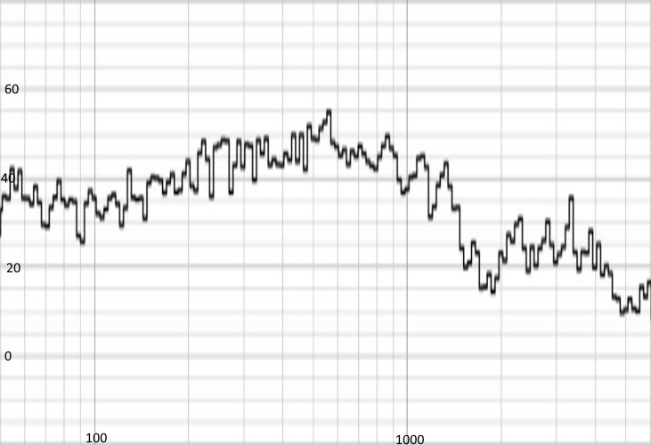

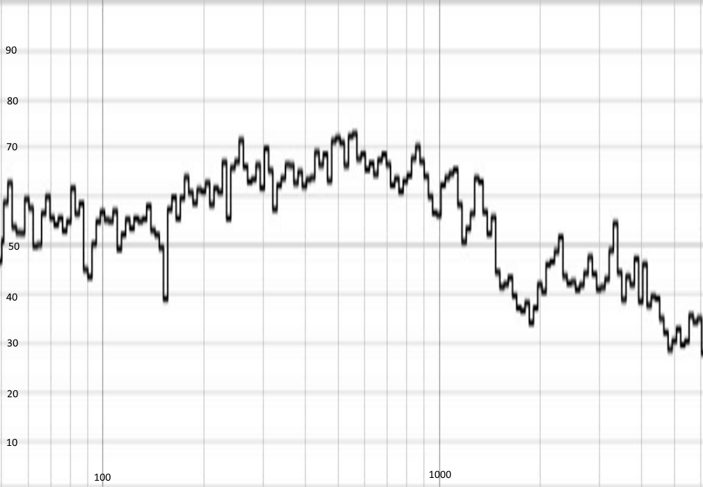

I stretched a few of the the graphs on the y axis, to make them more readable. You'll need to adjust the y scale span to cover less range, with more focus on the where the sound levels are. I also cut below 50 and above 6k on the x axis...fooling around using paint.net.
The common attribute I see is the sound craters some 30 db between the loudest frequencies, 300 - 700 Hz and 2 kHz, and then the 2-4 Khz is some 20 db down from those loudest frequencies. If you put the pink noise from phone through just a small guitar amp, same bed-plane measurement as your horns, would it also have this? Is this really due to the horn loading, or something else in the system doing that?

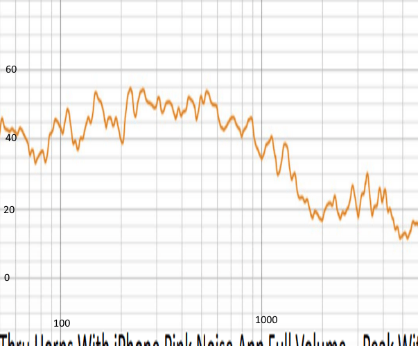

I'd like to see that the pink noise signal is flat electrically, across the frequency range of interest, say 50 to 10kHz. Unsure how to do that with the USB measurement mic.
Last slide added is better resolution of first slide. Everything looks pretty consistent, about +/- 10 dB in 100 Hz - 1,000 Hz, but of course louder with the horns.

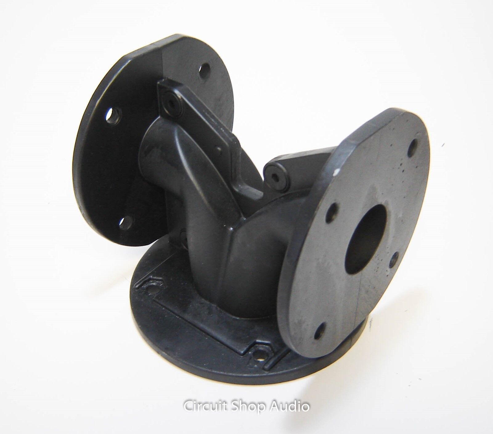

A short parabolic reflector similar to half of a EV MTA-22 scaled up to the driver diameter (less the surround width), directing the output of the front of the driver to the face of the guitar would also be an option, and could increase forward gain over that of the direct radiator.
You have learned a bit from your pink noise experiments, but until you start measuring the frequency response with REW's sine wave sweep, with a known flat response amp set to a specific voltage, measured at the same distance and angle from the source, you won't be able to accurately determine what the response differences between changes are.

I still don't, and never will find your REW screen captures of random pink noise events to be a legitimate or valid comparison of frequency response.
