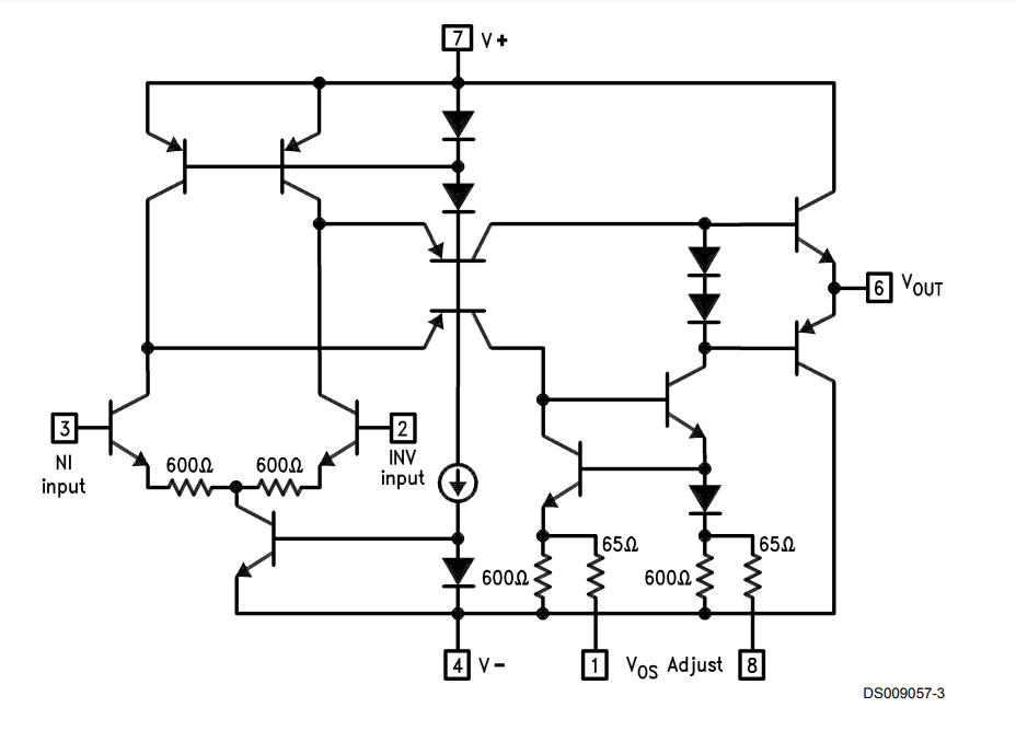

Here is an amplifier with a "Long Tailed Pair" differential input, which uses PNP transistors to create a folded cascode. I present the original schematic (NSC LM6161) and a modified version showing thermionic valve LTP

Using a current mirror CCS on the plate too allows the B+ requirements to be dropped to 200V - the voltage swing is small from the 6SN7, however the current swing is enough that given a ZTX558 the current can then be used to create a voltage swing through the 7500ohm resistor.
It's a little hybrid for purists now but I think this is starting to look decent.
The only issue is reducing the reistance means you suffer from the difference in phase causing an DC offset. I'm still looking at ways to reduce this at the LTP level rather than adjust the bias of the output tubes.
