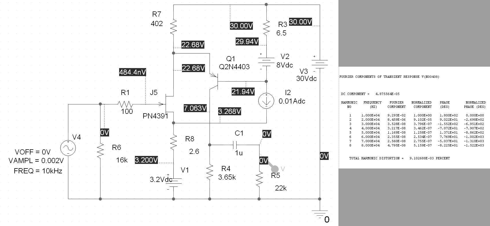

I've been messing around for about three years with various jfet/mosfet single ended preamp circuits meant to run off a 30V rail. I have a standard living room setup that allows RIAA and line amp modules to be swapped around so I can evaluate the sound. This one is a circuit using the humble and inexpensive PN4391, originally intended as a chopper/analog switch. It works very well as a cascode jfet for fancier fets like the 2SK170 and the like. It also makes a reasonable amp on its own if you can give it enough bias current to wake it up. Attached is a folded cascode circuit that provides enough current through the PN4391, and separates the load resistor from the main jfet bias so that you can tailor the gain to a desired level. I chose a gain of 40X, which is what I usually use in the the first stage of a passive RIAA preamp. I also set up the jfet and cascode transistor to be biased by strings of first-generation GaAsP LEDs, which have a low incremental resistance (I've tested it) and presumably, low noise. Each diode drops ~1.6V, and has an incremental resistance of about 1.3 ohms. The source of the PN4391 gets a string of two LEDs (3.2V, 2.6 ohms), and the cascode transistor is biased with a string of 6 (9.6V, 7.8 ohms). I expected the distortion level to be only moderately good, as the LEDs don't provide a lot of degeneration in the source of the PN4391. I tried biasing the drain of the 4391 with several current sources, starting with the perfect current source available in PSpice, and then several more practical implementations. The choice of current source affects the higher order harmonics, and the ratio of 2nd order to #rd order harmonics. The cascoded current source using a pair of J174 p-channel jfets shown in the attached schematic was one of the better performers, with almost all 2nd order harmonics. All the current sources I tried clocked in at around 0.02% THD, but with varying levels of 3rd and higher order harmonics. Next up will be a variant with a source resistor for the PN4391 instead of LED bias. I expect that the degeneration will give me lower THD, at the cost of somewhat higher noise. This may not be a really big issue at MM cartridge signal levels. The 22k output load represents the impedance of the passive RIAA network I currently like to use.
Another variant, simpler and with lower THD, with just a resistor feeding the 4391 drain. This has been done before, but not necessarily with this fet. I'm sure the key to good performance is moving up the voltage source feeding the cascode so that it clamps the 4391 drain resistor. I'll try the same approach with a current source feed to see if the results are comparable or better. I'm applying the results of this simulation to the drive board for my "Lil Devil" hybrid tube amp - lots of parts got taken out.
Clamping a current source with the leds did not give as good results as a simple resistor, so I won't bother showing the circuit. I was intrigued enough by the second circuit shown here to incorporate it in one of my older layouts that also uses the PN4391 in the 2nd RIAA stage. I'll post more information when I actually start to build the thing. Lots of baleful deep red LED action, both in the first stage and as a reference for the onboard shunt regulator. BTW, Electronic Goldmine has NOS National PN4391s for a quarter apiece - while they last.

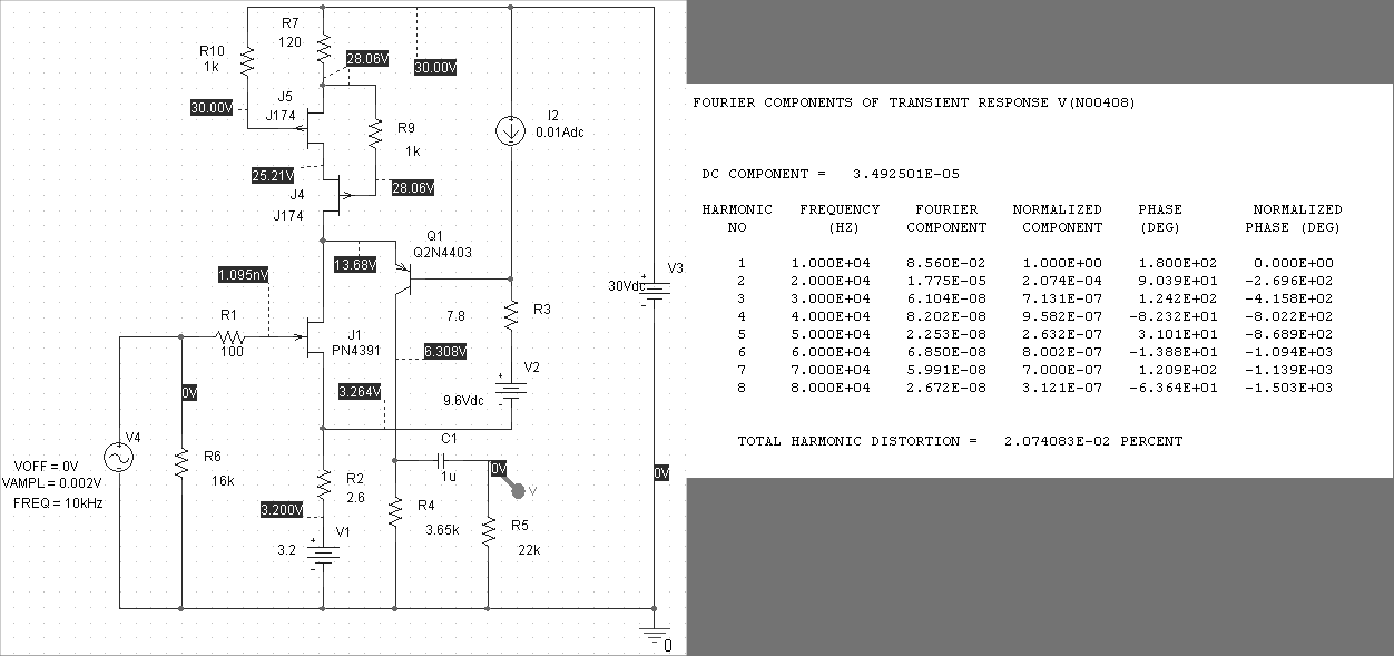

Any reason why you used P-channel parts for your current source in the first example? As the whole shooting match floats, N-channel arrangements should work as well or better, depending upon the choice of JFET.

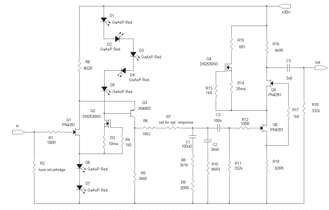

The p-channel option was the one that worked best - I tried several ways of skinning the cat.
I didn't try it in the simulations, but if you use more LEDs in the top bias string, you can bring down the dissipation in the jfet. There's no reason you really need 19V across the 4391. As for heat sinking, I'd just glue a little metal tab to the package with Arctic Silver epoxy. Having said that, considering the high junction to ambient thermal resistance, JB Weld might work almost as well.
Attached is the circuit I'm considering - the whole shebang, input 40X amp, passive RIAA network, and a 30X stage afterwards.

To expand on the results for alternate current sources in the first circuit, they all had similar THD in simulation, but the P-channel current source had a better mix of even harmonics vs 3rd and higher order odds. This is simulation, mind you. The simple clamped resistive load looked so attractive that I ditched the more complex scheme.

One observation: the first schematic may be slightly misleading, as topologically it's a driven/bootstrapped cascode, but the impedance in the source of the 4391 is very low, representing the LEDs used primarily for bias. Thus the base current from the PNP really doesn't have much effect, as it splits between the 4391 source (looking like about 1/gm under these conditions, maybe of order 100 ohms) and the LED incremental resistance, 2.6 ohms --- that is, the lion's share flows in the LEDs.
With a lot more external source resistance you will start to see the bootstrapping effect and reduction of the common-base stage distortion, and as well reduced input capacitance due to the drain-gate feedback capacitance, which is now no less than the device Cgd. Of course this will be at the expense of drastically reduced gain overall, as well as an increase in equivalent input noise voltage due to the R2 contribution.

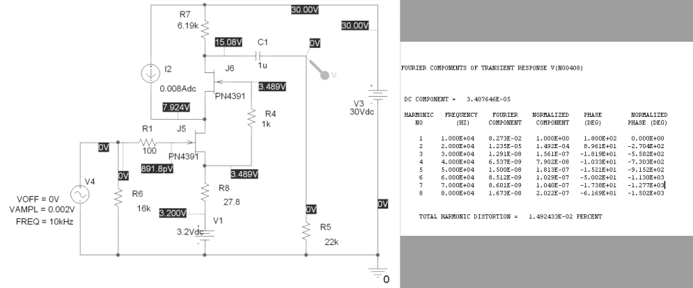

For grins, here's a cascode done standard style with a some extra current for the bottom 4391. The source is biased by a pair of GaAsP red leds, with an extra 24.9 ohms slipped in for degeneration. The gain is right where it needs to be at 40X, and the distortion is not too shabby. I like the power dissipation in all the active elements a whole lot better. This is more complex than a single cascoded 2SK170 with degeneration, with similar distortion, but the whole point was to make do with something besides that jfet for a change.
By the way, having been away from this for some years, and prompted by your remarks and use in these circuits, I decided to look for some thread on LED noise and found this: http://www.diyaudio.com/forums/parts/35821-some-noise-measurements-leds-zener-diodes-13.html Although not the last word on the subject it has some very interesting comparative data on LEDs and zeners, and many remarks from others after the author's initial presentation and updates. And it more-or-less confirms my experience with red LEDs over the years as being decent, if not particularly low impedance, components for bias use. There are some characteristics not discussed (unless I missed it) like the temperature coefficient of the forward voltage, which makes at least standard red (GaAsP) diodes a good match to silicon base-emitter tempcos, and owing to the net voltage difference a decent component to use in simple current sources.
