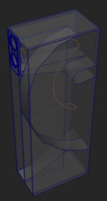

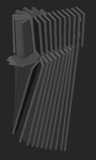

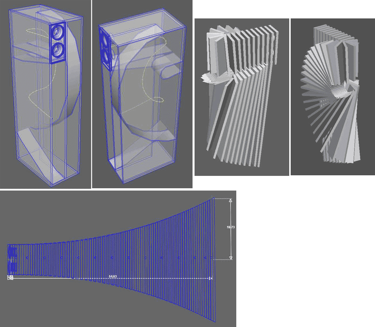

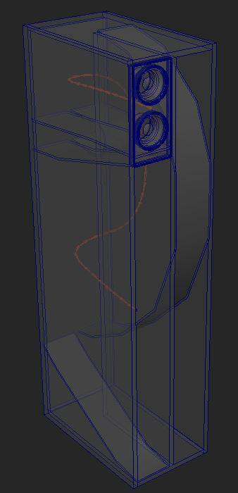

Based on the info on Folded horn speaker design - explanation and calculator I modeled a folded back loaded horn box for two 3.5" full range drivers.
I initially modeled one targeting 100hz as the low-frequency resonance, but it was inconveniently large(70"h, 16"w, 24"deep) so I then targeted 200hz which resulted in a more reasonable size box(42.5"h, 9.5"w,16"deep).

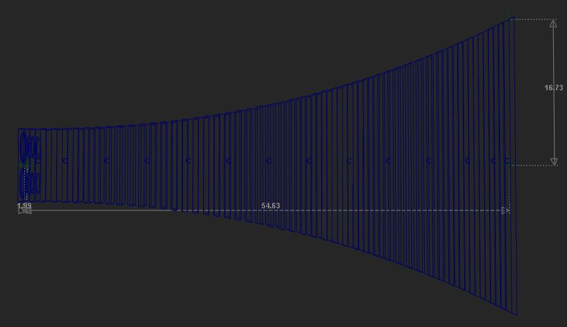

The horn unfolded is 4"wide the full length, 54.6" long, 8" tall at the throat, 33.5" tall at the mouth.
I've never done this before, so am interested in feedback, like if there's something obviously wrong with the design.

That looks intense! And all that just to reach 200 Hz.
Unless this is considered to be an exercise of style, there are a lot of designs out there that can reach 50Hz...
Did you mean 20Hz, and not 200? ... which would then be much more interesting!
Really need driver specs and frequency response, so will just say that normally one wants a BLH's HF response to peter out by ~125-250 Hz depending on the app, ergo a 200 Hz cutoff implies it will horn load way too high up in the mids, causing too much out of phase comb filtering with the driver's forward output if not heavily damped, negating most of the horn's high efficiency output.
GM
Well, to repeat Greg's post above, the first thing to learn is that you need driver's T/S parameters for any type of enclosure modeling to be meaningful, and that not all drivers performance is necessarily enhanced by use of a BLH.
OK, that's two things
Right, but that said, these type drivers tend to be high Q, so short of the necessary specs....... go 'old school' DIY and do an inverted BIB pipe horn designed based on a 140 Hz Fs, Vas, Qts juggled to get a 70 Hz BIB with a ~96"^2 Sm will probably work well enough and constructing it out of a fairly rigid cardboard box material with hot glue will help to damp it without the need for excessive stuffing.
GM
I have modified the gamma on your images to make them easier to see.
There is a lot of wasted space in this design. As well one does not need to keep smooth curves. That will allow more unwanted high frequencies to get to the mouth where combing with the direct response will cause combing.
And as GM points out with a BLH one wants to keep the HF response of the horn part to be limited… 250-300 Hz is as high as practical, doing a 200 Hz makes no sense.

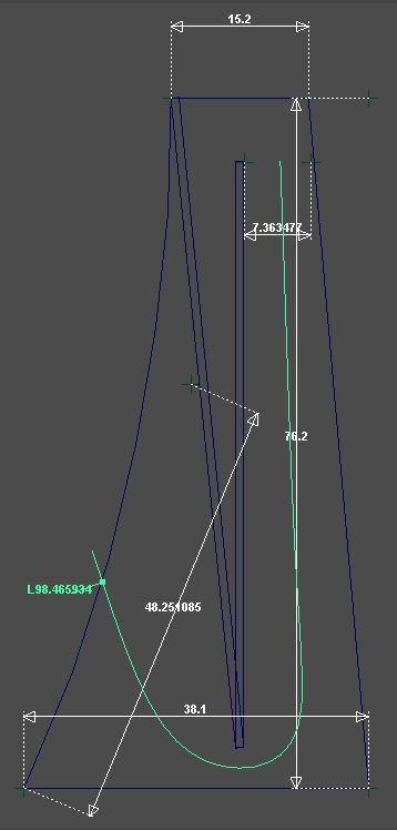

Thanks for the response guys.
There's clearly a lot I don't understand here(particularly the comment about how smooth curves might be undesirable in this use case, implying that sharp angles dampen the HF output from the horn), and/or that article is way off on the math.
For instance, if I apply the function from here to the Frugel-Horn I get a LF resonance of ~352.33 hz, and the length should be 150cm vs the ~98.46cm that results in the illustration above.

Indeed the math in that article is only rudimentary. And there is theory and real-world. Real world is more complex. The decent modelers do much more complicated math, and have been adjusted/tweaked to match real-world builds.
Do note that the Frugel-Horn has at least a 4x multiplication of the mouth size because of the proximity to a wall/floor junction. And if the green line is supposed to represent the horn length how come it doesn’t wrap around th efold and reach to the end of th point?
dave
I put the start of the line where the speaker is and figured the folded space behind it that lead nowhere was some sort of baffle since the sound isn't likely to travel down in and back up and round in a way that results in amplifying anything.

Time is tight, but a handful of notes, FWIW.
-A horn is a pipe that expands toward the terminus. It may, or may not, be impedance-matched down to the QW cutoff frequency.
-The QW cutoff frequency is a function of the axial length and geometary.
-The frequency to which the horn is impedance matched is a function of expansion & ultimate terminus area, once any boundary loading is accounted for. As noted, these frequencies are not necessarily (rarely, with bass horns) one and the same, and in essence you are blending QW action with impedance-matched behaviour.
-There is no obligation that a drive unit should be located at the throat of the horn. In the case of chamberless horns, it may be tapped into the expansion path at x distance from the throat, which can be useful in suppressing undesirable harmonic resonances in a compromised (undersized expansion) horn.
-'Classic' horn formulas are accurate, but only if the horn is impedance matched down to the QW cutoff, i.e. the horn expansion is not compromised relative to length. In most cases for size reasons, bass horns are compromised in their expansion, or as a minimum, significant boundary loading.
-As has been noted, LF wavelengths are extremely long, and relatively unaffected by bends. As wavelengths get shorter (higher frequencies), so they become progressively more affected & attenuated. For back-loaded bass horns (i.e. those loaded by the rear of the drive unit) that is usually quite a good thing; they are only useful over a relatively narrow BW or group delay becomes excessive (and very audible). As an ROT, about 300Hz is a practical upper limit. Smooth expansion is nice, and technically it promotes maximum efficiency; however its greatest impact is in the shorter wavelengths at the top end of the horn's operating region, and, given the above, this is usually the place where you tend to want less rather than more efficiency. Some will disagree, but in general I tend to regard this as not worth the effort (and potentially counter-productive).
