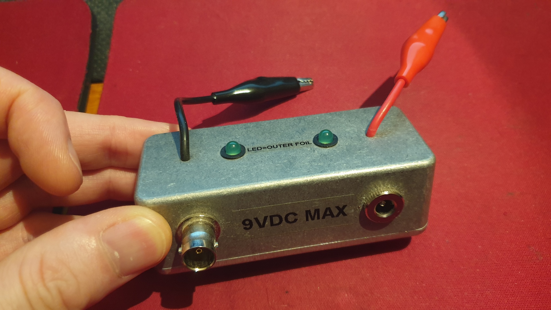

Foil side on K40Y-9????
Have seen a bunch of videos, read what I could find, fiddled with my o-scope for what feels like hours, and simply cant find a difference on any leg on any K40Y.
Figured Id be smart, and out smart the scope. Built a 4-5 turn coil, put the cap in it, ran every signal I could at 1 volt, 5 volts 15 volts. Anything I could think of to create some emf. No luck...
When I connect my oscilloscope on (without the ground) I easily see the 60 Hz hum surrounding us in the US. Grab the cap, signal goes haywire. Try to some what smooth the results and keep it in the display by adjusting, mark the high and low with cursors and reverse the cap, and I always get the same exact measurement.
The cap's are .47uf. Before I solder them in tomorrow, figured Id ask the experts if there is a better way with basic tools..
I found the metal cans on the K40,42,and 72's acts like a shield making it very hard to determine the outer foil. For sanity sake grab a regular film cap and measure those to be sure you have the scope dialled in properly.

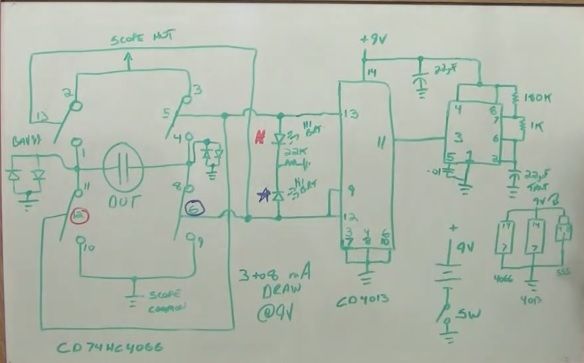

I found this schematic online many years ago, brilliant little device that switches the two connections around every couple of seconds which makes it so much easier to tell the difference, especially for these type of caps where the difference is very subtle. Can't remember where i found the schematic or i would link to the website.
