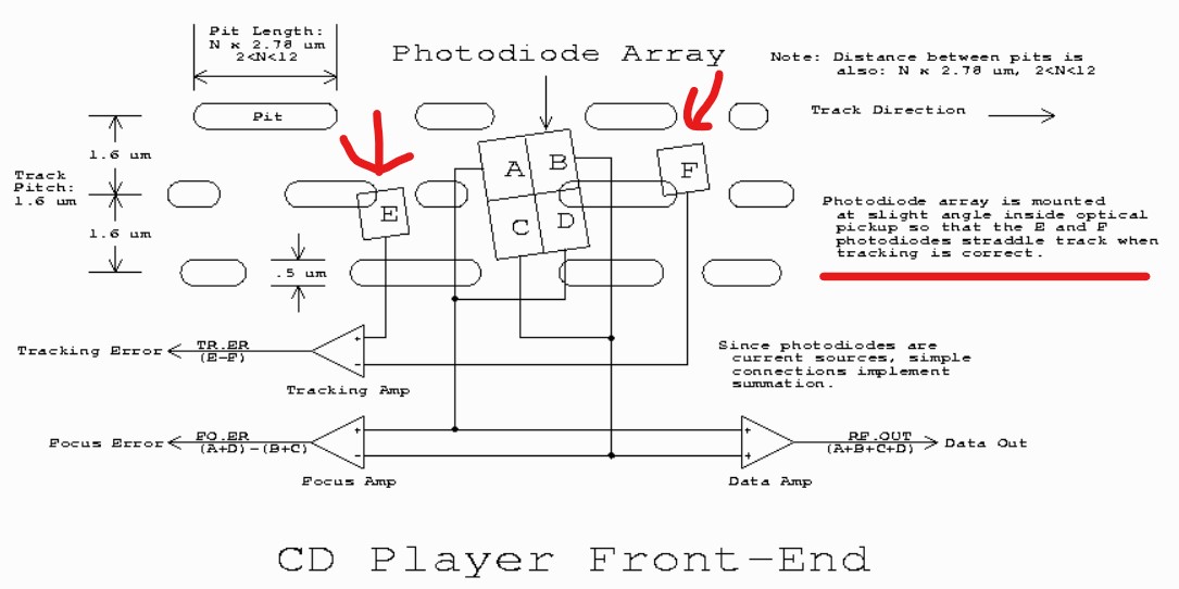

E-F balance is sometimes called Tracking Balance and relates to ensuring the beam falls equally on all the photo diodes in the array. E and F refer to the 'outer' pair of photo diodes in the group of six. A,B,Cand D are the group of four in the centre.

You can only adjust tracking balance under specific conditions which normally involve putting the unit into a service mode that unlocks the tracking servo.
Just try the easy method of looking at the tracking error waveform during track jumps. It is totally accurate doing it that way. You will not see any real change in the eye pattern, the adjustment is a servo tracking one. Slow the scope timebase right down and keep flicking through large track jumps such as track 1 to the last track on the disc and back again. During the time it is jumping is when you adjust the preset.
Focus bias is the adjustment that will optimise the eye pattern.

For pick-ups which uses a conventional worm drive to move the laser head I find that the method of flicking between the first and last track on a discs works very well for checking the E/F balance.
You do this whilst observing the tracking error waveform (usually marked TE on Sony based players) and not at the RF eye pattern test point.
However, the KSS-151A will change tracks so lightening fast I find that method doesn't work. Instead, what I do is to PAUSE a track and then slow the scope right down until you can see a 'pulse' pan slowly across the scope screen. Adjust until the pulse is centred around the 0v line.
For focus bias adjust for highest peak-peak amplitude of the RF eye pattern, which is usually the same as 'best' clearest eye pattern.
