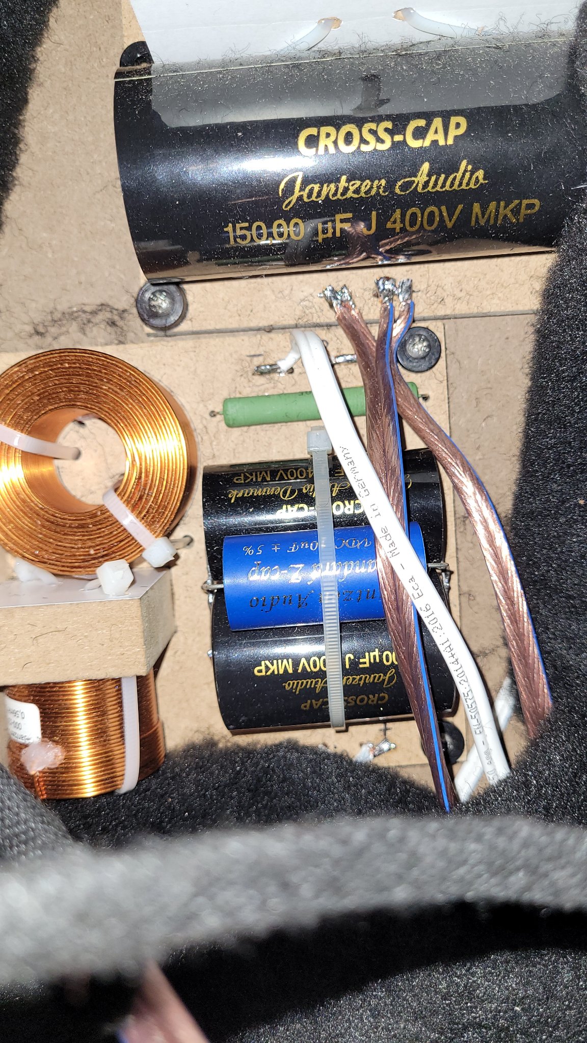

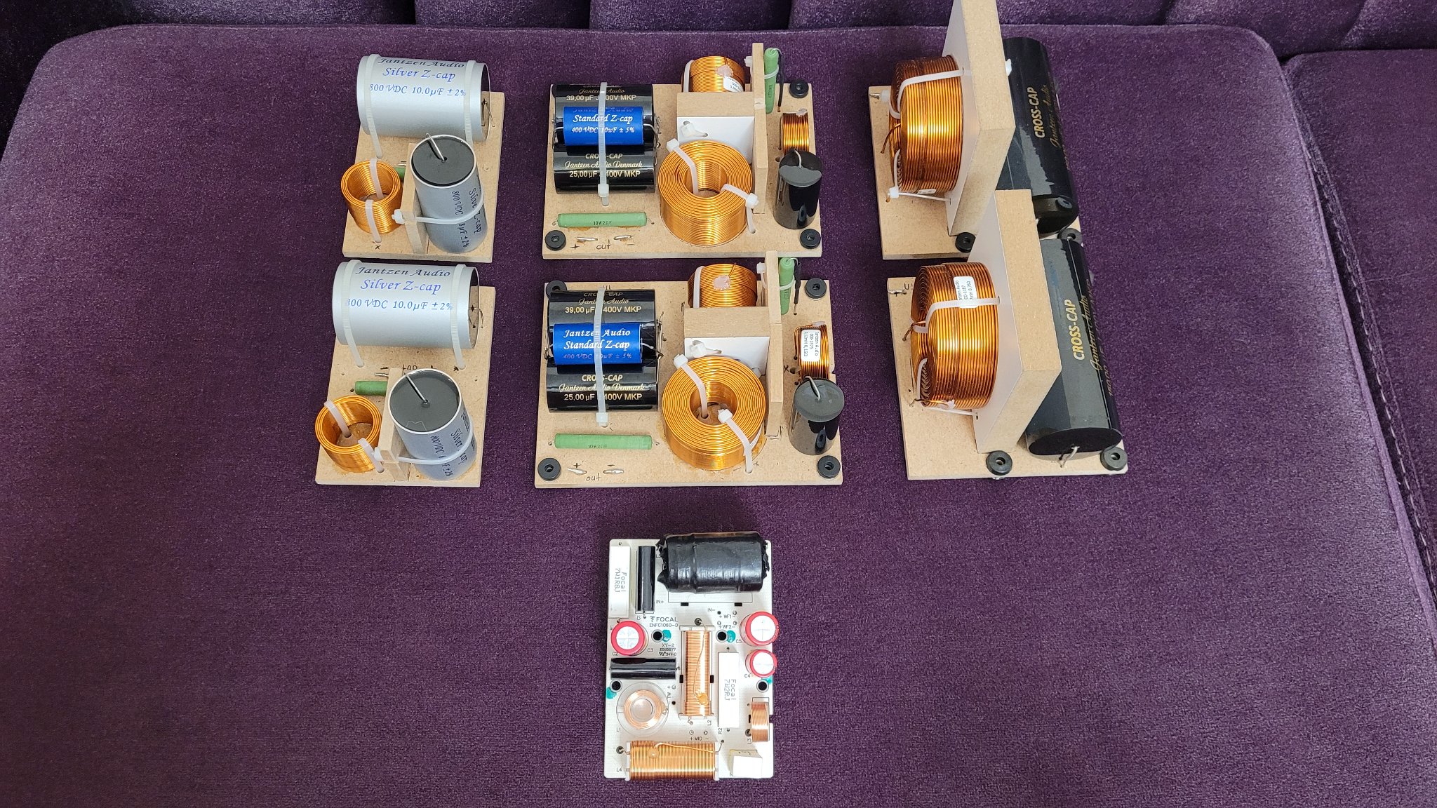

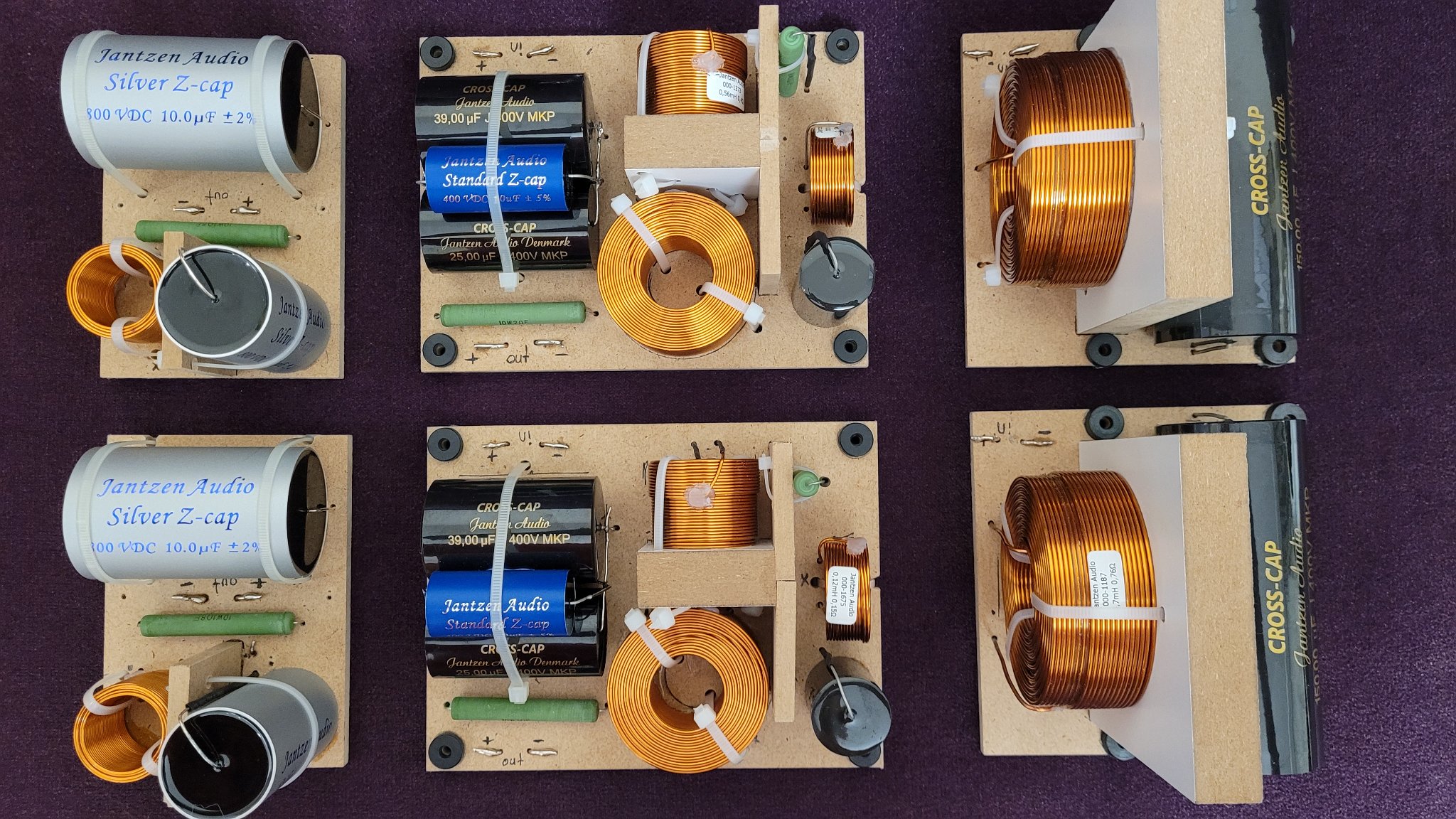

I was thinking about this too. Because I separated the crossovers for each frequency path. In this case, did I also cut off the signal exchange between them? The mid and bass crossovers are at the bottom of the cabinet, only the tweeter crossover is on the top.
I am adding the pictures of the crossover I made.

The OP stated before that if he placed back the old filter the bass response was stronger. So it seems unlikely that cabinet modifications had any influence.
BUT... first it was that ONLY the filter components were upgraded for higher value components. The OP assured it was a 1:1 swap for higher quality components.
In the mean time we learned that the filter PCB also was replaced by 3 separate PCBs. On the 3 separate PCBs I count 13 components while on the old PCB I count 12.
And still is it a 1:1 component swap. And a schematic is definitely not necessary.
I wonder what the next update is. The woofer was replaced as well?

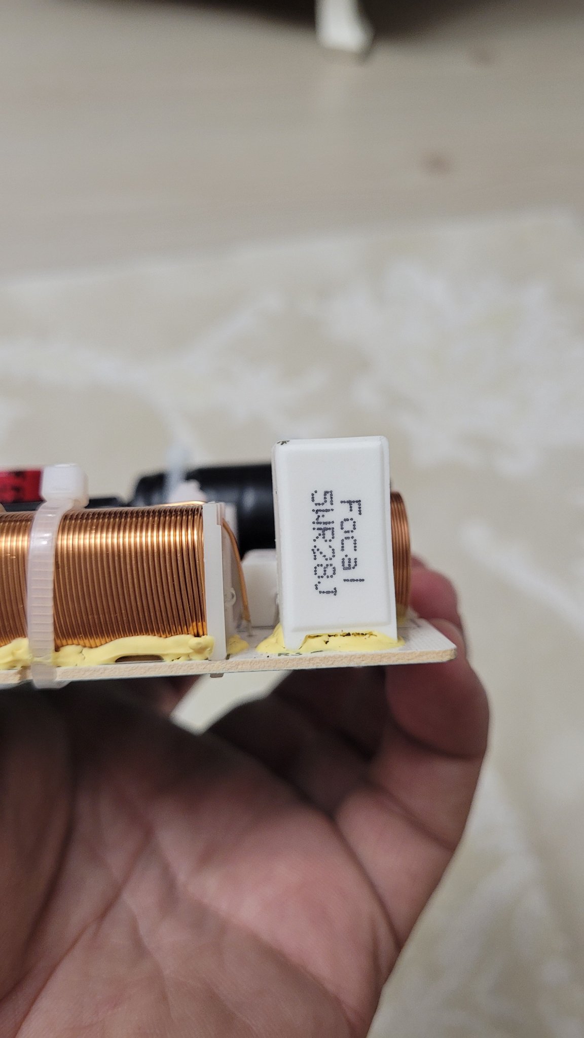

The original crossover circuit also has 13 components. There is a resistor placed vertically in the bottom corner. I think you missed that.
