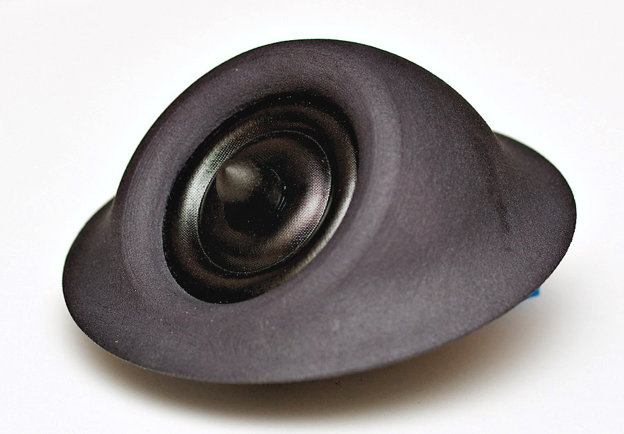

Car audio, right? where are they placed and where are they aimed at?
Making a printed back chamber could give you some aiming opportunity.
I used Vifa ring radiators in my door cards, a tweeter not known for wide dispersion. So I made a small waveguide slightly aimed to match left and right off axis angles... smoothly shaped to limit diffraction.

Tweeter is XT25 SC90-04
I had it printed at Shapeways with SLS. Not cheap but better quality and more durable than with home filament printers.

Aye thanks for the help.... yes I think this is what I want
I went to bed thinking what the others were saying.... woke up , and I was like ... the stevens tweeter has this little lip on it ..... I wonder if... then your post...
Of course that’s it.... yes. That lip is a tiny wave guide. The focal doesn’t have that... I just need to make one.

Could I just make a small ring out of acrylic and round all edges and place it around the dome....
That way I can keep the aesthetics. It only needs to narrow the top frequencies

Yeah so i put some foam on the glass right above the tweeter and it’s a million times better ...
I think , I’ll actually just leave it now and do a custom mount that recess the entire tweeter into the dash , on axis , so it’s 90deg plane is blocked from glass , I think then it will be just fine ,
