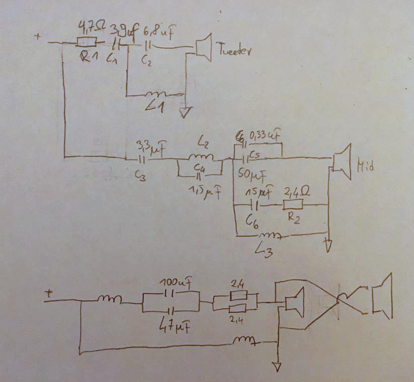

Focal Spectral 913.1 crossover diagram
Spectra 913.1 crossover

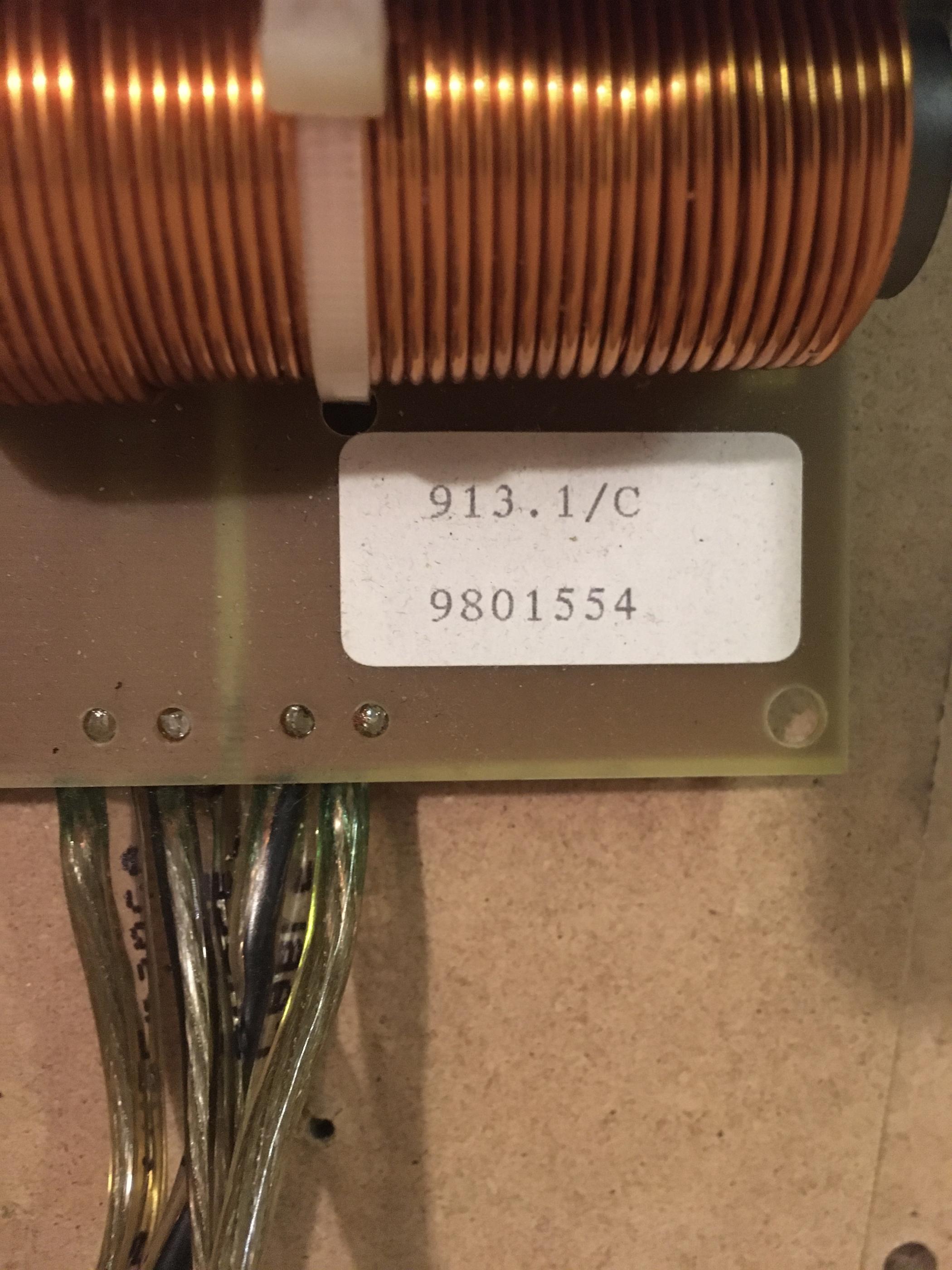

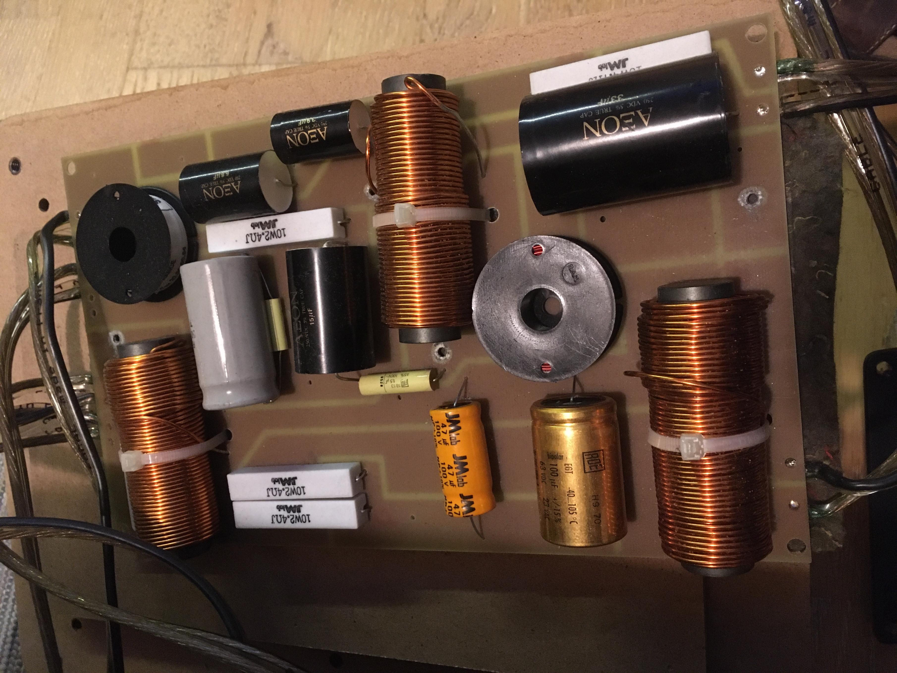

Hi again.. ok... I found that unscrewing the 6 screws from the floor you get full access at the crossover..
Now I'm having another problem... somebody modified mine and are missing some components... specially two coils.
The other components are specified in the drawing that Stony uploaded.
