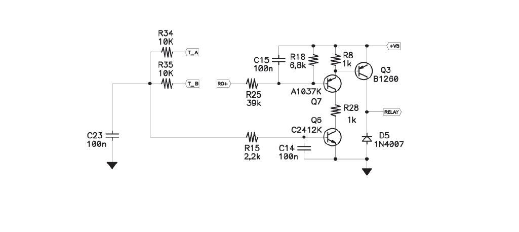

Okay. Issue was in a bad D215, 1N4744 ZENER Diode which is tied to pin 5 of the IRS and Tip41C transistor. Changed it and it works now, but the relay won't engage. Tested the relay manually and confirmed it works.
Q3 - which suppose to engage the relay (it's a 2sb1260) tested fine but something else is not ok in this circuit:
Q3:
B - 11v
C - 11v
E - 0v
