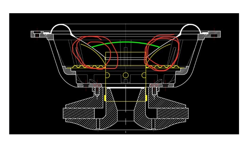

Do you really think that I would put a complete and accurate drawing online ?kravchenko_audio, what are those appendages from the spider all about?
Most of it is, not all of it is. I need to keep some secrets no? I do not have a regular paycheque I have contract work.
We as true detectives are not so easily fooled... Mark started with a strong curvilinear cone profile and then discovered the cone did not fit the chassis... The drawing shows the part of the original cone Mark forgot to erase.
Huh, well I'm not buying it!
I think they are part of an intermodulatory resonance suppresson. Doped with a polysaturated quasidistortinated fluid that distributes the destructive waves into oblivion. Hence reducing all harmonic motion and creating a subnewtonian waveguided resonance destroyer.
Sorry buddy, your secret is out!!
