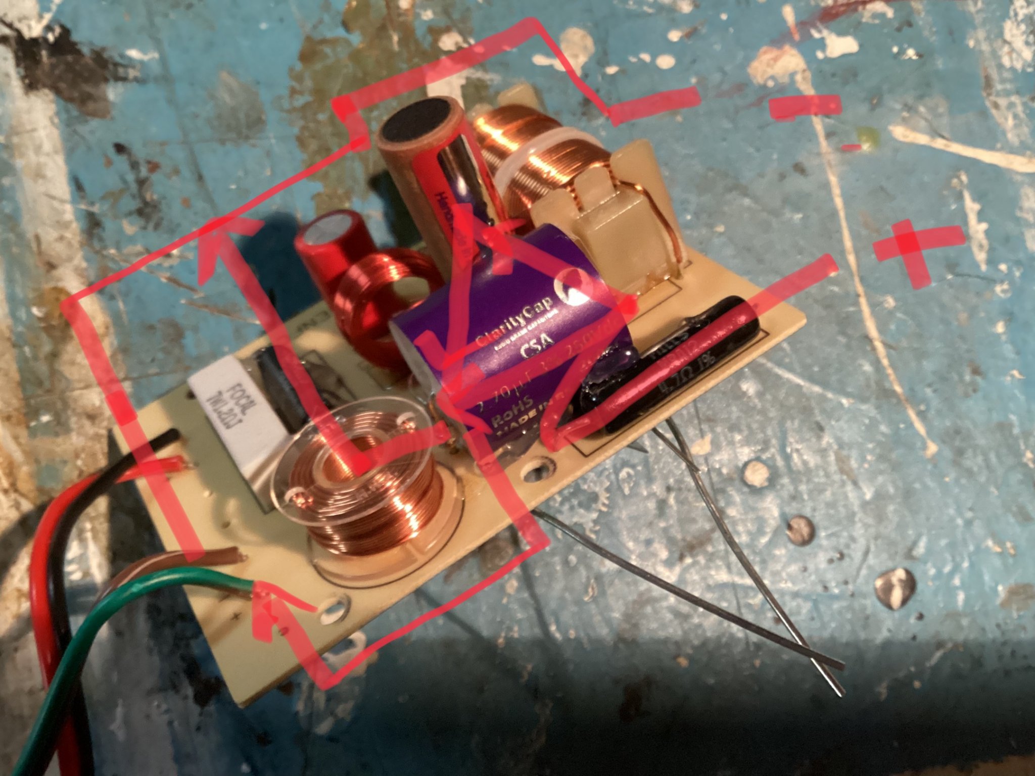

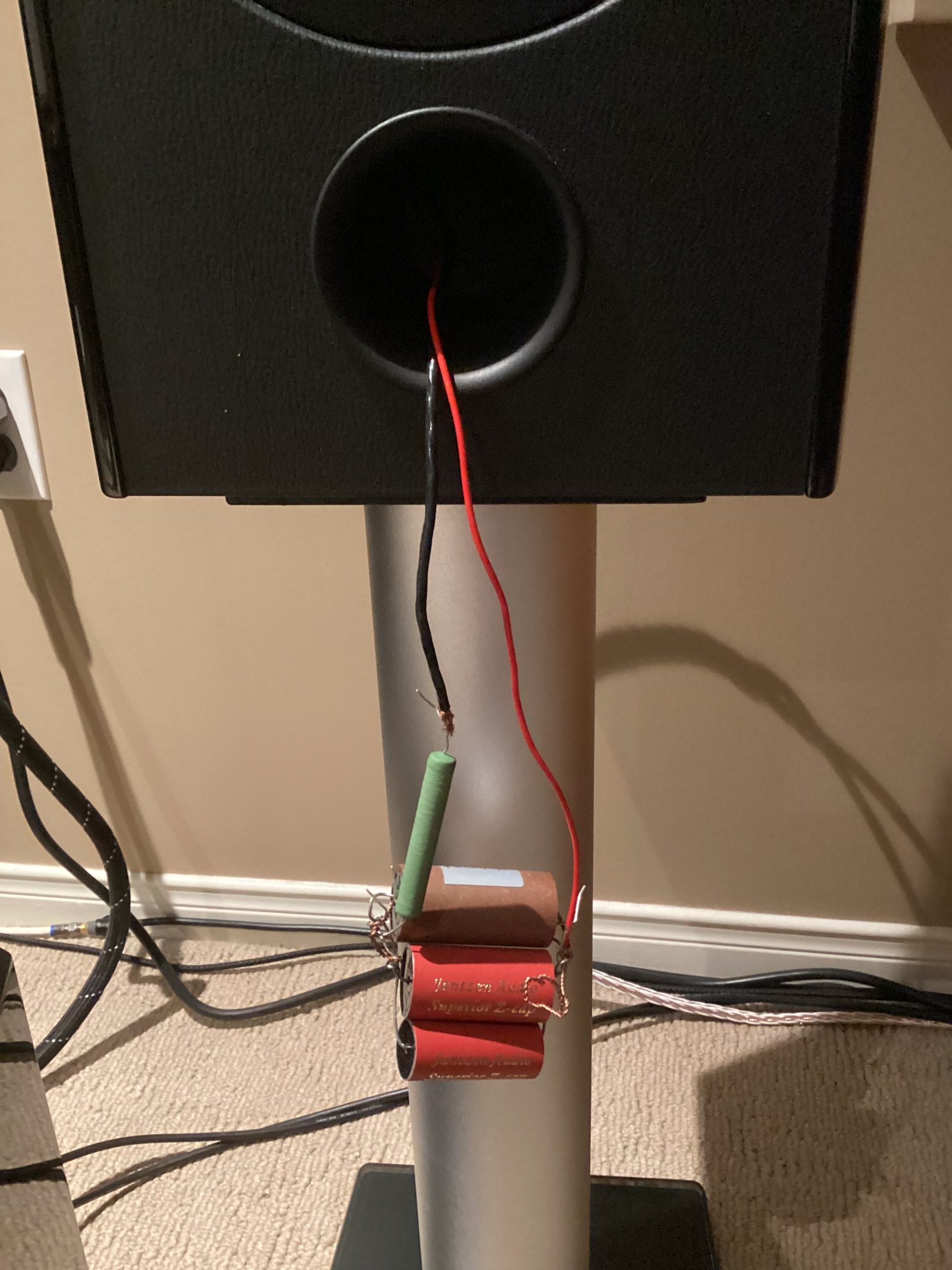

If you have taken a similar journey, please share your experience. Here are before and after photos …

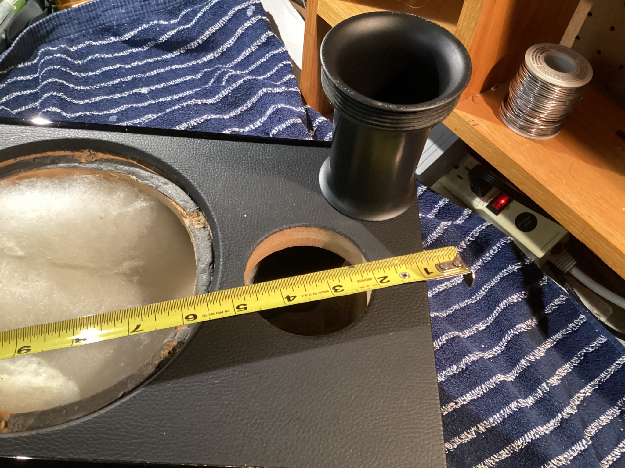

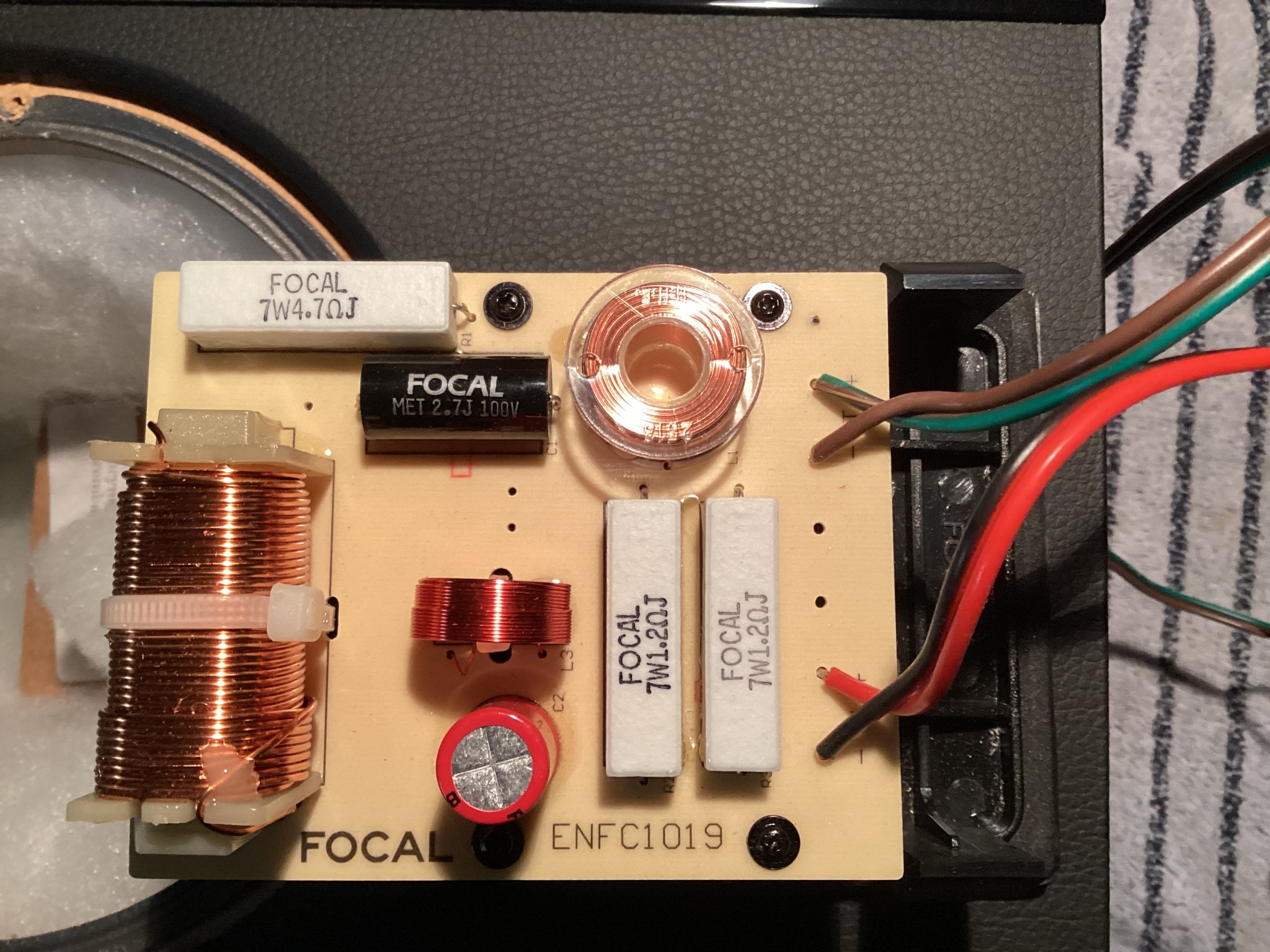

I‘ve experimented by tweaking the capacitor and resistor value. I settled on just changing the resistor in series with the tweeter. Went from stock 4.7 to 4.3 ohms. With the upgraded crossover components there is no point continuing to downplay the tweeter volume.
