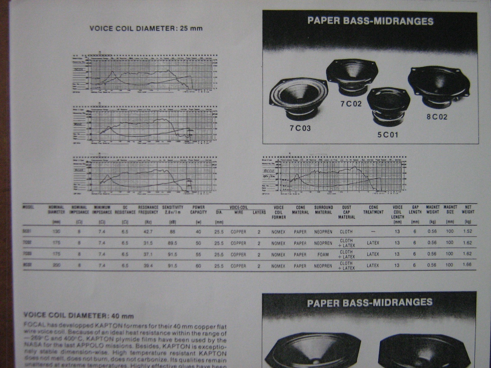

I have a pair of these (along with 2 other driver pairs that I think were intended for a 3-way speaker) and am trying to find info about them. T/S or other specs would help. They are 6.5 or 7" drivers but other than that I've got nothing. There is little on-line. I've contacted Focal directly but don't expect to get much from them. They have 2 sets of wiring posts almost as if they have dual voice coils - I'll figure that out soon. I'm re-doing the surrounds (foam was shot) and would like to experiment with them in some kind of multi-way box. Thanks a ton for any info you all can provide!
