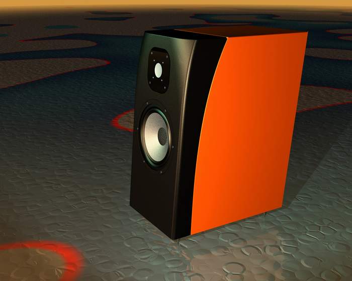

I build an all Focal monitor a couple years ago with a massive enclosure featuring a cast baffle, with a kevlar 7" and Focal tweet.
The crossover was quite complicated using 18dB filters and was develloped using Clio/LSPCAD.
But YES, they sounded very transparent and reveiling without being bright, and only because I went fullrange I gave them away.
Greets,
Oliver
PS picture attached is a raytracing, but that's how the loudspeaker looks
