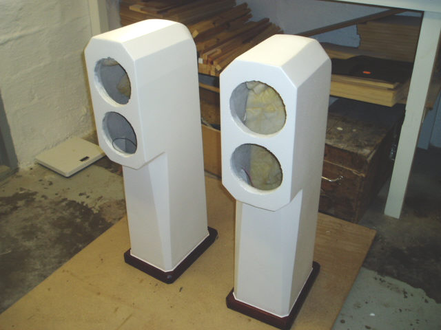

ScanSpeak project:
My other project is basically a modification of attached image - concrete loudspeakers that used to be quarter wave resonators, now reflex.
I purchased the elements too early, so I did not get into the slitted bass elements. I worked quite a bit to get them to fit ... it is rather tight - had to use a milling machine on the tweeter "reflector" and cut away some of the 18cm bass elements edges 🙂.
The tweeter is a 2905/990000, the bass elements are from memory 18W8546 as they fitted the volume at hand better.
Petter
