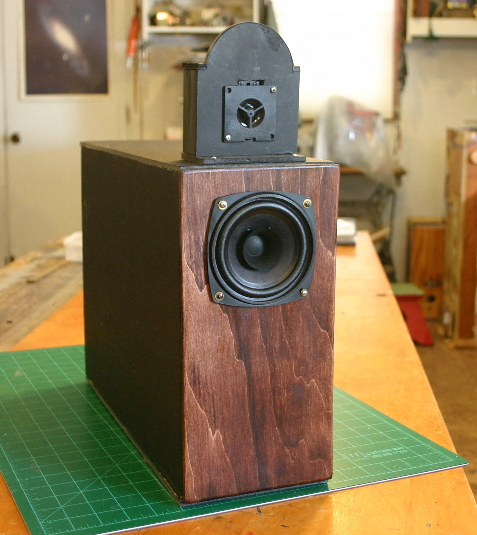

This is the completed Tunnel Reflex hybrid. The front panel is 1/4" plywood glued over the foam front panel for rigidity and provides a better material to anchor the driver. The tweeter is housed in a foam box with the crossover cap and a SPST toggle switch so I can do both full range and two way testing, as I intend to try other drivers in the reflex. The sound is fantastic for such a small drive. The bass is more than adequate and the mid-range is superb. I think this size box is about the limit for this type of foam board. If I build any larger enclosures I am going to try the 1/2" insulation foam.

Fantastic job! I really like the plywood suprabaffle. Looks great and it sounds great too I bet. You have given me some ideas for the next driver to try. How does it sound without the tweeter? Can you tell me which tweeter you are using and the cap used for the xover?
:cheers:
Sounds like you are enjoying your foam core creation though. Oh, and can you show us the dimensions or plan for your box, maybe more detailed internals photos?
Thanks,
X
he tweeter is a 3/8ths inch dome bought from PE in 2004. They had trailer loads of Delco and Nissan car speakers on sale and I bought 50 of the tweeters for.50 each. They are housed in a metal frame and work well from about 5K up. I've used them in many projects including a line array featured on the cover of Audio Express in, May, 2008. The cap is a 4.7uF. without the tweeter you do lose some higher dimensions, especially on orchestral triangles, bells, ect. Most people would be satisfied without the tweeter. The external dimensions are 16 in D, 12" high, 6" in. wide.

Really nice loo, where you always planning on adding a tweeter, or it was an afterthought?
I pre-tested the FR 10 in a .4 cu ft. box and found liked it better with a tweeter. At my age, I need all the highs I can muster. It has a toggle switch so I can test other drivers with and with out the tweeter.

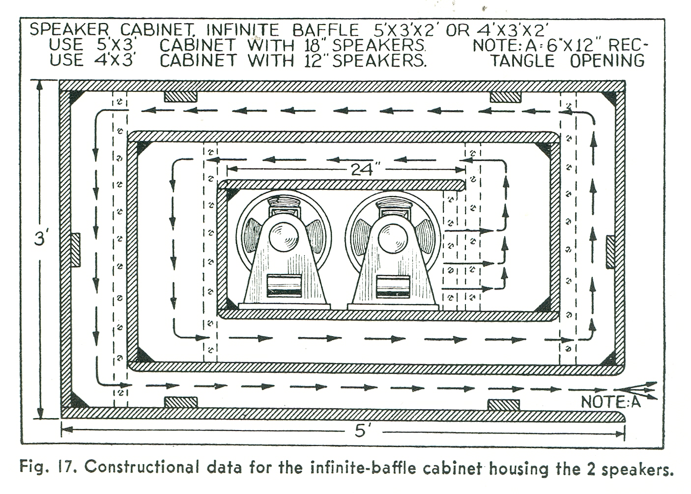

The attached would be a real challenge to build in foam or any other material. It is from an article in Radio Craft Magazine in 1938. They call it an infinite baffle but it looks like a labyrinth and the sound path is over 30 feet long. The two 12" drivers are filed coil types.
Anybody game for this one?

I would sim it in Hornresp first, looks like a tapered TL. The WAF is terrible on this one! 🙂

Heard and seen the concept before, but how about taking it further, a single 5-1/4" woofer, and try to keep it compact by using the infinite baffle. Where could it lead? Could be the enclosure for my OB Hybrid bookshelf. I have been looking at the 5-1/4" Silver Flute for this. But, PE has a 6" Aura at Buyout cheap price, that I had discarded, as it needed a larger than what I want vented enclosure. Wonder if using the 6" in an infinite baffle enclosure will be compact enough for what I want.
As you can see, I would be game, but at a smaller scale.
What do you mean by OB hybrid bookshelf? I have been thinking of making a very low cost acoustical bandpass subwoofer with the NS6 buyout. It is a really efficient driver and in a 4th order bandpass reflex cabinet can provide a flat 40 hz to 100 hz at 87 db to 89 db efficiency with no xover needed. The design can be easily made in foam core: 24 liter back chamber with 7 liter front chamber with 2x2 inch x 8 inch long vent on front chamber. I sim'd it in WinISD. If you just need a sub, not sure if a horn or TL is needed unless you want really loud and low freq HT stuff. In which case a foam core tapped horn would be the thing to build. Lots of ideas for those in the subwoofer forum.
Is that because those drivers can't produce a wavelength that long so it qualifies as an OB?
Just askin'.
30 ft path is quarter wavelength of 9 Hz not too many drivers can hit that low of a frequency. It would sound like a big fat cicada buzzing away. 9 Hz is not even sound unless you like the rhythm of a jack hammer or machine gun.... thunk, thunk, think, thunk, thunk, thunk,.... 🙂

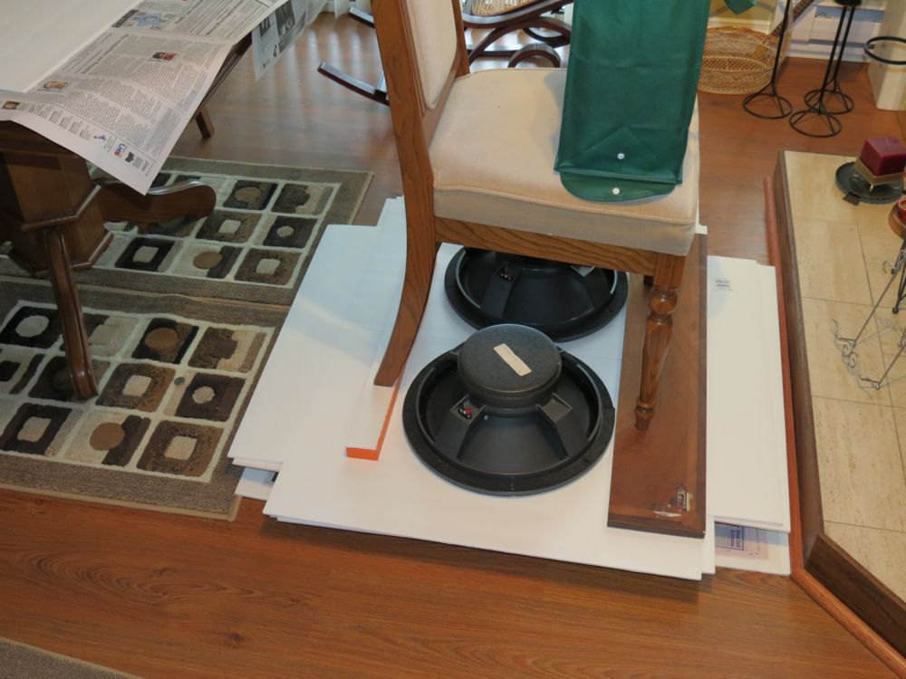

Another run around trying to find the foam but I finally found it. We are lucky that we seem to have a 1/2 dozen Dollarama's within a 30 minute drive.
Fronts and backs are double layered foam, offset to make 30" square, now gluing with the help of some 416's. 😉
I will go to the repro place tomorrow to enlarge my drawing.
