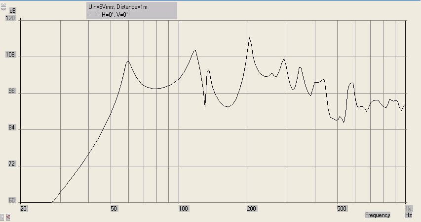

here is my plot on Hornresp. its simmed using an 8inch papercone driver from Jaycar. $40 a piece. i have a pair of "tornado" drivers that physically look very similar, but i will only use them to test the horn, then buy the drivers it was designed for if it sounds good.
the grey line on the plot is a single SS15 sub running on 1w as a comparison for frequency response.
what do you all think? am i heading the right direction?

im yet to draw it up to see how much space it takes up, but i have this vision of one wide, tall but not deep(front to back) sorta like my little laptop horn but stood up, with two 8inch drivers, one on each side, and the four little 2.5inch drivers from my first horn directly above the 8's, with a tweeter on top of it all. having the mouth of the horn firing straight up the wall.
also, this could very possibly get built using foam core. if not, ill have to take it away 🙁

Looks like you are getting pretty handy with hornresp. Neat idea, you and Melotheory ought to get together - he likes big wall blow your face off speaker installations. My only comment is that with an 8 in driver, you should be able to get down to 40 Hz, maybe tweak the tuning length of horn? Looks like fun.... 🙂
