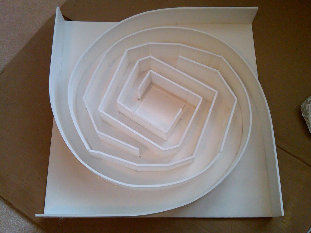

I just finished the spiral horns, waiting for glue to dry on second one. Foam core makes nice curves as I found out.

Nice work! I have so wanted to try those but thought it would drive me crazy. And you work fast too, I like that. :)
Cal, Thanks. This was fun and can be fast if you mod the design to skip the middle separator panel which has to be cut through with a thin slot to hold the walls. Since the Viva TC9FD is smaller I scaled the overall depth back to 2 -3/8 in so it has a thinner profile and doesn't need the middle brace. Not having that middle let's you bend the walls and tack in place with hot melt. I was able to do each in a couple of hours. The final gluing of the top cover with white Elmer's glue is the slowest part. I can't wait to install the drivers and hang them up for a listen. I never imagined that the Cornu spiral horn project could be this fast - it is intimidating when you look at it but is really not that hard.

It just occurred to me that if you use big drivers like a 5 incher, you will need the depth for the full sound. This can be done by hand tacking 2 horns on both sides of one panel with hole cutout, then gluing the tops and bottoms on to get 8 horns per speaker like the original Cornu. Still is faster than messing with a divider panel that needs the channels cut out. Also, you may need to use a masonite panel as foam core board is too small for 70 cm x 70 cm dimension.

Use the jpg image plan from here http://sebastian-pitkanen.blogspot.com/2006/07/cornu-spiral-copy-horn.html for your project, it should work as this was designed for 5 inch horn. Make the walls out of foam core board and hot melt glue to wood panels. You can bolt four corners for extra strength and maybe use 4 bolts with tubes where the speaker screws are. This sounds like fun and doable in a weekend. Have fun, let me know if you need more tips. I have not tried Ryno Board but it looks like it should work well as it is thicker and stiffer.

Yes hot melt glue gun with sticks. I sized the horn entrance for your driver as a 1.5 in wide channel with the depth of the walls as 3 inches. This makes the Ao equal to Sd of the driver. Three inches is not too thick and you can stick with one layer of horn channels. ::)

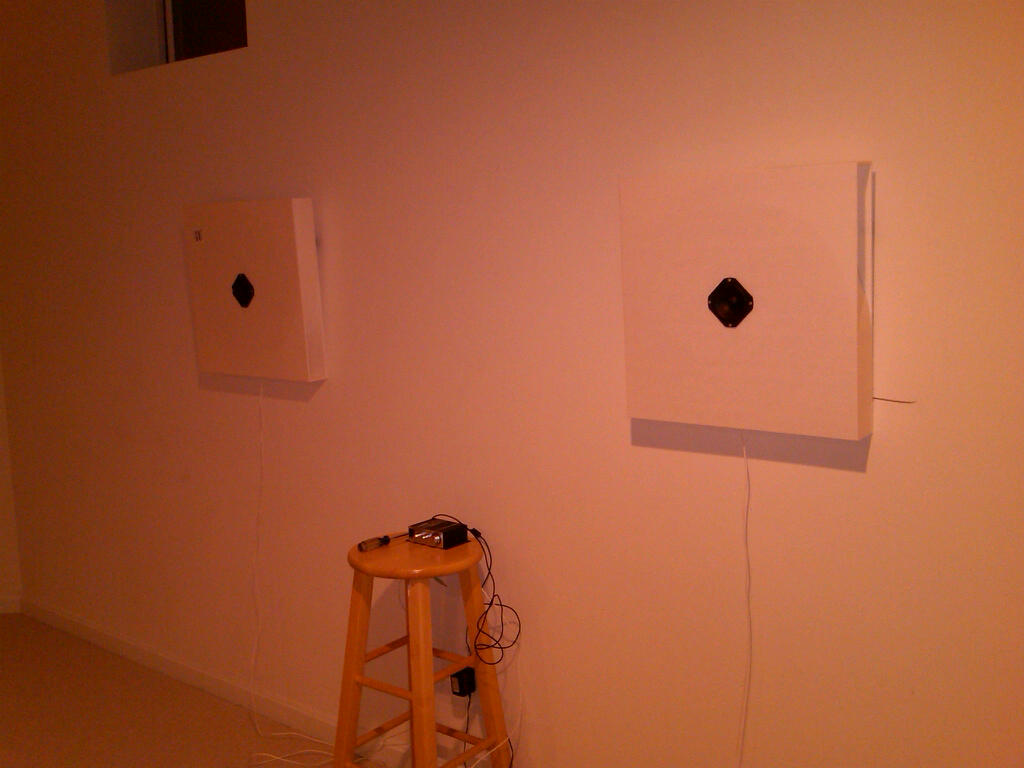

First sound from Cornu mini horns
I just had a few minutes to listen to the Cornu mini horns after hanging them in the recreation room. I was not really expecting much because when I look at the design, it just seems too open - there are all these open channels, I mean there really isn't a box that is closed. I put on Suzanne Vega - My Favorite Plum because it has a good test of the bass response and beautiful vocals. I was absolutely blown away, I mean my jaw dropped, and I have an ear to ear grin :D and could not stop listening, except that I have things to do like go to work. The sound stage is amazing, and it is so open and full bodied. Just listen to me, I sound like a wine critic describing a wonderful Petit Sirah... Put it this way, I have never heard anything like this before from ANY speaker, let alone a pair of 3.5 in drivers in a foam box. Just flabbergasted. I love these spiral horns and am a true believer now. The sound output from the horns radiates in a 360 degree pattern from the edges of the thin cabinet and really makes the room feel bigger than it is, but you do not lose the imaging because of the detail from the two point source full range drivers doing their job. You can walk around and the sweet spot is rather large. I am also noticing that they are very efficient - I am only using the Lepai at half setting and the sound just fills the room.
