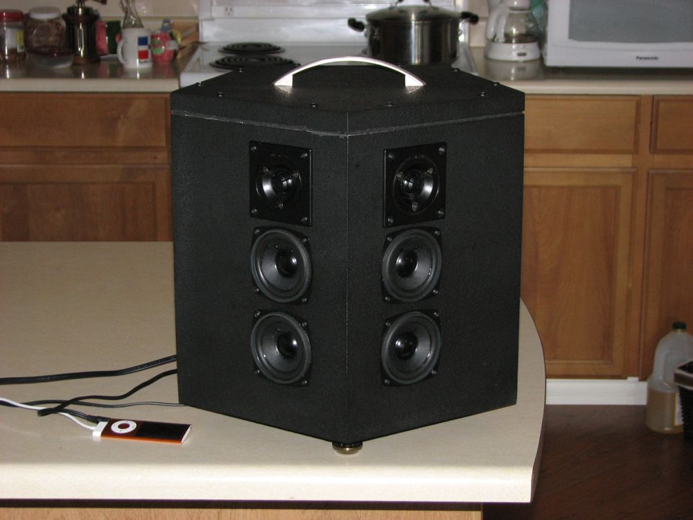

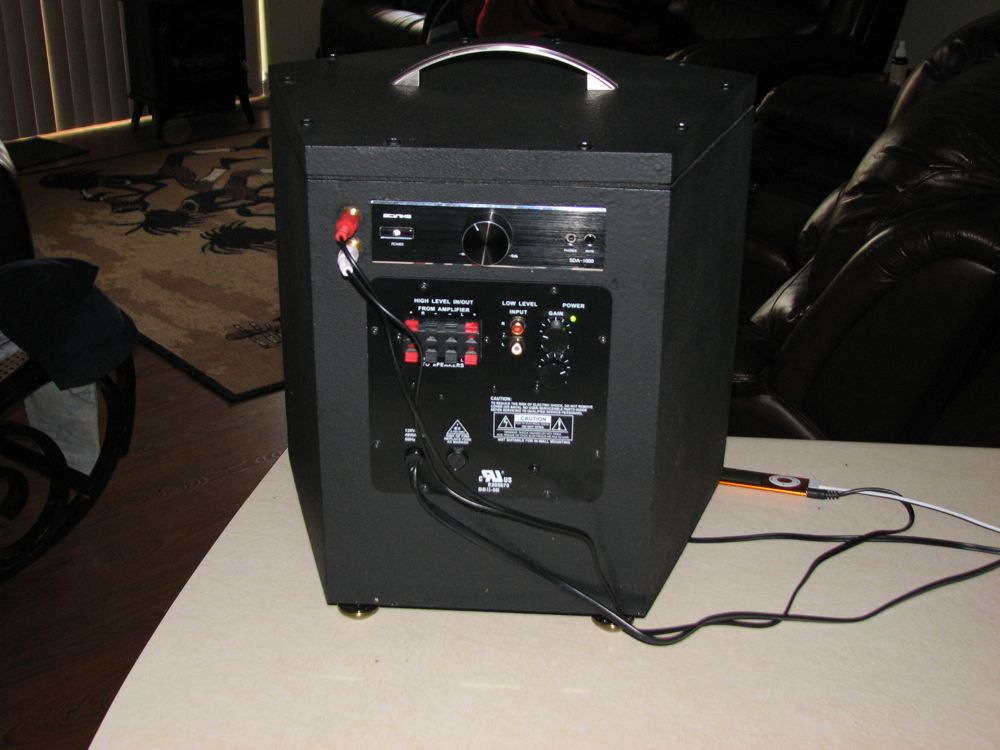

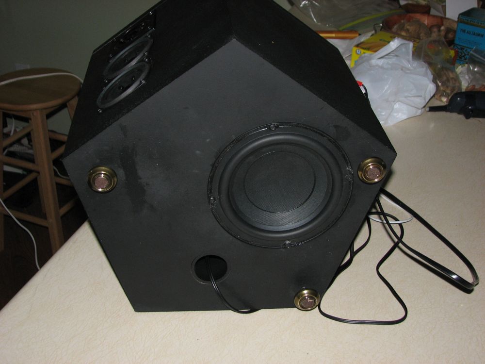

xrk, because you showed an interest, the Pentagon is a bi-amped dual chamber system with 6.5" woofer on the bottom and the 2X3" + tweeter in the front.
