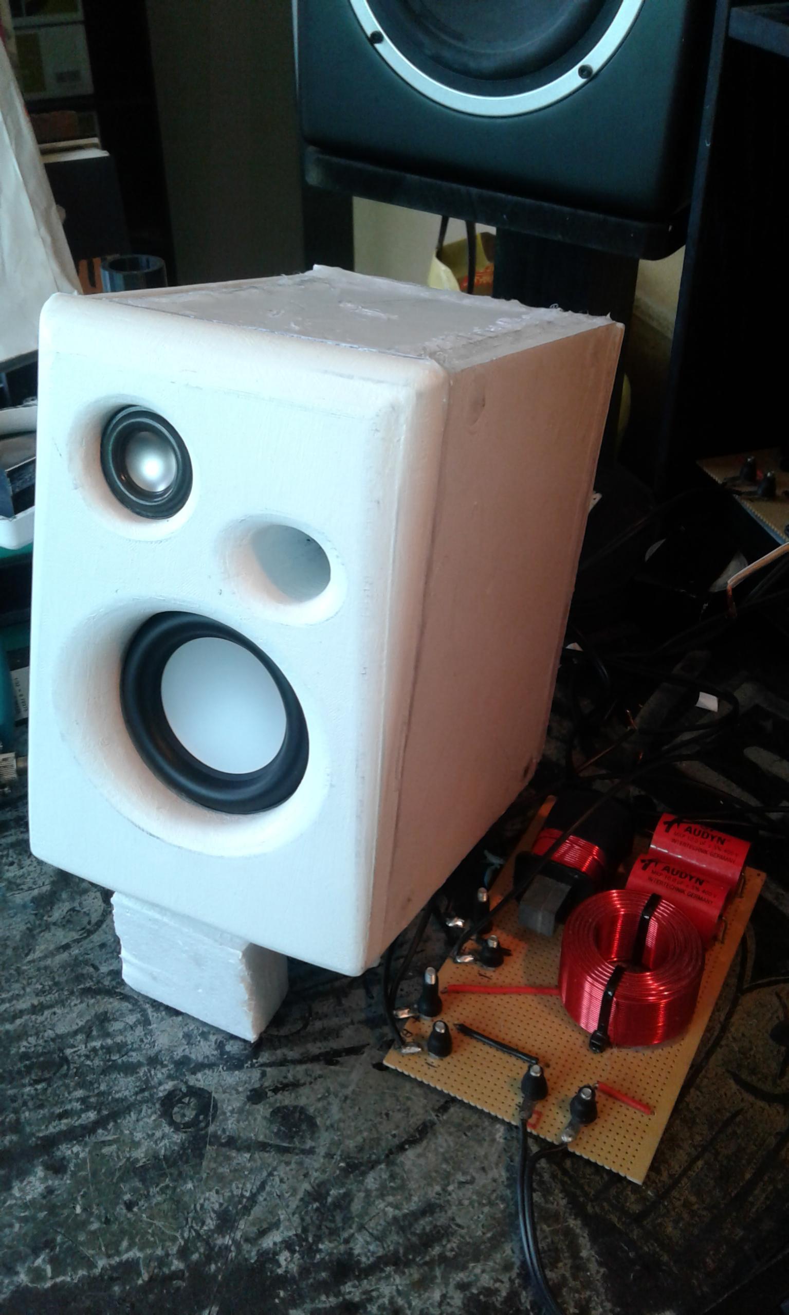

Thought I'd throw in my 2¢ with this little build. I've been playing around with some of the Aurasound drivers + 3D printed front baffles and foam core enclosures. I've landed on one design that turned out really well.

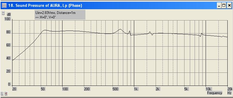

It's a 4L foam core enclosure tuned to about 50Hz, 15mm thick walls, with a 3D printed front baffle so I could try integrating the port as well as making mounting a bit easier. Drivers are crossed at 500Hz, first order on the woofer and 2nd order on the tweeter. The sim response from Akabak looks pretty OK too.
They sound really good! Plenty of bass for such a tiny footprint, mates were convinced I had a sub hiding in the room somewhere.
Will eventually build the enclosure from MDF but the foam core works wonders for quick tests!

Thanks! Yup I did, it's fairly basic and over-kill in terms of the quality of the parts used (cost almost as much as the drivers!) but it does the job pretty well.
The 3D print works great for tests like this, I've always had issues mounting drivers in foam core and usually end up just hot gluing them in which makes recycling for new builds a nightmare.
If you get the chance to give printing a go, make sure it's at a high percentage infill otherwise you get some nasty resonances and de-lamination going on around the woofers. It allows for some really cool design possibilities though!
