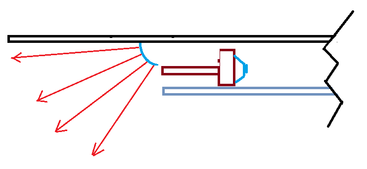

Hey Badman, can you describe the sound of the mids and above? I'm no engineer and only understand pretty limited concepts re: speakers, so these are beyond my paygrade to make sense of. Still, it seems very different from most approaches to speakers that I'm familiar with, so it's interesting to me.
Carl, I was a bit confused also till badman repeated these are surrounds. If you have been to a movie theater lately you will see maybe 10 or 12 speakers along each side wall. They are there in an attempt to replicate the enormous amount of reflected sound in real life.
In the average home that is impractical, so forcing the sound to reflect in at least two opposing directions along those side walls has become an acceptable compromise. You are correct, as badman stated, surround speaker design is almost the opposite of standard 2 ch approaches. Note my sides are not only bi-directional, but also have vertical offsets to enhance diffusion. Using the wall (and in my case the ceiling front surrounds) also allows the ambient information to be heard realistically at more locations in the room.
Mostly mid and some HF information is EQed into the 5.1 and 7.1 mix so smaller and less sophisticated drivers are sufficient - though a system with two way surrounds can benefit from having the same tweeter as the main front L/R speakers. That just provides a tonal match and as badman says, lessens the surround's potential to draw the listeners attention.
Nice work and clever idea on the roundover Mr. B 😉 Sounds like you have taken great advantage of the ability to experiment with FC.

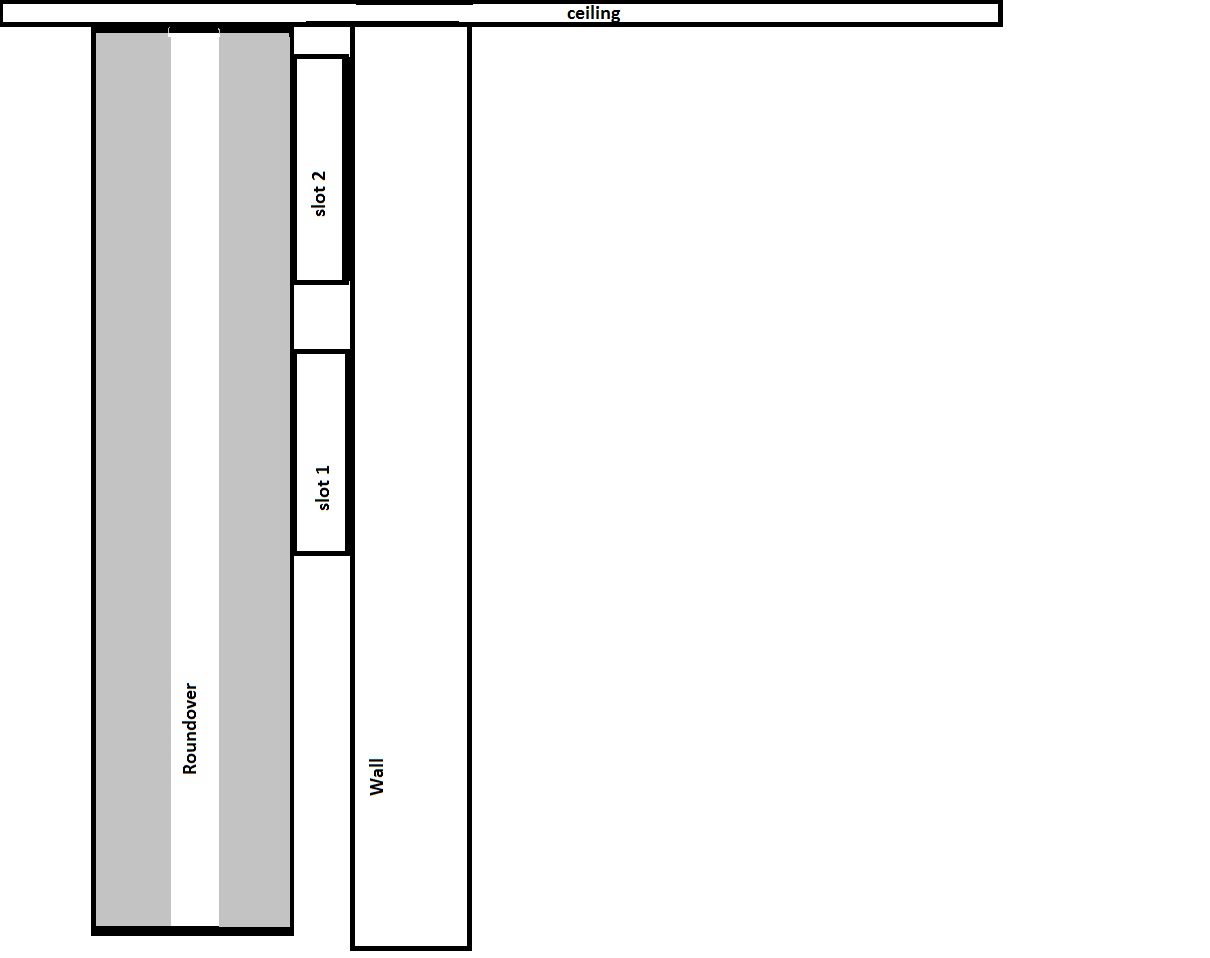

You can see here how the drivers are arranged- the slot "termination" is far from perfect, the devices are too wide to make an uninterrupted slot source. The mounting is actually done with hot melt glue- it grabs very aggressively to both the wood and the polyethylene waveguides.

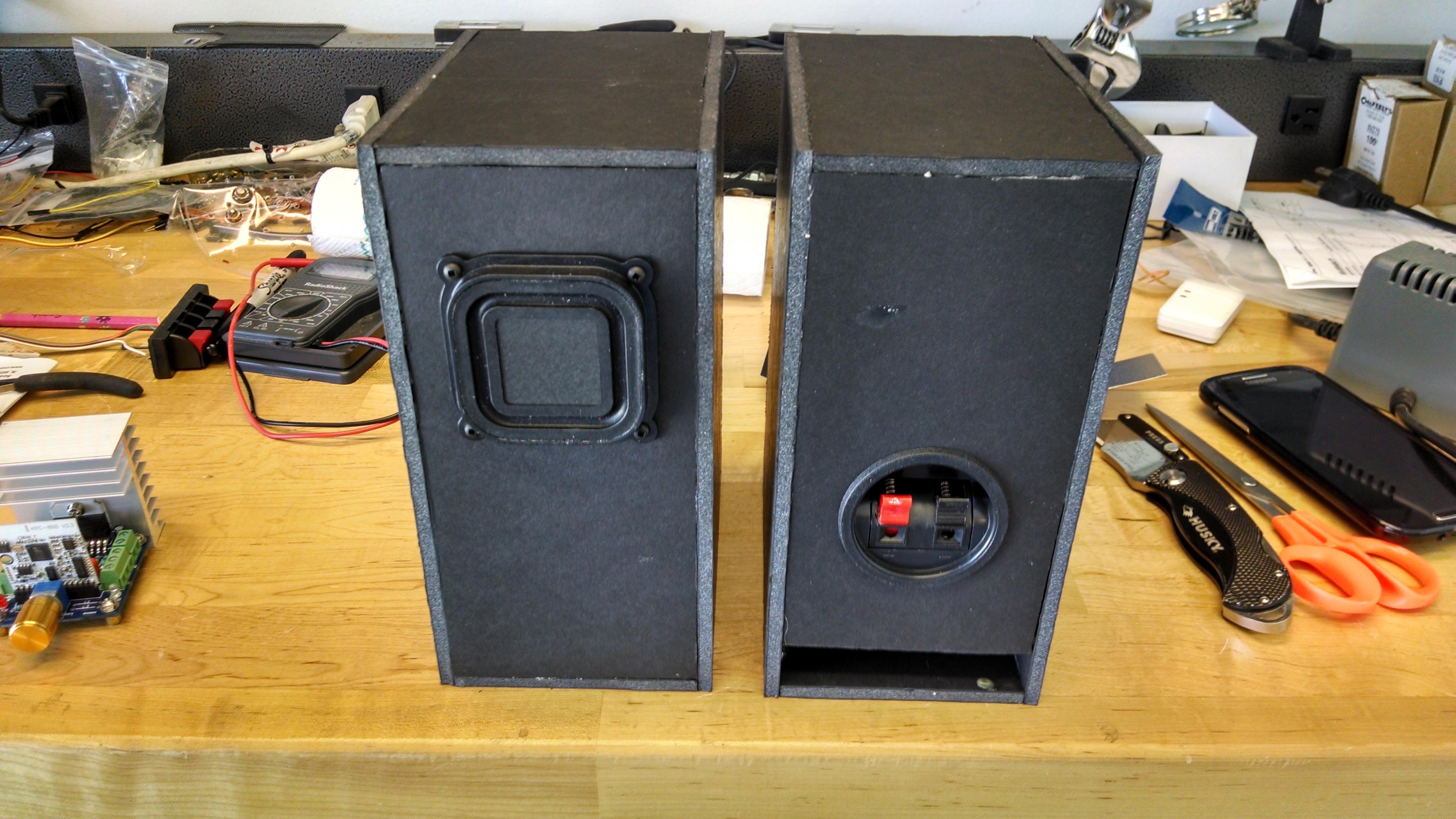

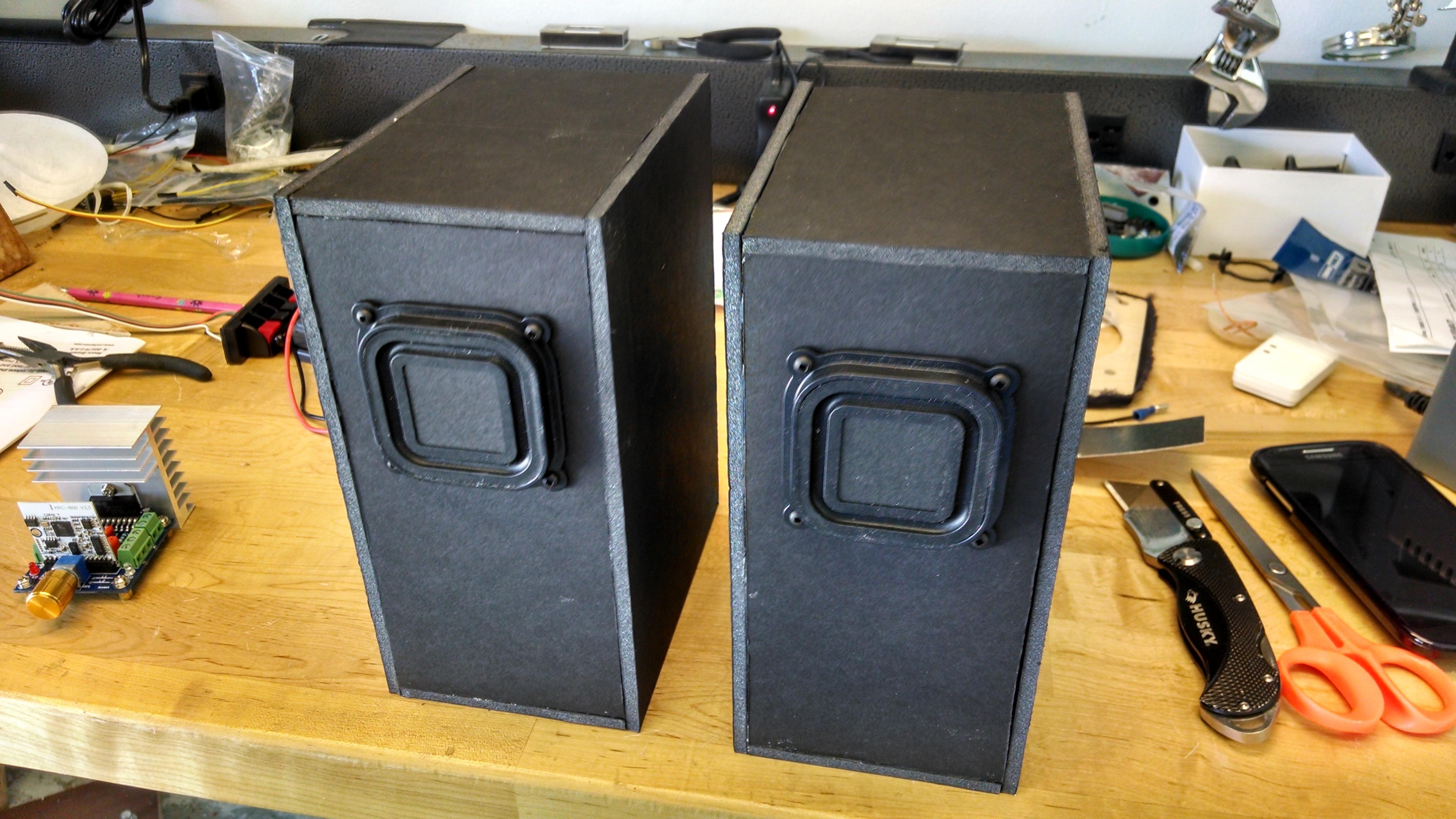

I made my first FCB speakers! Small scaled down versions of the Lance. I used some small 2" BMRs I had hanging around. Took about 2 hours total. Good first attempt to learn some of the techniques for FCB. They sound pretty good! I have a pair of the Fountek FE 85s what do you recommend?

Bkanabe,
Those little boxes look great! How did you size the smaller TL? Just plain old scaled the drawing? That sometimes works and you get lucky. How deep is the bass would be your estimate form those 2 in BMR's? Neat computer speakers for sure. I like the black foam look and glad it worked out for you. Looks kind of like the Martellos you made in the the other thread. Are you thinking of a similar TL for the FE85's? You might want to try the mini Karlsonator for those in foam core. Easy to make and big smooth sound.
Nice work! :cheers:
Just did a basic scaling and got lucky. I wasn't really expecting much given the little drivers. I have a dayton iMM-6 mic and was getting down to about 125hz before there was a big falloff. They are nice and clear. I didn't have felt, so stuffed them with pillow filling about halfway down the line. As far as technique goes, I was sealing all the inside edges with hot melt glue and also used regular wood glue to attach the pieces, but on the last side, only used glue. Do you use anything special to insure a good seal on that last piece?
I use PVA on the last piece too. Sometimes I leave a few bare spots free of PVA and add a few dabs of hot glue in addition to the PVA on the corner spots to serve as a tack clamp for the PVA to keep the lid from sliding around. I still use books to weigh it down while it dries. Cal had a technique for adding thin layers of paper strips over the PVA bead to build up the edge to evenness for final gluing.
