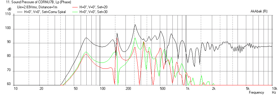

I just found an old sim I did of the FE85 for a 24 in x 2.5 in deep Cornu. One thing you have to watch out for is the possible cone excursion at low freq since this driver does not have a lot of xmax. You might have to play with stuffing of the horn mouths near the exit to reduce the midbass while still letting the low bass come out. Good luck!
