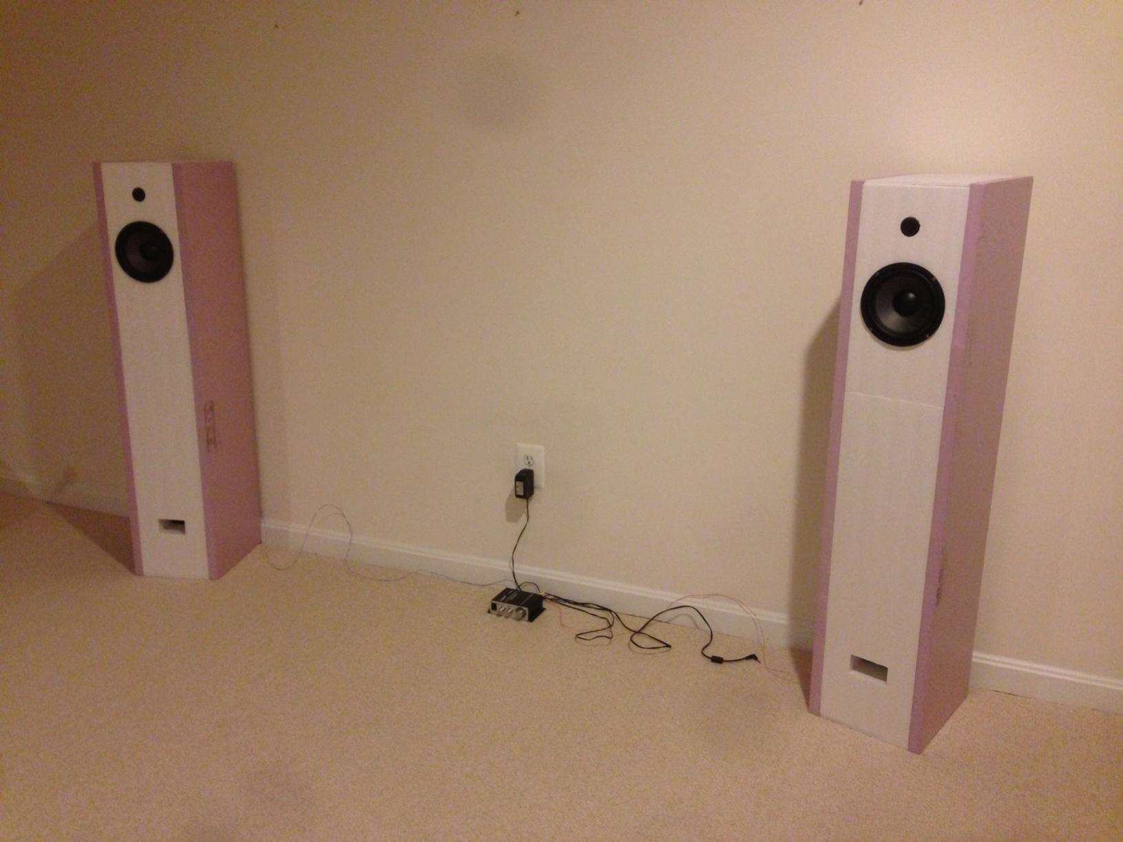

Construction of second XPS MLTL begins
I'm going to try a trick I used once before to reduce wall resonance. I put a layer of small dots of plumbers putty between two sheets of foam core bonded together with glue. I will do this for the top piece. The front where the driver is mounted has two layers of different stiffness foam core glued together with wood working aliphatic resin glue. I will add more bracing on the second one.

Am I missing something, I don't see a long board creating a transmission line in that pic. It looks like a well braced enclosure.
The TL is the 47 in long enclosure itself - there is no folded inner path. This is a straight mass loaded TL alignment where the port creates a constriction that pulls the resonance frequency lower - the analogy is added mass to the end of tuning fork to lower its resonance frequency - or "mass loading" it. Really it should be called constricted terminus TL.

XPS foam & FC MLTL with PE 6.5 in Polycone driver - Build #4 (unit 2) - Completed
I finished the second unit and now have stereo sound. Initial listening tests with the pair sound very nice. Songs with a deep bass line especially sound good. Sound clips to come later...
Here it is being tested with a Lepai amp and 8 watts is pretty loud in my rec room.
