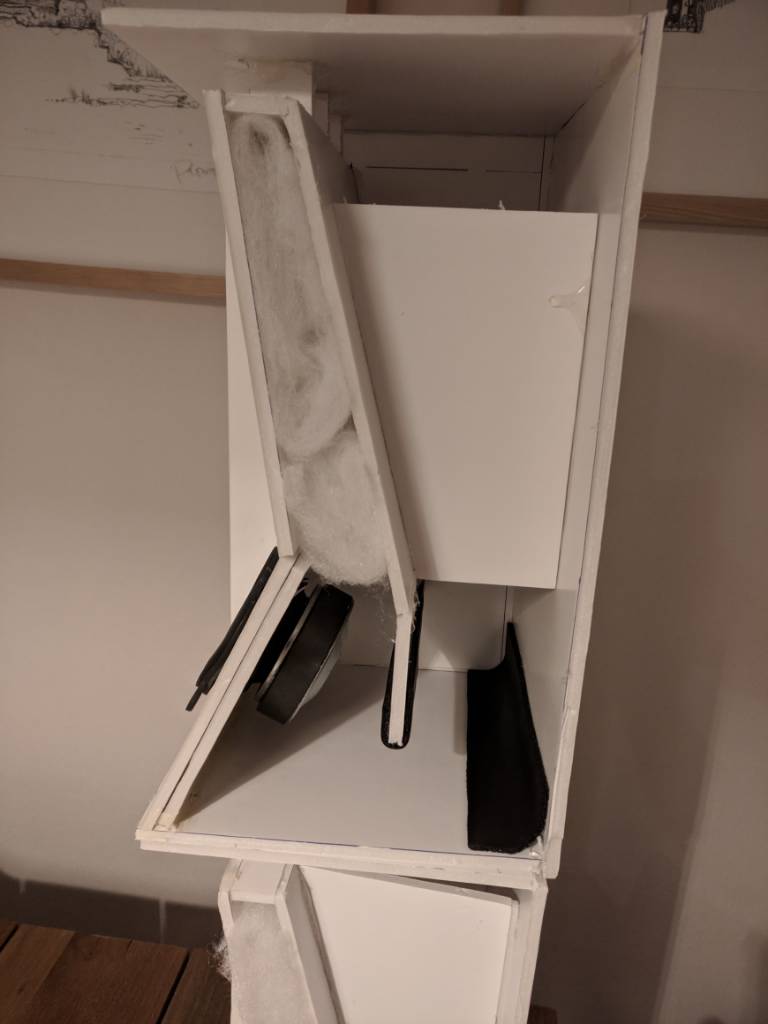

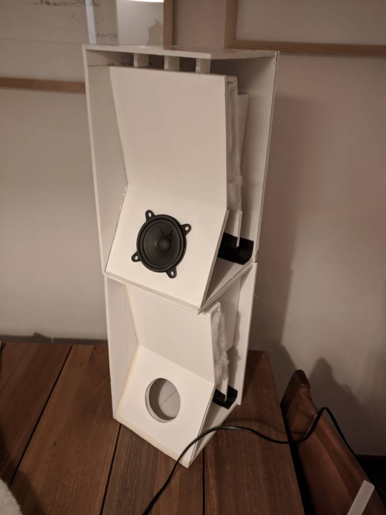

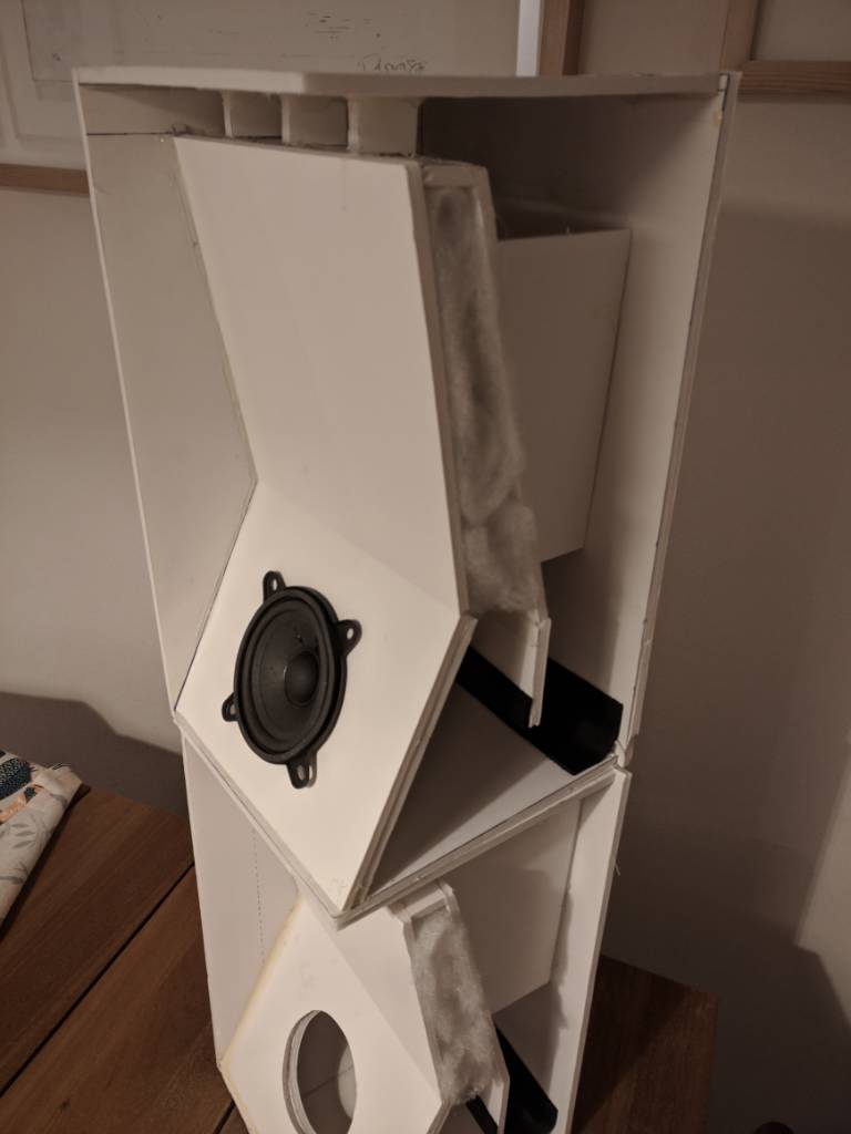

Well, I'm running it in mono without the lens, but I've got one K'Nator done, and my initial thoughts are that this driver sounds MUCH better than it did in a sealed enclosure. It sounds fantastic for a 3" driver, no doubt. Not mind boggling, but probably because it's in mono and I'm used to doing my critical listening on DML panels supported by W-frames, so maybe I'm a bit spoiled... But they sound fantastic for jazz and folk, really clear midrange and good high end extension. Double bass sounds good, but not as "there" as the rest of the band. Super sweet sound. One of my benchmarks is always how well you can hear the fret sounds of the mandolin of Another New World by Punch Brothers - great reference tune if you haven't listened to it. Anyway, a definite pass with flying colors on that. What's really surprising is watching the cone movement for EDM - almost nothing compared to how it behaves in a sealed box. I think in this enclosure, low end extension is probably thermally rather than mechanically limited. Anyway, add this to the list of drivers that sound really good in Karlonators!
Are we talking about the 3FE25-8 in a 0.40x K’nator?
Yes, sorry if that wasn't clear. I finished up one of them last night, but I'm probably going to redo it because of learning curve mistakes. Sounds fine, but it certainly doesn't look fine.

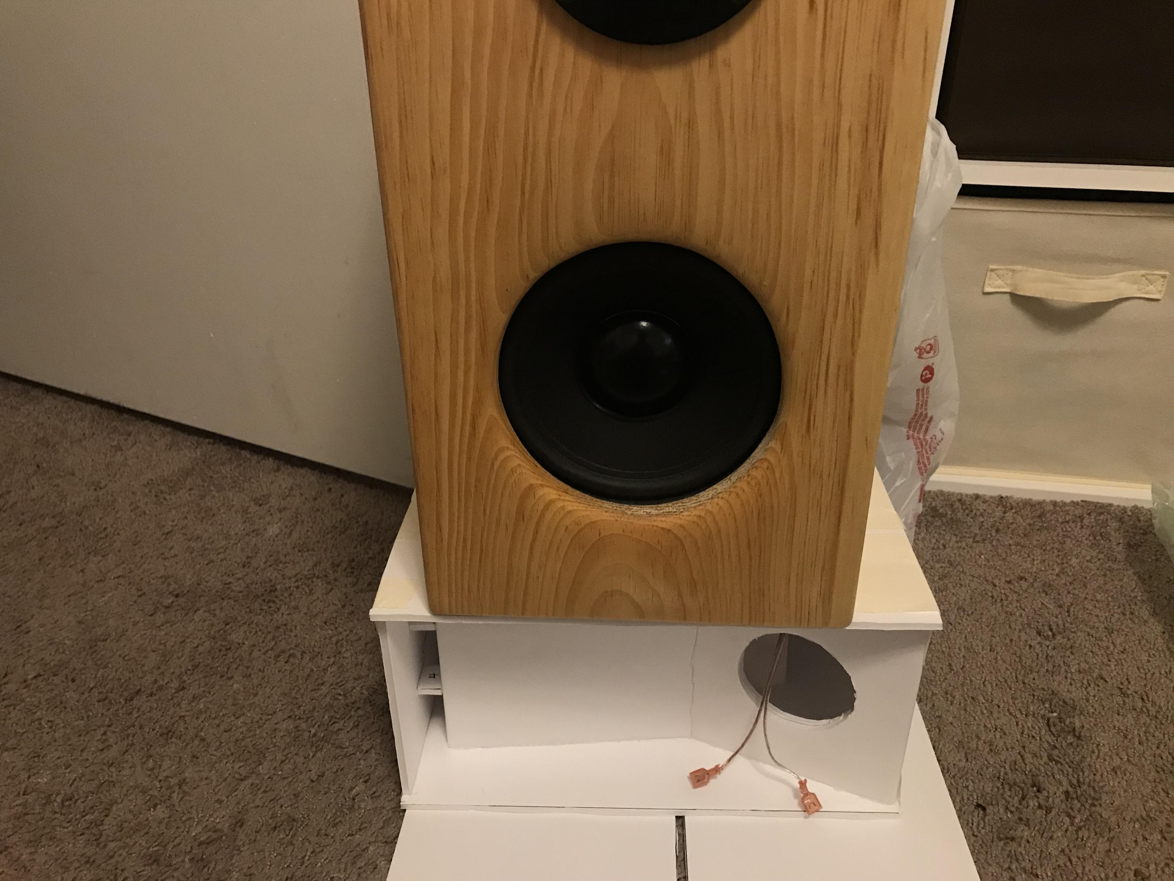

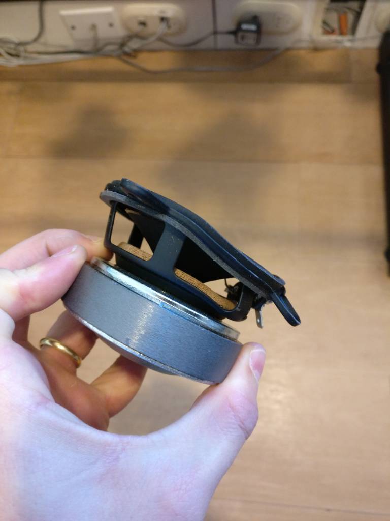

i just built my first 0.43x karlsonators with the faital 3fe25.
i can juat say it is just ridiculous the sound coming out of this things.
my cabinets are poorly made, and far from perfect. they are sealed when they need thou.
hell, even the drivers shipped to me came very damaged, and could not return them so i installed them like that.
and still... the sound its amazing. plenty of bass even. actually i am planning to build five 0.5x karlsonators with dual faitals each, built from mdf, and use them in a 5.1 configuration in my HT.
i still dont install the k lens from the karlsonator, so these might sound even better!

Great to hear more success stories of the little Karlsonators!
Be aware that several folks who built Karlsonators out of wood/MDF or plywood have reported that they do not sound as good as foam core or XPS foam. There is some nice sampling of the sound waves mixed with re-radiated sound that may be contributing to this. The complaints with wooden boxes is that they sound “boxy”. Perhaps more care with felt damping or BASF / Mr Clean magic erasers can help?
Just be cautious and make one test box in wood first before cutting all 5.

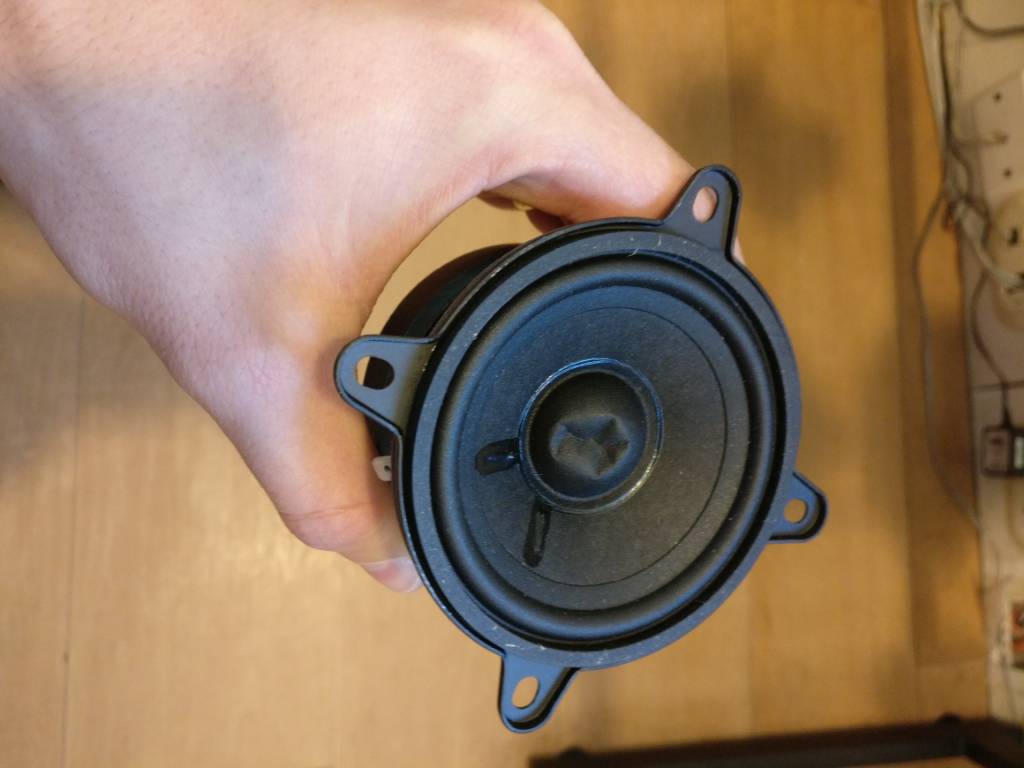

You can try using silly putty to pull the dented dustcap out. Or a small tube attached to a vacuum pump works. I have also heard someone said his girlfriend gave it a good kiss and it came back out. 🙂
