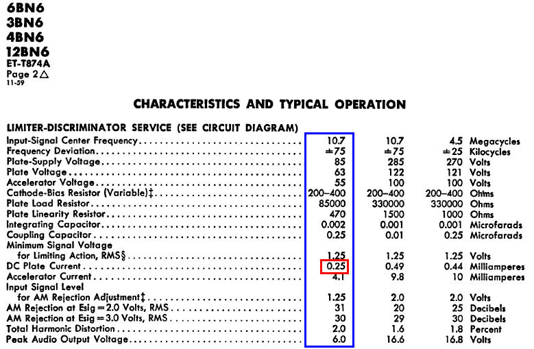

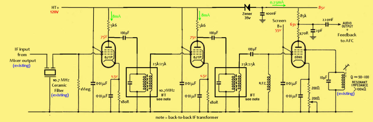

No IF-transformers are used to couple the stages. From there, it goes to a 6BN6-based limiter+quadrature detector to extract the audio signal which goes to power amp (or the LA3361 stereo decoder) and also fed back to the front end's AFC input.
So as you can see, basically i want to the place the LA1260 IC with tube-based circuit. Does this make sense? Will it work?

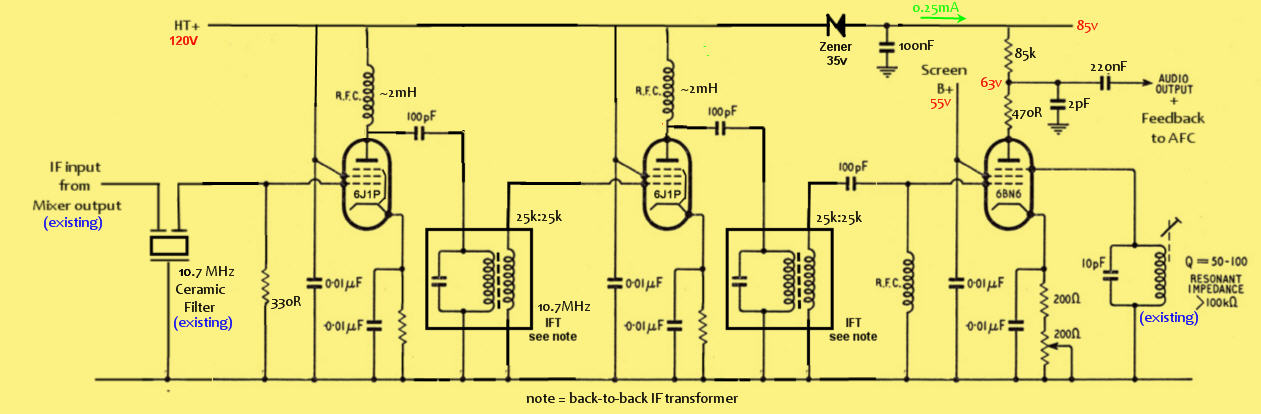

I'll start by drawing schematic then the PCB and maybe this forum can help foresee future problems from the designs.
Perhaps we can start by scrutinizing the attached schematic? Would this work?
One question, the 100pF and RFC on the 6BN6 grid, can they be replaced by another 10MHz Ceramic filter and 1Meg grid leak resistor?
Another question is the 10.7MHz IFT. Part number 42IF123 from mouser has 25k primary impedance and 4k secondary. The plan is to connect both secondaries together to get a 25k:25k IFT (one end of the secondaries goes to GND while the other end connects to each other). Will it work? Parafeed connection as shown should also protect it from HV, correct?
10.7MHz ceramic filters are usually designed to work into 330 ohms, not high impedance, so you will need a matching IFT for each. Wrong termination impedance means poor passband shape. Consult some datasheets.

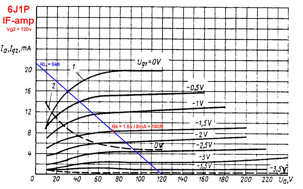

Your 25k IFT is heavily loaded by the 5k6 anode resistor. This means low gain and maybe wider bandwidth than you need. If you must use parafeed, use a choke instead of a resistor.
Why are you dropping supply rail voltage with a zener? That will effectively amplify any error.
You're right, thank you. Left side of the Cerafil is ok since it's an existing front-end. Right side will be terminated to 330R grid leak resistor, instead of 1M. I hope this is OK although i would lose some gain compared to using IFT. I read from the datasheet that at 10.7MHz, terminating with IFT is not as necessary as at 455kHz (something about spurious counter-measuring).

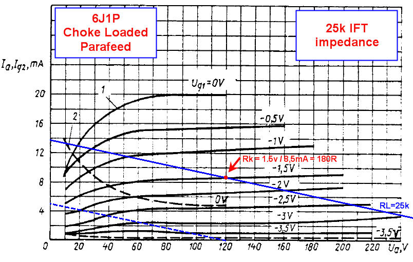

I was thinking the other way around, see attached loadline. I thought by having 25K IFT, i won't be loading the tube too much (the only load it sees is approximately the anode resistor since 25k>>5k6. Perhaps since the voltage swing is very small, i don't have to worry?
Since we are discussing about gain, is there any typical value for gain requirement from the IF strip? I'm questioning my decision of using only two pentode gain stage. As shown with the 5k6 anode load, the gain is about 30dB per stage (30V/V). So two stages as shown yields 60dB. Is this enough? I read that it's a good practice not to go over 60dB of gain on one frequency band. Or i still need to go choke loaded parafeed as shown?
I thought it would be better than a simple resistor since the current is only 0.25mA. Dropping 35V on a resistor flowing 0.25mA translates to 140k. I don't know, this seems rather unusually too large value for me. Basically i need +85v as the plate supply voltage since i'm following the recommended values found on the 6BN6 datasheet. What is best to achieve this?

This is just plain wrong. While it's possible, and even desirable, to operate gain stages with low plate currents into large load resistances, that doesn't apply to IF gain stages, whether these are hollow state or solid state. You want to maximize gain, and that means running IF amp devices hot, both figuratively and literally. You need more than 50V, and you need a heavier current to get that gm up. When working on TVs and radios, you no more want to grab an IF tube than a power tube because these will be getting just as hot.
You're not worried about harmonic distortion since you get rid of it with LC tuners and.or BPFs. Don't bother with parafeed here, unless you're using IFTs with ferrite cores, and at 10MHz, these can just as easily be air coils that don't have that saturation problem anyway.
But the 6BN6 tube that are getting low 85v supply voltage is not even an IF gain stage.. 😕 It's the quadrature detector and i'm merely following the datasheet as attached.
I also attach the revised load line of using choke loaded parafeed going to a 25k IFT. Gain is around 100V/V or 40dB. Two 6J1P stages would then give 80dB of IF stage gain. Perhaps this would be lower when operating at 10.7MHz?

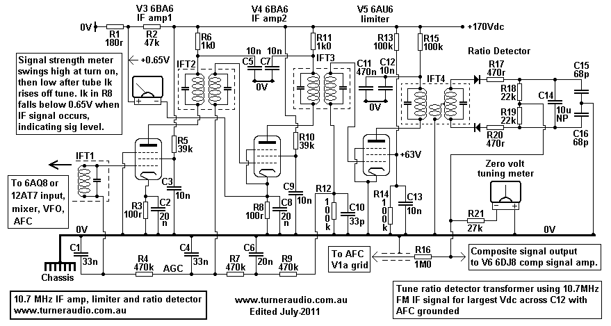

Found this valuable info from turneraudio. Pretty much basically what i'm trying to do: 2 stage pentode IF amp + FM demodulator except:
- It's using Ratio Detector, not Quadrature.
- Higher HT supply of 170V instead of 120V like mine. With the way G2 is wired i'm guestimating this translates to around 10mA of plate current, compared to 8.5mA from mine.
- AGC
- Transformer-loaded vs parafeed

Don't forget that a critically-coupled double-tuned IFT will present half the dynamic impedance of each coil to the anode, so stage gain will be half what you expect.
The 6J1P appears to be equivalent to 6AK5/EF95. This was intended for VHF/UHF front ends or 45MHz IF strips. At 10.7MHz you may find it 'lively' i.e. prone to parasitic oscillation. Better to use something with a lower grid input conductance. Whether you need AGC is debateable.
Would 6BD6 be a better choice? The turner audio schematic above shows 6BA6 as 10.7MHz IF amplifier. 6BD6 has lower input capacitance (4.3 vs 5.5pF) and lower Gm 2350 vs 4300 at the same supply voltages.

For 10.7MHz IF you need reasonably high gm and low grid-anode capacitance. Input capacitance does not matter as you tune it out with the IFT. In Europe the two popular valves for this purpose were EF85 and EF89. In the US probably 6BA6 then 6BJ6, or 6AU6 if no AGC used.ballpencil said:Would 6BD6 be a better choice? The turner audio schematic above shows 6BA6 as 10.7MHz IF amplifier. 6BD6 has lower input capacitance (4.3 vs 5.5pF) and lower Gm 2350 vs 4300 at the same supply voltages.

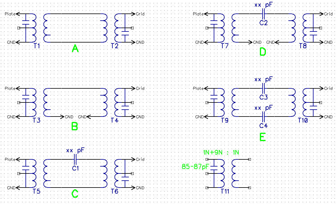

For this FM receiver project, as mentioned previously, my plan is to use IF transformers that were meant for use in low voltage solid state circuit.
The IF transformer i'm using has 10 wounds in primary with tap after 9 wounds (so 9+1). Primary is paralleled with around 85-87pF of capacitor. Secondary is 1 wound.
The plan is to connect the secondary back-to-back and parafeed the transformers from the earlier stage and connect the other end to the valve grid of the following stage.
I have difficulty in determining the best way to connect the secondaries. As shown in the attachment, there are five ways to do it. Which would be the best way? Also, what value of coupling cap if either option C, D or E is the best way?

I would use C or D. The cap to use depends on how much coupling you need. Experiment is the only way to find out. You need to try various values and measure the response. I would guess something in the range from 100pF up to a few nF is worth exploring, but it depends on the tuned circuit loaded Q and how tight is the coupling of the secondary.
