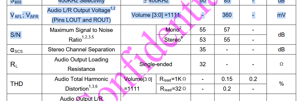

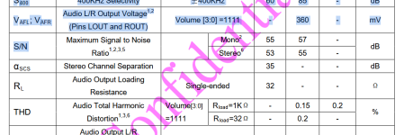

The big difference between Accuphase high end tuners and the car radio chips are the 3 key specs - dynamic range, stereo separation, and distortion.
For example, look at how poorly the RDA5807FP does here - these specs are surpassed by most low end analog tuners you can buy on Ebay for $30
These specs - 35 dB separation, 0.2% distortion, 53-55 dB signal to noise ratio are OK for cars and little portables, but not close to any top tuners made since ~1970 or so...
Also, fyi these is a DIY subgroup focused on FM tuner stuff with some designs and schematics for HD/IBOC filters, MPX filters, etc.
DIY subgroup - FMtuners.groups.io
For example, a minimum FM input IP3 of 80 dBuV would be some 35 dB too low for a car radio chip, even for dirt cheap car radios. On the other hand, the supply current of a car radio chip can be much larger than the 20 mA that this chip draws; anything that doesn't overheat the chip is OK.
TEF6687 is an example of a real car radio chip with digital IF processing. Its full datasheet is confidential, but could be downloaded from the internet anyway a couple of weeks ago. It is a chip meant for dirt cheap car radios with only one aerial input. SAF775X is a series of car radio chips for fancier car radios.
