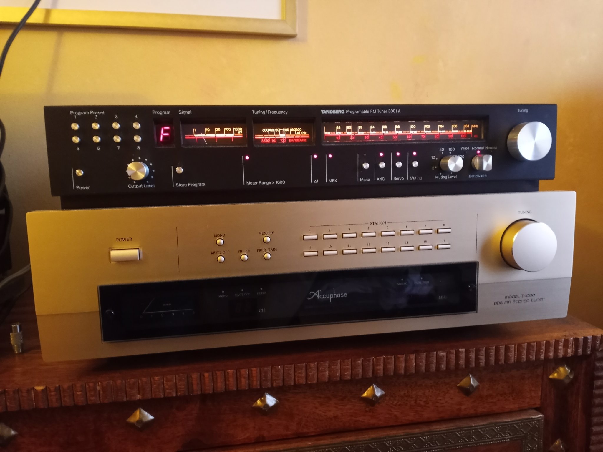

Here is my "stack" Digital Accu T1000 and aligned analog Tandberg TPT3001a .
You can see which one is in use 🙂. Accuphase is very good actually. I also played it with Abbas tube dac but I prefer 3001a for its vitality connected to old Naim amps. It's way better than Nat03 . Maybe Nat01 would stand a chance. Having said that I'm selling Tandberg since I can't afford to keep bought at the moment and it's almost impossible to find North American version of T1000 and I'm in a " gold" period of hifi . Tandbergs are fairly easily accessible just expensive to service. A top tuner. Both came from biggest collection of radios I saw. Probably all best FM tuners ever made. Sansuit TUX1 ,Squerra Ref.Marantz 10B
Top Burmester Restek FM3003 Wieschoff, and mamy many others. If I had money I'd buy top 10 of them. FM is the best audio format ever conceived..I can listen everyday, all day. Any other " perfect source" ? 2 hours max

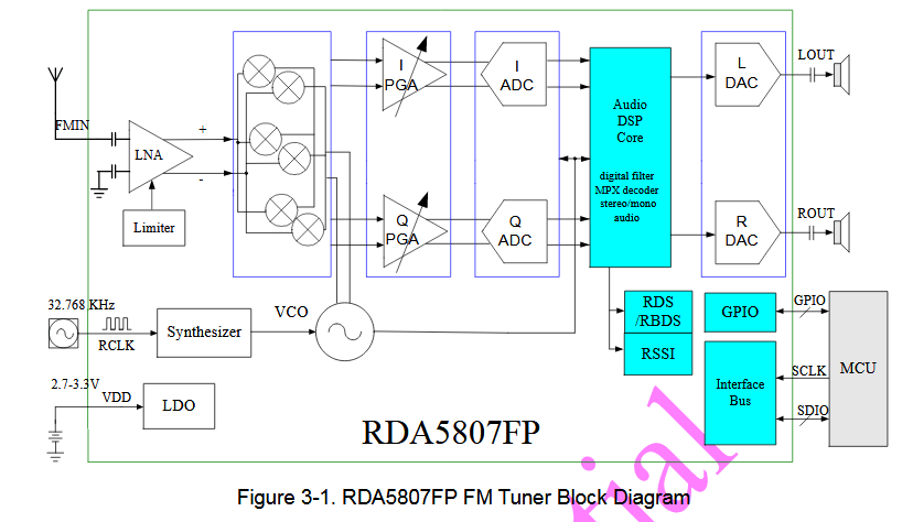

The main disadvantage of digital IF is the interference that you get from all the digital circuitry, and that you somehow have to keep out of the tuned channel.
Today's inexpensive DSP radios address this issue by using a lower IF frequency <100kHz (vs. 10.7MHz), with the DSP doing everything other than the also mixer stage. There're also some others that do not need an MCU like RDA7088. I tried one and it had excellent stereo reception with an 80cm quarter-wave antenna. but anything shorter didn't work very well (not sure why as the input stage was still analogue).
There are lots of practical reasons for using a low IF, but I don't see how it would help against clock harmonics or data-related sidebands around clock harmonics entering the RF input and mixing with the LO or some harmonic of the LO. A flexible IF does help to some extent, as does a harmonic reject mixer. If you can change the sign of the IF (switch between high and low injection), that's a very simple way to at least get some flexibility into the IF.
The way I understand it, the harmonic power in the DSP clock fades away much better when its frequency is lowered (with lowering of IF). Besides, the index of any angle modulation present in the signal also gets multiplied with harmonic order (e.g. 90th harmonic has 90 times deviation), significantly reducing the power spectral density of the interference when compared to that of the FM station / local oscillator (only slightly lower freq due to low IF).
The high-performance radios I worked on usually had a main DSP clock frequency well above the FM band, but not at an integer multiple of the FM frequencies. The clock frequency itself cannot cause interference then, but its harmonics still can when they mix with LO harmonics. Digital interfaces were another source of trouble, as interface standards then often limited the choices for clock frequencies. It could always be made to work well with good frequency planning and good shielding.
