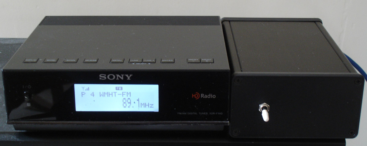

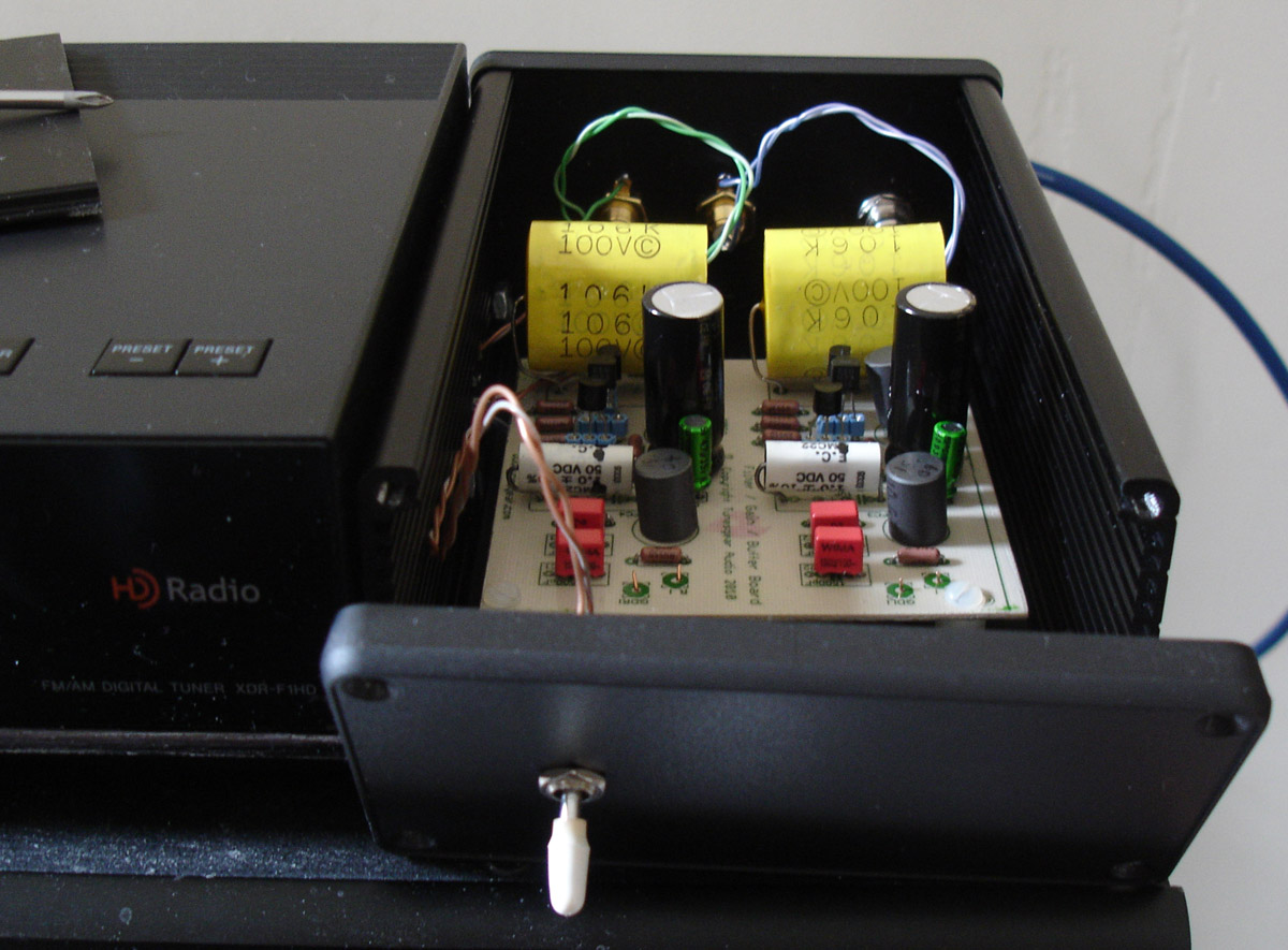

But current designs using a digitized IF, and DSP for IF filters and stereo decoding can be pretty remarkable spec wise. A good example is the Sony XDR-F1HD. I modified one of these to give it a proper audio power supply (20 VDC) and discreet output stage, and was pretty impressed at the measured performance, i.e. S/N, distortion, separation - all in analog mode, not HD. Not sure if Sony was losing money selling these new for $100, but it's really too bad they are obsolete now. With proper DIY mods, they can be really nice machines.
