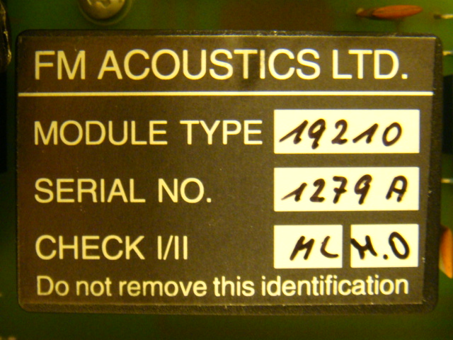

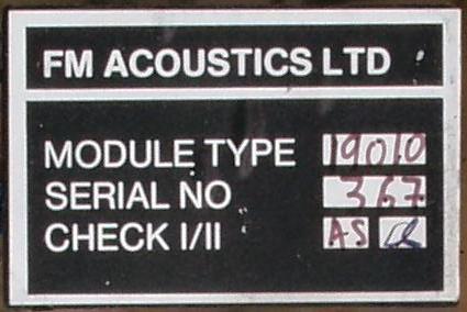

I would be willing to bet if you broke it open you would find standard transistors, maybe with their numbers removed or faces glued together to control temp matching. It's in a module box with epoxy filling for a reason. Huber just uses a lot of attention to detail; matching every part and burning every part in before the circuit is assembled. I would also bet that the circuit is not that new or earth shattering but rather standard circuit design known from the late 60s. Ray

Thank you for schematics. Does this schematic belong to the Classic or the Resolution series?
