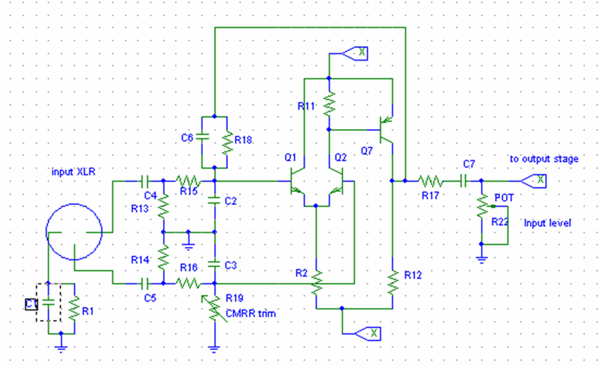

I once did some reverse engineering from some pictures - it might have errors, but check it out:

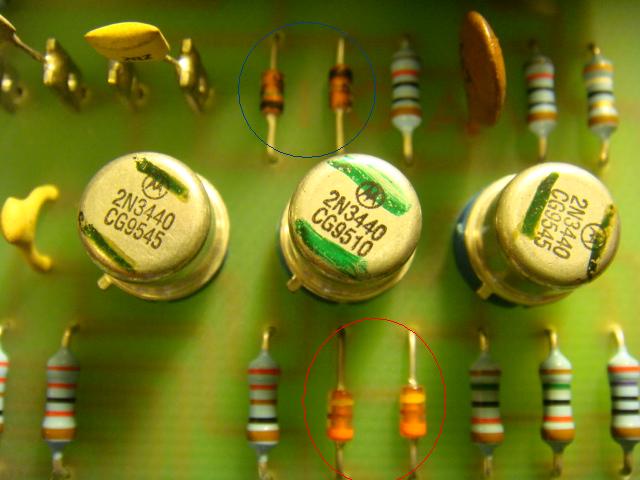

I have been looking at this design. FM acoustics uses two unusual diodes in the ccs. The color rings are orange, brown and yellow = 314 = 1N314. This is an gold diffusion germanium diode made by BKC International. What is the purpose of using this diode?
The other diodes are 1N4148 used in an other position.
They had a carton full?
Are they Zeners?
What are the specs?
Perhaps they handle more current than the usual 1N4148 or 1N914?
Maybe they look pretty?
Or are they there to confuse people? 😀
Oh wait, germanium? Different Vdrop.

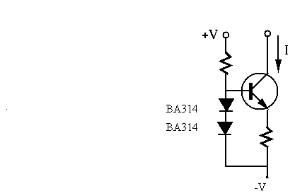

These ring colored diodes are in fact old Philips BA314, called "stabistors", only plain silicon diodes with a very defined drop, used 30 years ago for more previsible polarization of transistor class B output and constant current sources (like FM Acoustics), without need of trimming.

Those schematics look very ''English'' concepts to me. Do they have a secret UK designer engineer or something?
concerning BA314 you are right - go toThese ring colored diodes are in fact old Philips BA314, called "stabistors", only plain silicon diodes with a very defined drop, used 30 years ago for more previsible polarization of transistor class B output and constant current sources (like FM Acoustics), without need of trimming.

this diode is a low forward voltage drop and low noise diode - go toI have been looking at this design. FM acoustics uses two unusual diodes in the ccs. The color rings are orange, brown and yellow = 314 = 1N314. This is an gold diffusion germanium diode made by BKC International. What is the purpose of using this diode?
http://pdf1.alldatasheet.com/datasheet-pdf/view/155394/ETC1/1N314.html
as I know, such diodes are often to find as anti saturation diodes (shorting the recovery time in case of clipping).
Where this diodes exact located in the CCS?

Forget about the 1N314, it is a BA314 diode.
It is used in the ccs.
I found a much better data sheet where the color rings is described.

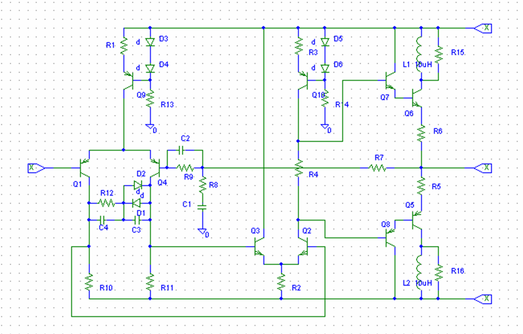

Take a look at the ouput stage diagram in post 4, why is there en 10uH coil in the collector, and what size is the resistors R15 and R6?
At LF the connection is DC to the outputs, but at HF it rises, so the connection is through the resistor. At HF is where you have problems with weird loads and parasitics... this effectively limits the current that can be drawn above some frequency where the choke starts to look like a highish impedance.
It's sort of like the output choke found in many solid state amps in series with the load.
