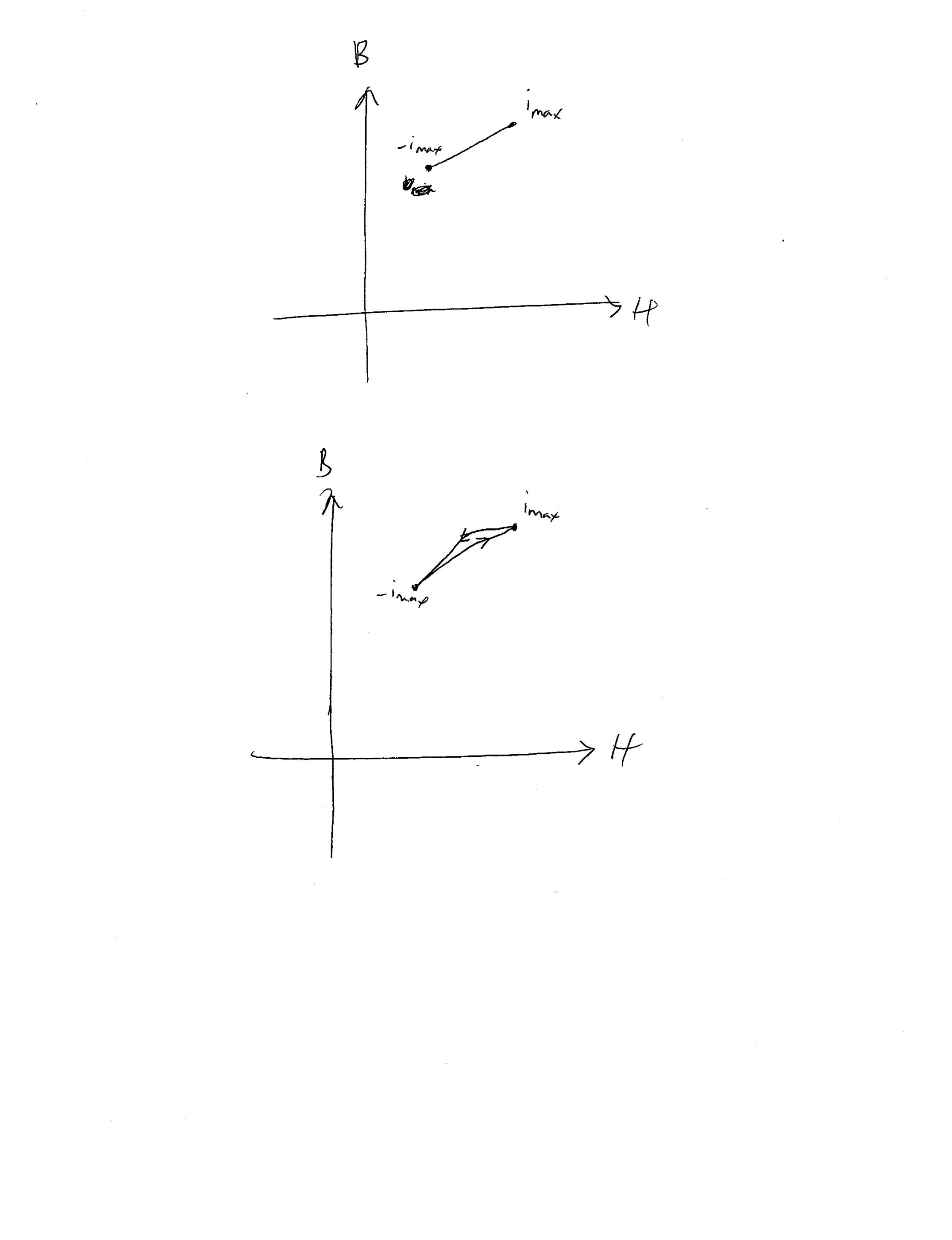

Maybe we are not talking about the same thing. I hope this makes sense. Pardon my calligraphy.

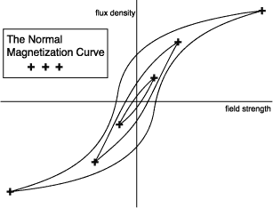

Your drawing is clear and coincides with all the other renderings I have seen of the BH curves of ferrite. Of course you only show one side of the minor loop which would also form a small hysteresis loop.
I believe are are talking about the same thing but I am somewhat dumbfounded that I have to argue that it is a hysteresis effect (exactly as you have just drawn).
Maybe as a middle ground we can agree that hysteresis requires nonlinearity (nonlinearity does not require hysteresis) and when I say hysteresis you can just think "nonlinearity".
Okay?

Why would it form a small hysteresis loop?Of course you only show one side of the minor loop which would also form a small hysteresis loop.

Why wouldn't it? Hysteresis just means there is a different curve "going up" than "going down". The graphs you normally see start at the center and swing through a broad region from saturation to saturation (hyst 1 attached) but you can swing H any amount and the characteristics will always swing aroung a minor hysteresis loop. (Hyst 2 and hyst 3).

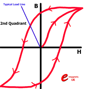

For those that haven't seen these curves before these are the basic curves of a magnetic material. H is the magnetizing force that you apply, B is the magnetizing flux that remains. The curves flatten top and bottom as a form of saturation. You can apply more H but B won't go any higher. Hysteresis means that the B drags behind as you reverse direction of H, and that is a good thing: without it a magnet woudn't be a magnet. The B point on the return where H is 0 (where the central y axis intersects the curve top middle) shows the remnance after saturation (magnetization).
This also shows how it is hard to demagnetize something. Letting H go to zero leaves the material magnetized (B non 0). You could swing H to some particular negative value, but it is hard to predict precisely what value would be required. In the end, swinging it back and forth in ever diminishing amounts will have it loop around the 4 quadrants (in a minor hystersis loop) until it converges on 0 for B, i.e. demagnetized.

Well, would you say that a Kms(x) curve exhibits hysteretical behaviour? No, you would probably say that it's merely a function which is not linear. But there's really no difference between the way Kms(x) and B(H) behave, either, since both are just simple non-linear functions as far as the driver is concerned. In order to "jump" onto a different part of the hysteresis loop, H needs to significantly reverse (go negative all the way to the other side), and such a phenomenon, as far as I know, cannot happen with a regular driver with regular input power.Why wouldn't it? Hysteresis just means there is a different curve "going up" than "going down". The graphs you normally see start at the center and swing through a broad region from saturation to saturation (hyst 1 attached) but you can swing H any amount and the characteristics will always swing aroung a minor hysteresis loop. (Hyst 2 and hyst 3).

Sorry but you totally misunderstand what hysteresis means. Any physical phenomonon that has a component that "lags behind" will have a different characteristic curve going in one direction than going in the other. It doesn't retrace its steps but always inscribes a loop when driven in alternate directions. It may be clearest to see, if you trace BH curve of magnetic material, by pushing from full saturation one direction to full saturation the other direction, but this is not required and there will always be an enclosed loop of some area no matter how small the excursion. (This was illustrated by a couple of the drawings above. They showed minor as well as major loops.)
As I said you can have nonlinearity without hysteresis but you can't have hysteresis without nonlinearity. Perhaps, in the case of magnetic material, it is the nonlinearity that matters, but it comes from the hysteresis of the material and the hysteresis is always there (for major and minor loops).
Finally, woofer suspensions usually have significant "creep" phenomenon, so they would exhibit hysteresis as well.

Have I drawn correctly what you are saying? My vision is above, yours below.Sorry but you totally misunderstand what hysteresis means. Any physical phenomonon that has a component that "lags behind" will have a different characteristic curve going in one direction than going in the other. It doesn't retrace its steps but always inscribes a loop when driven in alternate directions. It may be clearest to see, if you trace BH curve of magnetic material, by pushing from full saturation one direction to full saturation the other direction, but this is not required and there will always be an enclosed loop of some area no matter how small the excursion. (This was illustrated by a couple of the drawings above. They showed minor as well as major loops.)
David S.

Steel has almost no hysteresis. Its PM materials that we are talking about becausethey have much higher levels of hysteresis than steel. Steel hysteresisis is insignificant even when close to saturation.
I think this whole discussion is confusing saturation and nonlinear B-H curves with hysteresis effects and until this difference is sorted out these arguments will continue to no point.

I don't think you drawing was far off. I just wanted to make the point that hysteresis exists at any level and doesn't require swings with full saturation. This would give some area to a loop of any level.
