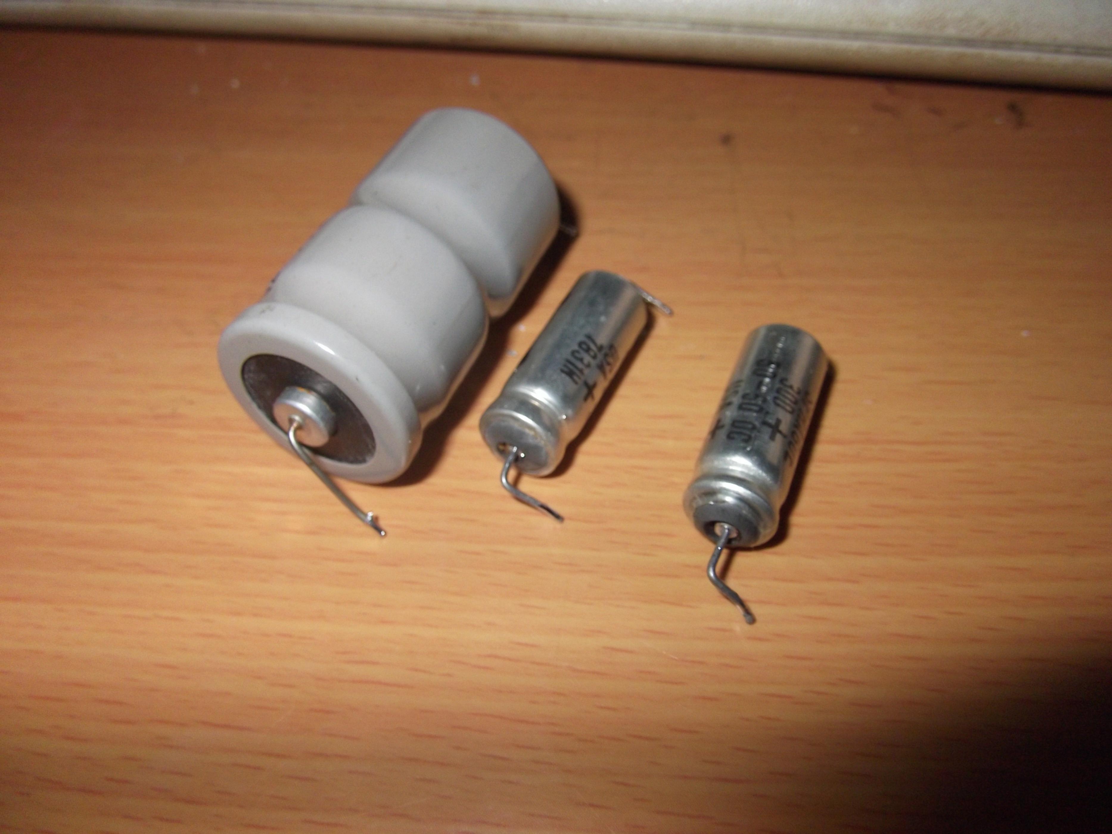

I have two of them. On both of them the range relay chatters all the time and on all ranges:mad:

My old 8800A had the chattering problem and it was two bad power supply filter caps letting gobs of AC into the system. Replacing the caps fixed everything.

I will do what the vintage radio guys call a re-cap on the power supply. I did measure the voltages and they looked fine. I suppose i could scope them and find the exact one though.
Cheers for that. Now i know.
Here are the culprits.
Both of my 8800As are now awaiting spares.
I have seen light on both of them with capacitors that don't fit very well just to check that it is indeed worth ordering the parts.
