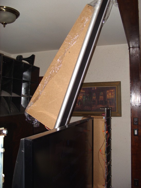

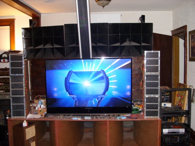

What do you do if you found a 'one-of' ESL panel ( a FINAL PANEK 300 in this case)?
Well you could fly it vertically above the TV from ceiling !
Left & Right ESL's are highly modified KOSS panels (details of this modification will be in a post Friday)

So how does it sound that high above the screen? Does the center dialog remain anchored?
Are you doing anything to mitigate the rear wave from the panel?
More pics and info would be cool ...

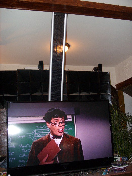

Just by coincidence I had added Martin Logan style tapered baffle wings yesterday
Now much better integration with Sub at 80 hz X/O. Electrostatic bass is the best
even if it's above 80 hz
The FINAL Panek 300 suspended from faux beam & tilt angle aims to listening area
