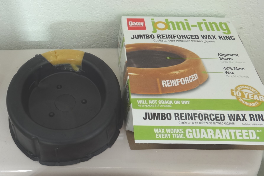

I had the chunks of cut-out from my 18's, so I decided to try a rudimentary flower baffle on an fe103en.
The Edge says I should get a nice null between 1 and 2 k, with a circular baffle. I was hoping the petals would defocus the circular edge effect.

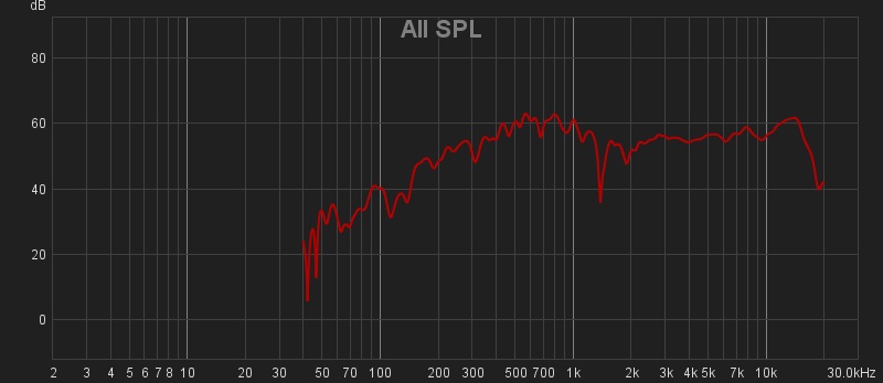

Measuring indoors with REW (using the frequency dependent window option checked), I get much less "sharpness" in the null.
Is this because of the flower shape, or the frequency dependent window analysis preference?

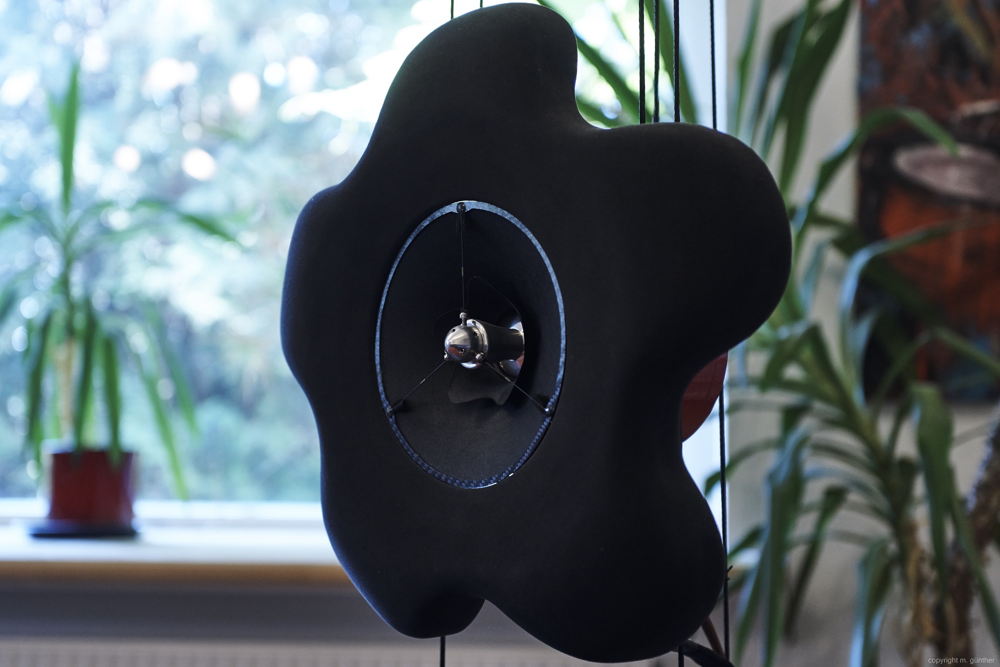

The reason behind the flower baffle is of course to have different path length from front to back, in order to "smear" the geometrical resonance of a circular baffle, while maintaining symmetrical directivity vertically and horizontally.
Sorry to say that the path difference in your experiment is quite small, so the difference between your flower and a circular baffle might be difficult to measure.
But it´s of course an interesting experiment. I may suggest to have the sharp edges well-rounded as well, and have the difference measured...

Ok, I put the flower baffle atop a 35" stand and set the mic ~1M away, on a tripod 45" above the floor. In the middle of the room. Using the frequency dependent window option checked. Here's what I got.
There's still the dip as predicted by The Edge. If I were to do over, I'd have offset the driver to help mitigate that.
The ratio of this flower petal baffle to the driver diameter is perhaps excessive; It may work better with a larger speaker. I have 5"s and 8"s to yet model and try.
