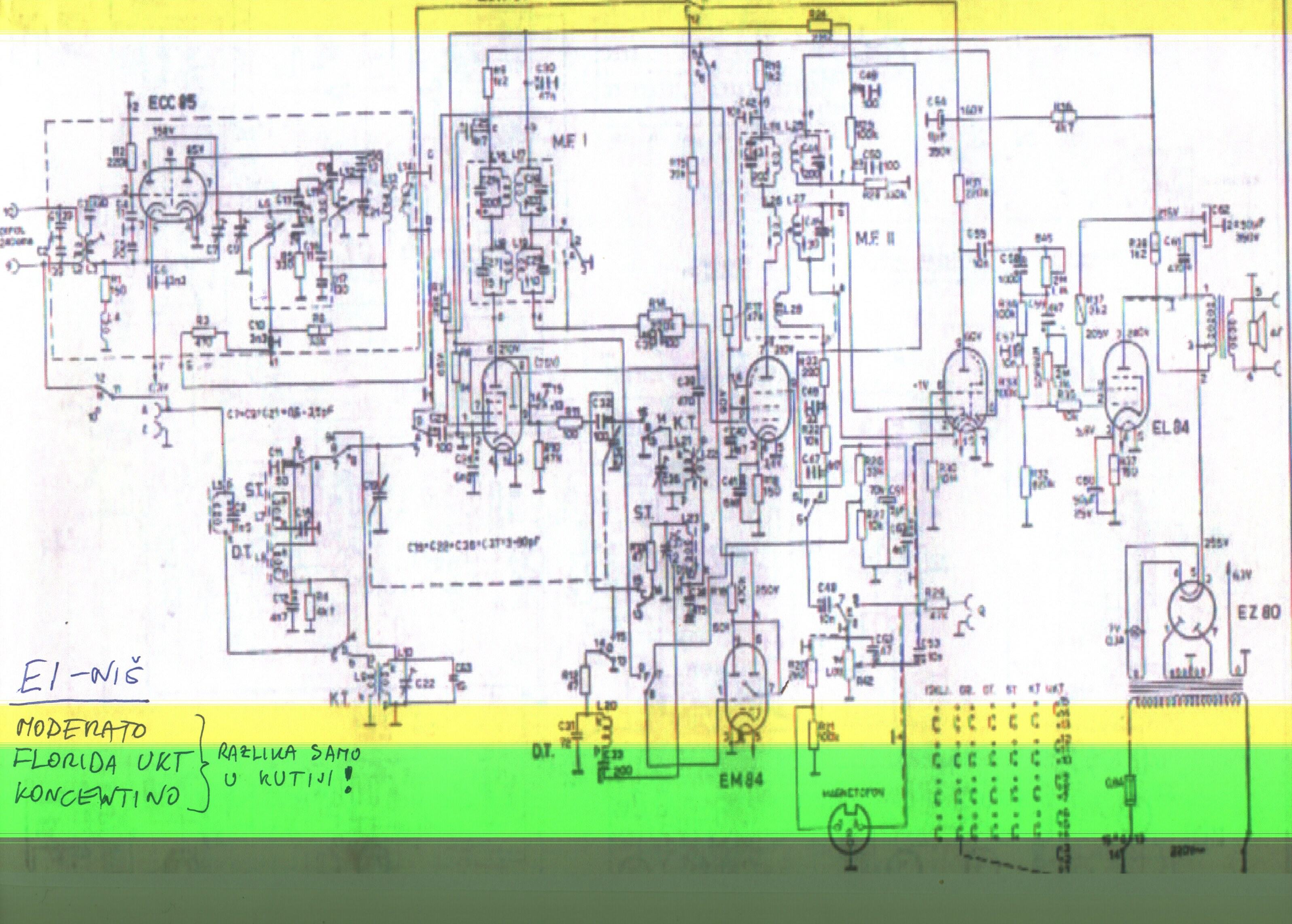

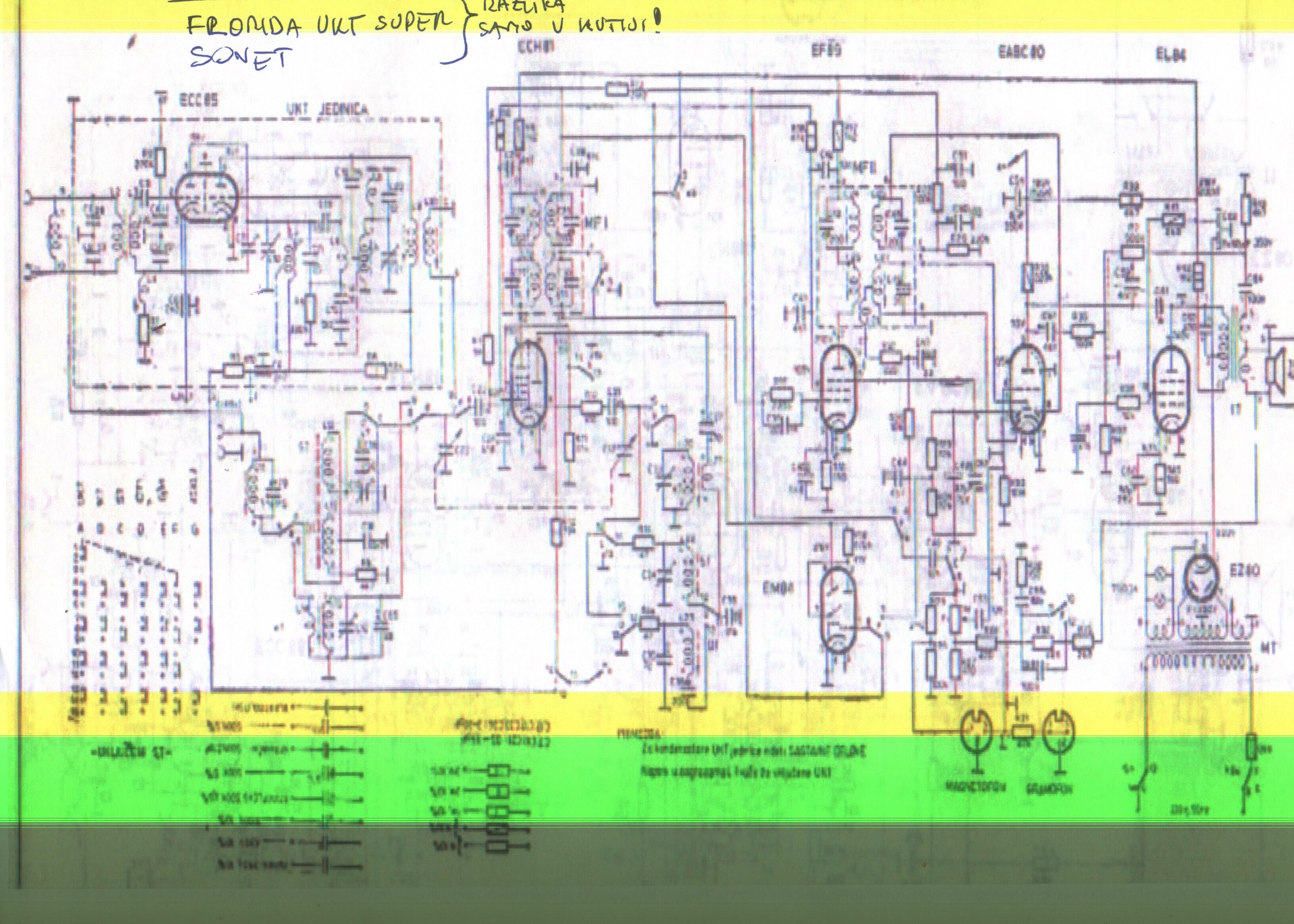

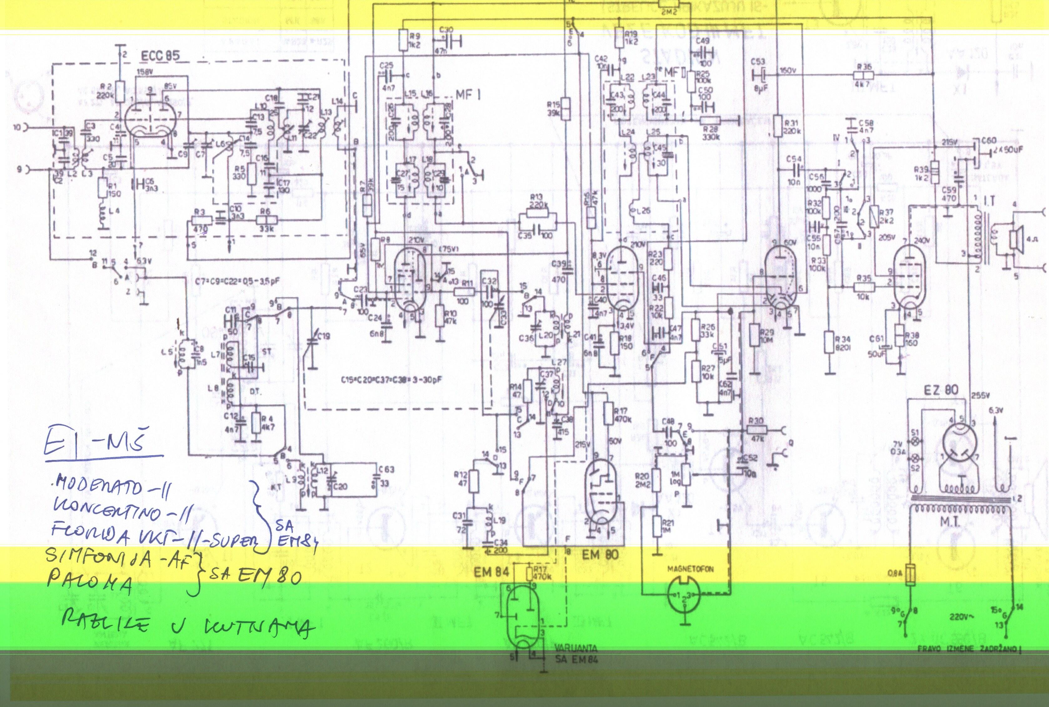

Schematics above are not exactly for "Florida Hi-Fi Super", but all are very close.
Joined 2009
Thanks very much Davorin - I'll take a good look. If the images you have are a bit clearer but were too large to post, can you PM-me and we'll work out a way for you to email them to me.
Edit: I just printed them out. Wow, it's a complicated circuit. There are symbols on there I don't recognize. I'm going to have to take my time. Heck, maybe it'll work first time I power it up.
Thanks again guys -
I'll let you know how it goes...
Thanks again guys -
