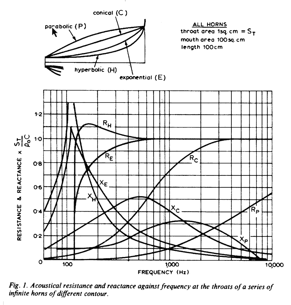

Parabolic horn is a new term
from Dinsdale (WW)

Parabolic is not really a valid and useful horn expansion, it's more a consequence of practical implementations of straight sided sections. Taken in the context of waveguiding versus horn loading might come to different conclusions, but broadly speaking a contour that turns inward (opposite of expansion or holding conical at the least) might create internal reflections (directly, as opposed to through diffractions).

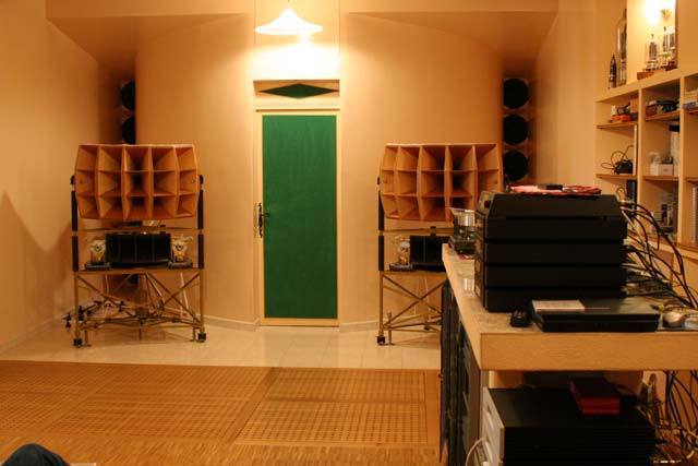

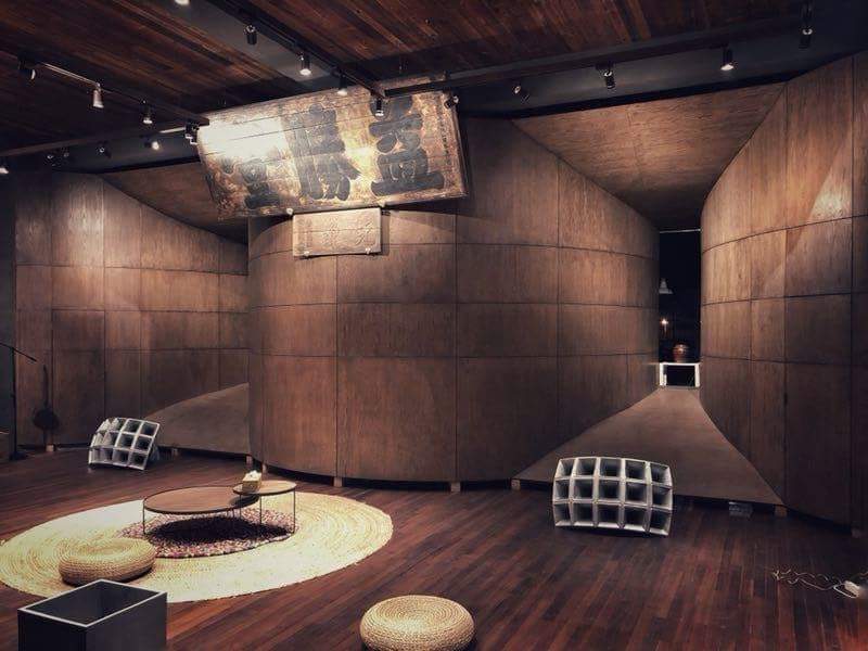

Can be, just look at the number of simple fold horns done here. 😉 Regardless, a typical room corner with one set of parallel walls is a parabolic expansion, so ideally need to factor it in regardless of whether the corner is horn, line array, etc., loading it.

Originally they were IIRC, but there's been what appears to be a whole room makeover. Also seems like there's a somewhat copy-cat system, which maybe has/had the originals.
A real shame that google now only shows us only a tiny fraction of the pictures of what I/presume we, search for or we could still see its changes and all the other big rigs posted around the world at least since '96 when I got online. The oriental [Japan, I presume] big built-in FLH 'sub' woofer with the W.E. 15s suspended in front with other W.E. 'fill' horns scattered around was my sentimental fave.
